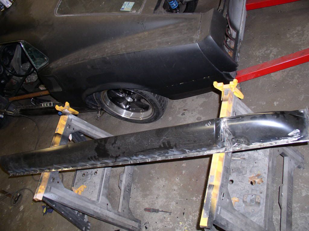

Weekend update 11/30. worked on the passenger side rocker and then i got a piece of molten metal in my left eye..had it removed today and all is good i had glasses on it must have got in there when i was using my plasma cutter....always wear good protective gear......here are some pics
The rockers are made up of three different parts welded together

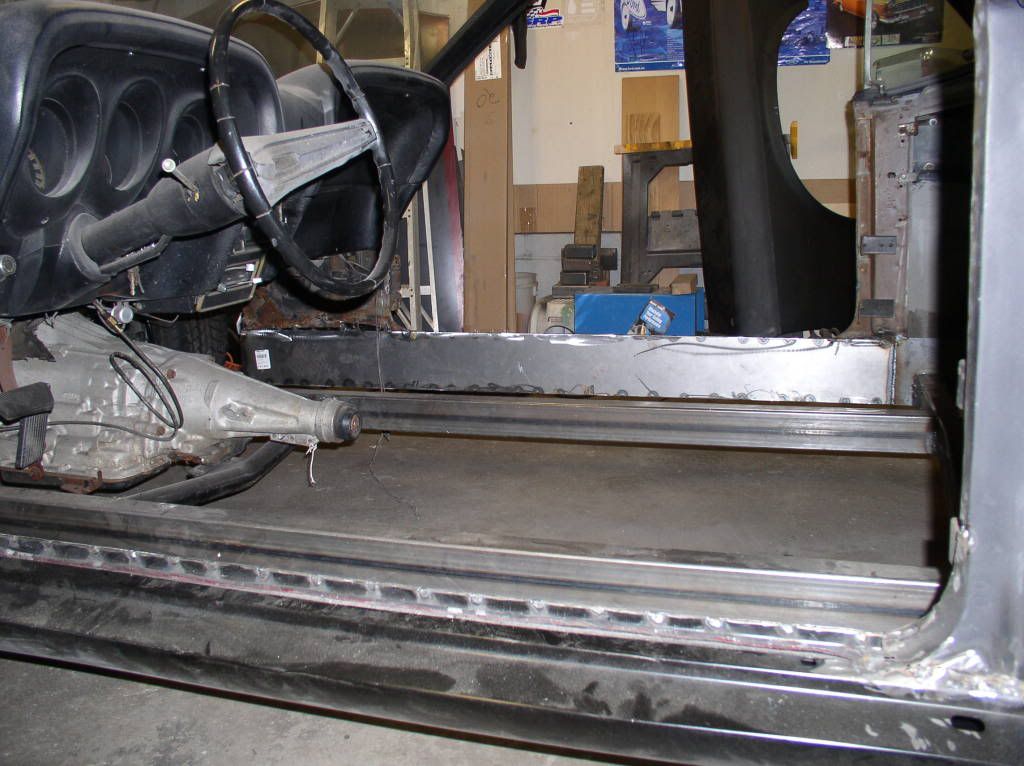

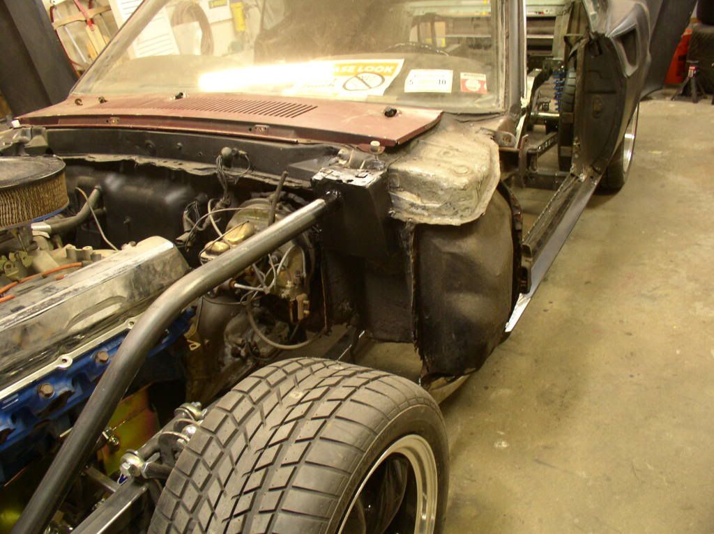

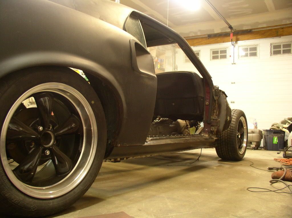

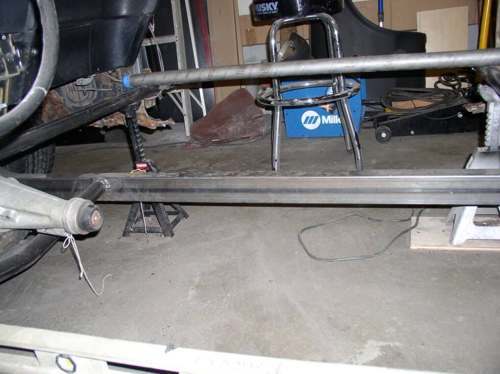

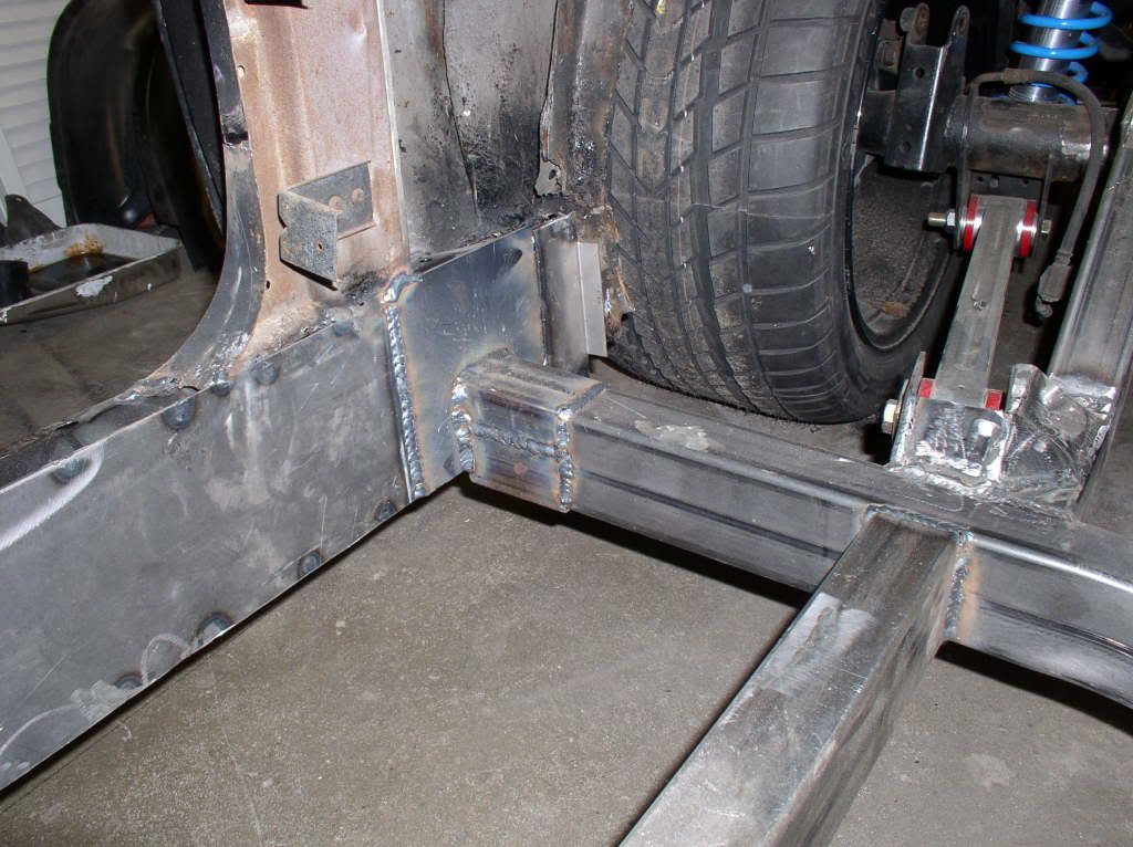

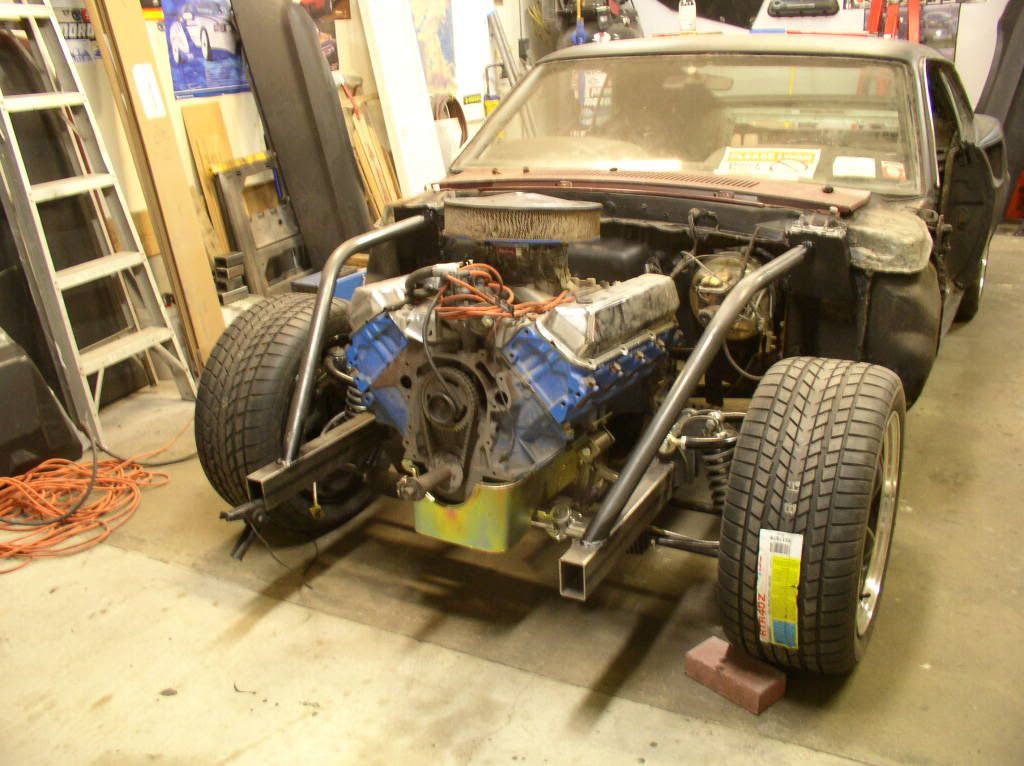

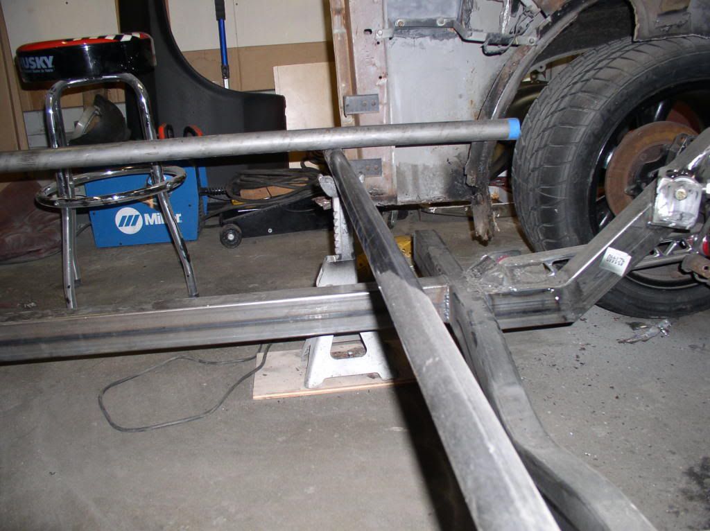

Ok eye was given clean bill of health now back onto the build ..12/7/08 update finally got the body mounted to the frame and now its a roller again ..first mounted the pass rocker then i fabbed up the dropped crossmember mounts ..1/8th plate and i cut up a piece of frame into 4 pieces and welded to the rockers for the rear..as for the front i made up some 1/8th plate mounts for the firewall so i could mount some roll bar to front frame ..at the moment this will support the front until i make the headers and exhaust then i will tie the frame to the rockers..anyway here are some progress pics....
pass rocker
frame crossmember mounted to rocker
front frame supports
