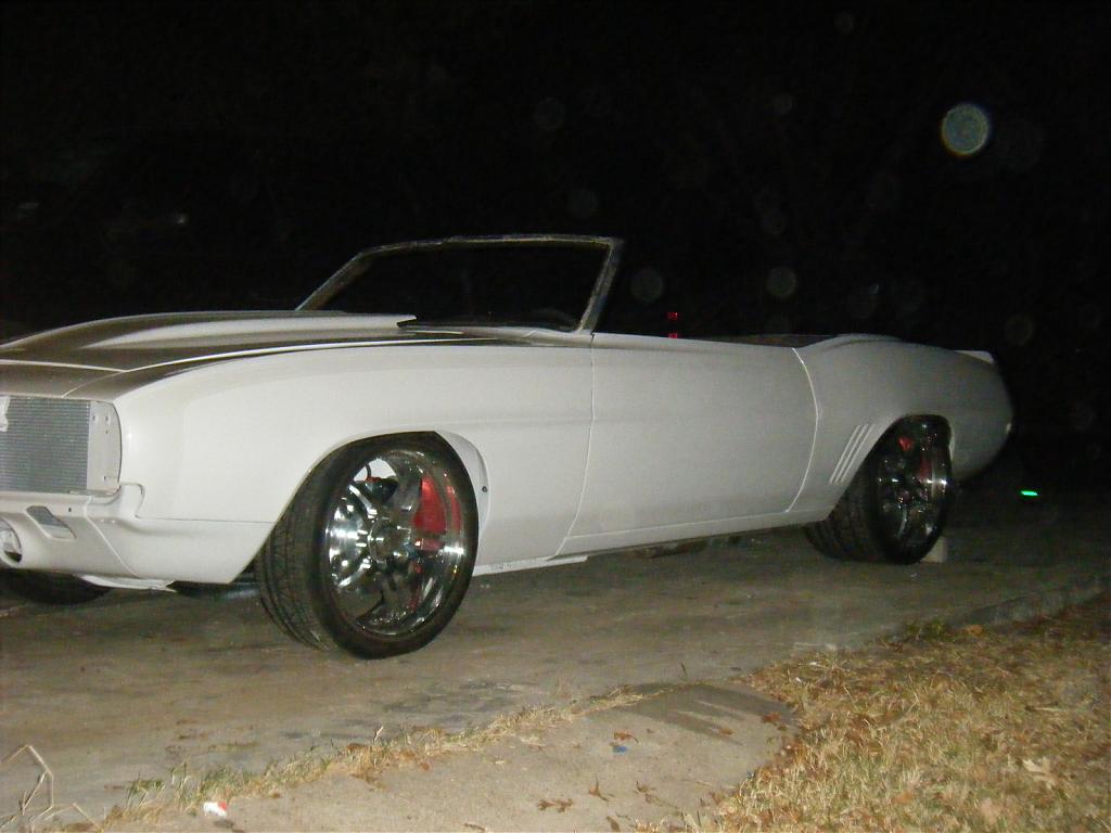

Old 12-03-2008, 07:21 PM
slammed con slammed con is offline
Join Date: Dec 2008
Location: san antonio texas
Posts: 24
Default c 6 wheels
i have a set on my mini tubed 69 with no spacers front or back
BUILT NOT PAY TO GET BUILT
