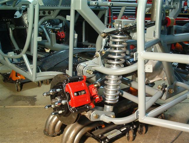

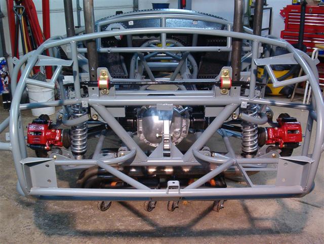

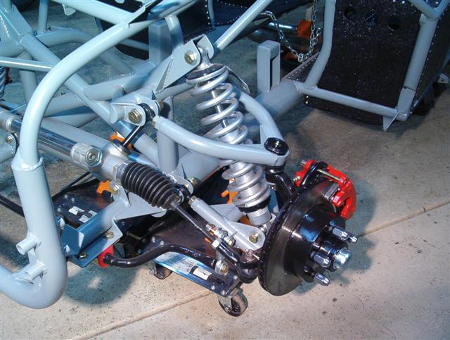

Default She's almost a Roller
Well, life is dealing me the same cards as always fair to crappy, we all know how much fun the center section was to deal with well I put that all behind me went to put it in the car and bam the damn thing hit the frame seems that interchangeable parts don't always interchange. that meant I had to surgically alter the frame after powder coat yuck! Well a day and more cutting grinding and welding later finally can say she's almost a roller.
Now I suppose I should go around and tighten all the bolts but I'll wait till I can get someone over here to hold the other end of the tape measure so I can square her up.
Patrick
http://www.clubcobra.com/photopost/s...0&ppuser=23754
