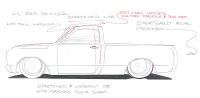

just wanted to say that jason talked me into the name of RS/C10 (which i like) so thats why the name is diff. ill post one of jasons drawlings that indicates where the body mods will be.the different color ink shows the changes. im waiting for my cab to come back from the sand blaster so i can start cutting up this nearly rust free cab. bill
