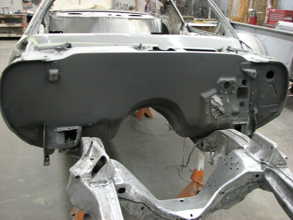

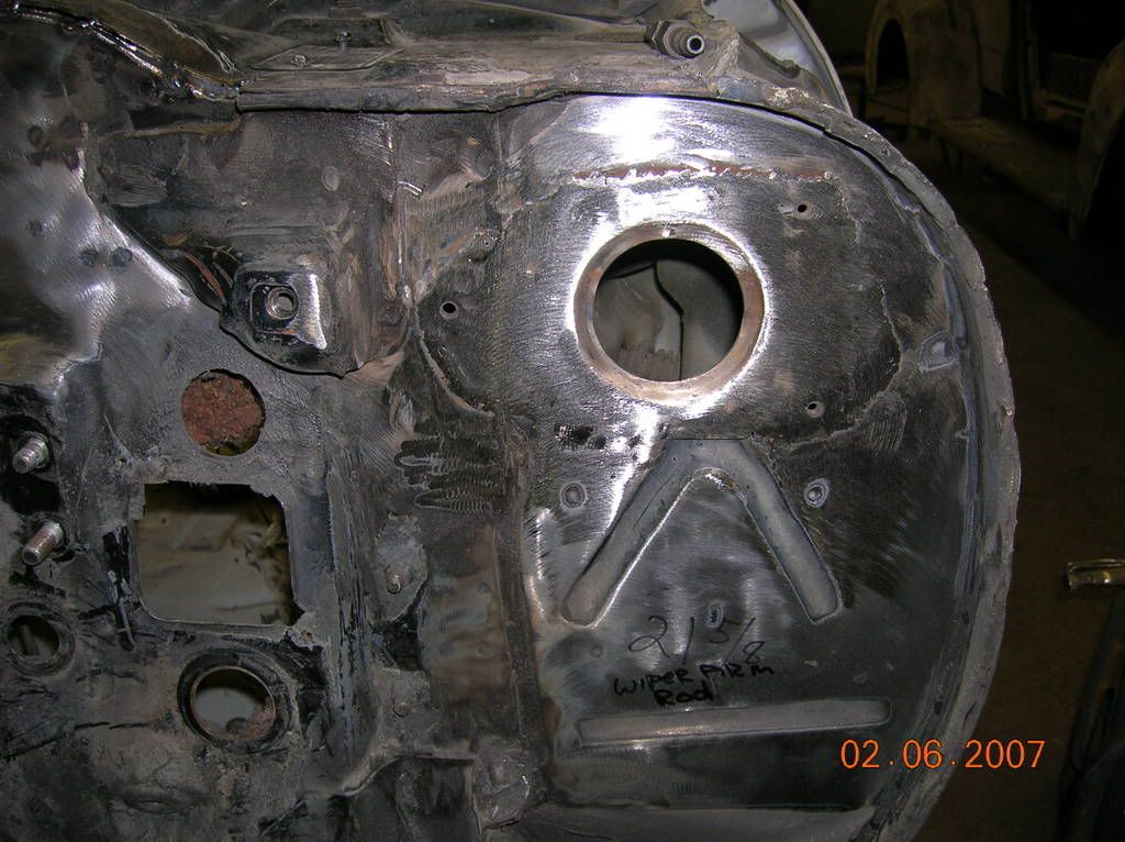

Well, I took a different approach. I did not want to see the wiper motor at all, so I cut it out and moved it under the DS fender.
And done:
Also to do this you will have to lengthen the rod that connects to the wiper motor.
