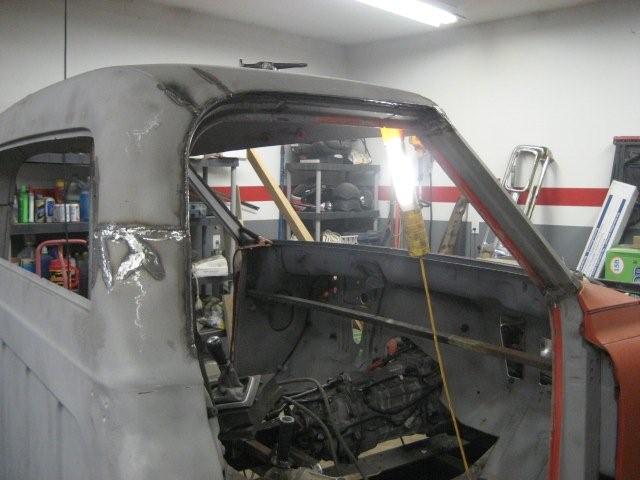

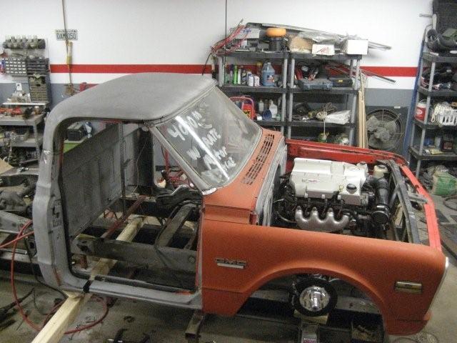

Man that's quite the project! What does this do to the windshield? Do you have to have a custom one made? Keep up the good work!!

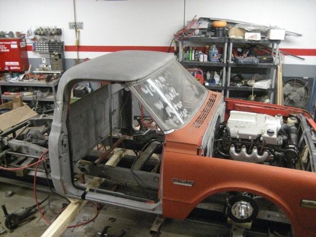

Are you going to stretch the cab/doors to close the gap created or ? ? ????
  #37
Old 01-02-2009, 06:48 PM
bill amsley's Avatar
bill amsley bill amsley is offline
Join Date: Feb 2008
Location: chambersburg pa
Posts: 229

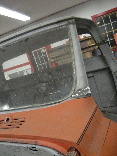

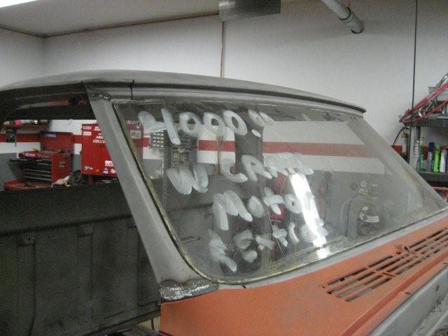

Thumbs up thanks jason rushforth
just wanted to than jason rushforth for this design. he was right on the money. he had the idea for laying the windsheild back and told me the stock windsheild would work ,and he was right. when i set the glass in ,and it fit, i thought "he actually saved me time and money".the last time i cut up a cab it cost a small fortune in the cost of the windsheild. thanks jason
bill
ps yes ,im stretching the doors to fit the opening.

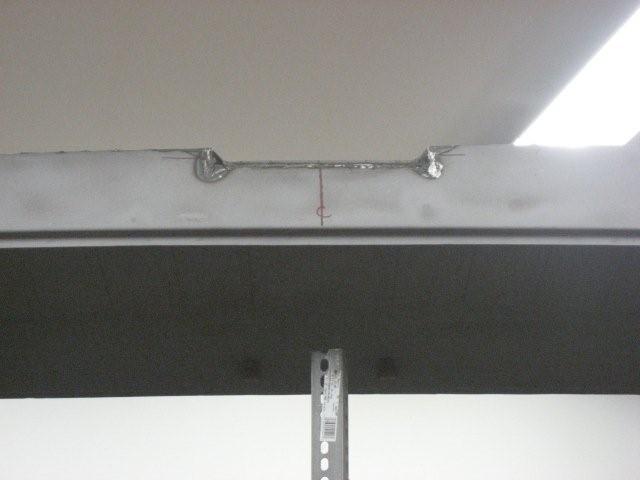

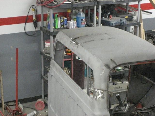

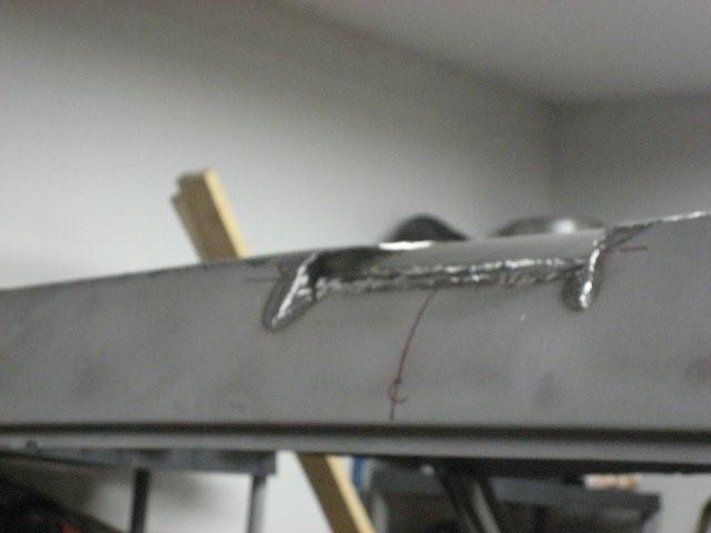

Cool

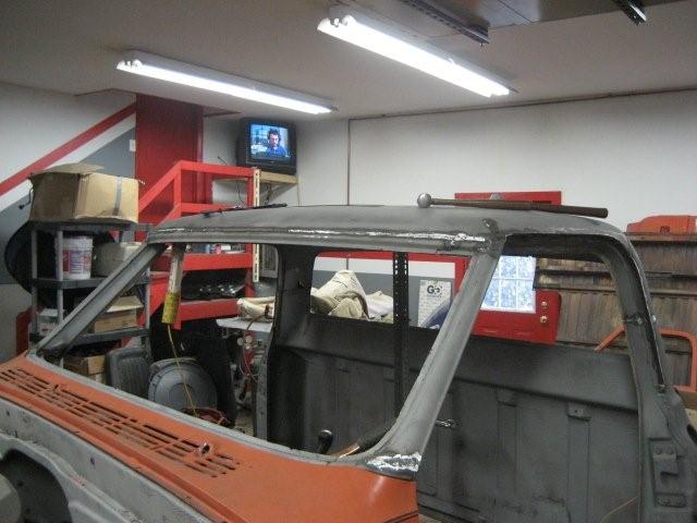

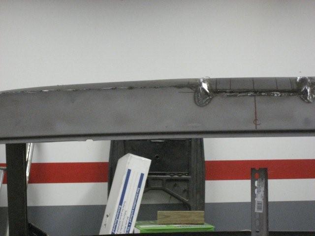

few more metal pics.i got the drip rail removed and welded,it really cleaned up the roof but took the best part of the weekend. i also cut a small recess in the back of the roof . im not sure i like the recess ,if it dosent grow on me ill change it up. bill
