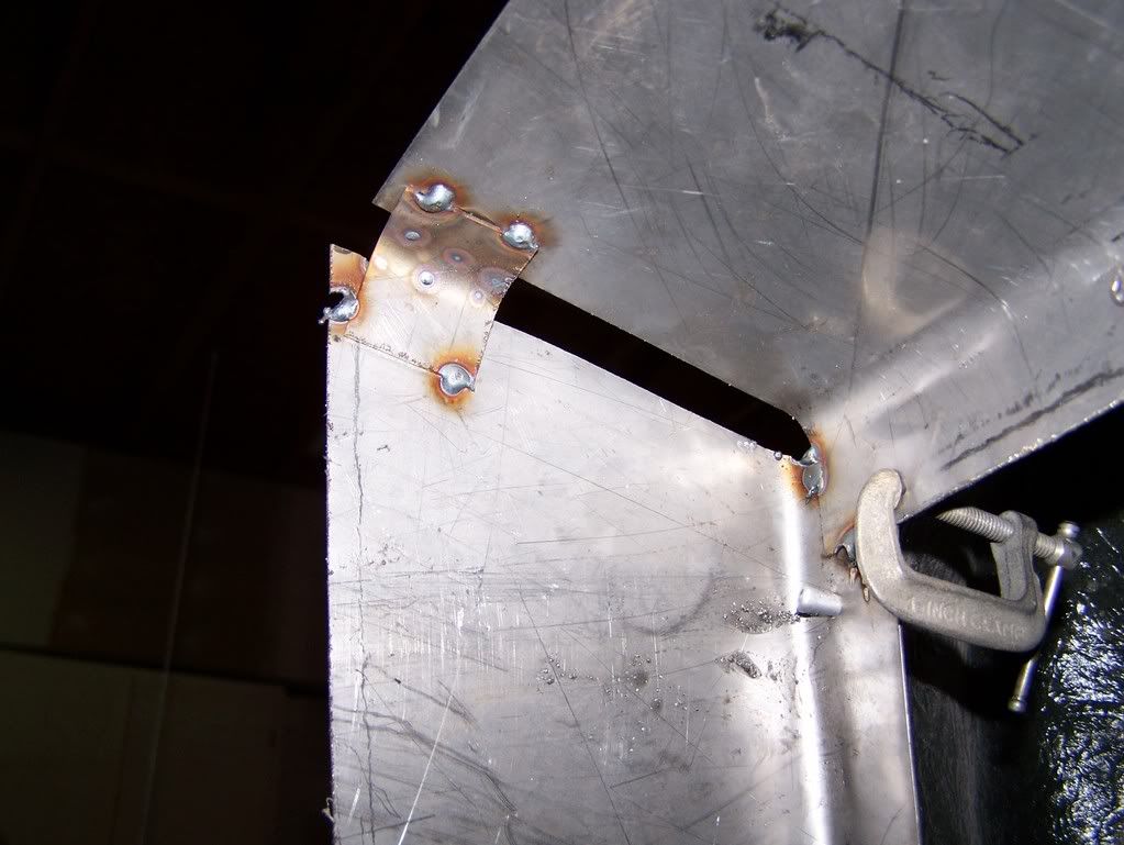

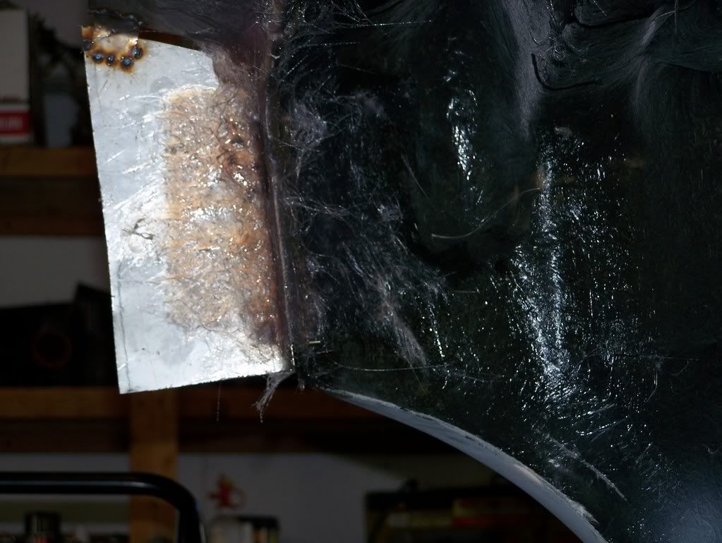

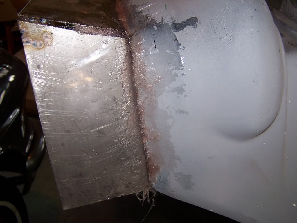

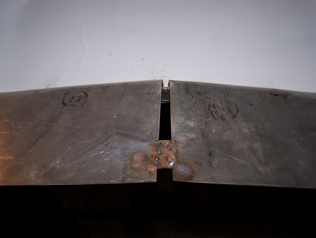

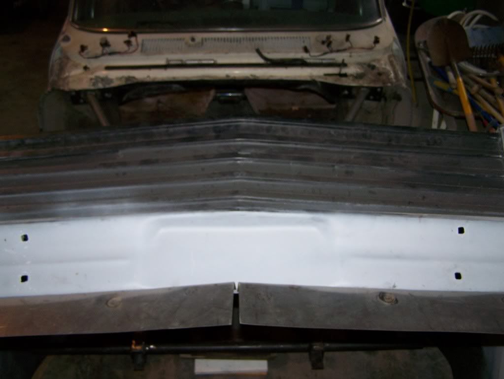

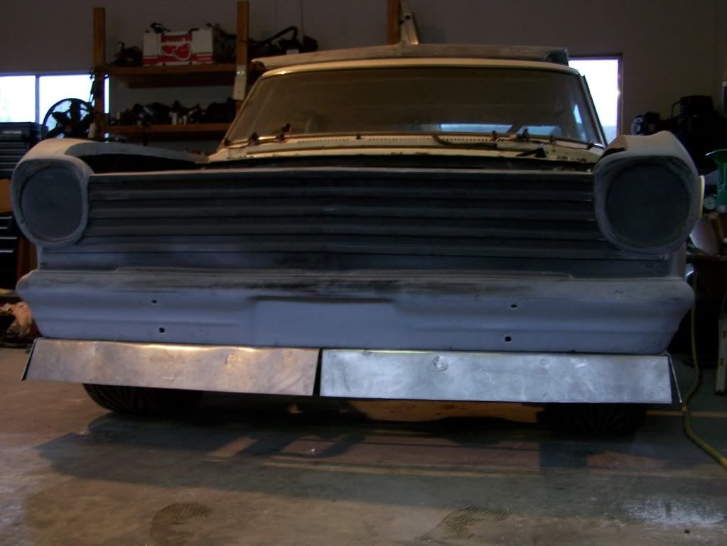

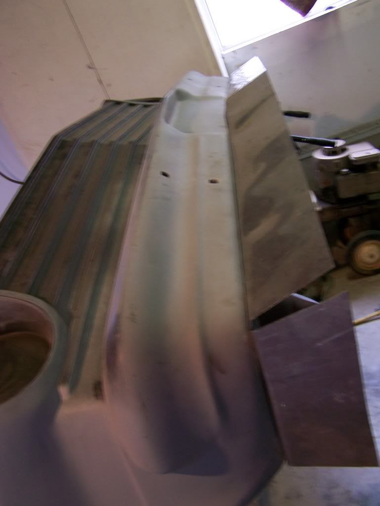

I've got about 80 hours into this lip now and I'm still not finished filling in some low spots or priming it.
Sorry about some of the blurry pics(camera battery was dieing that day)

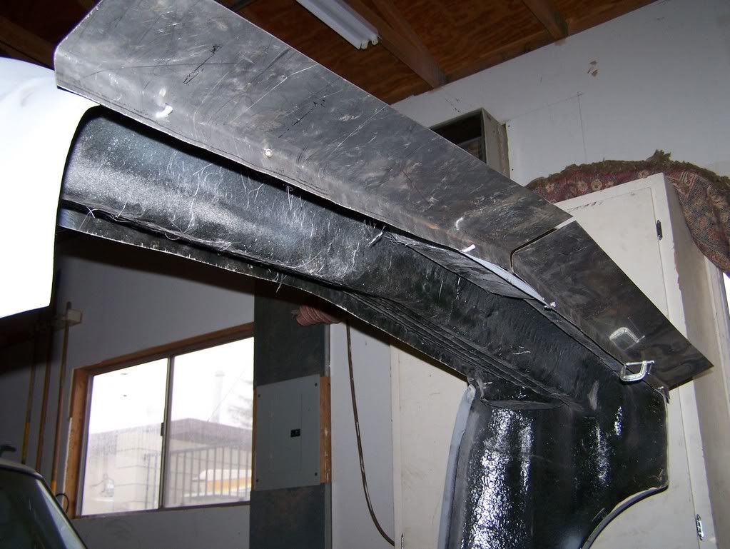

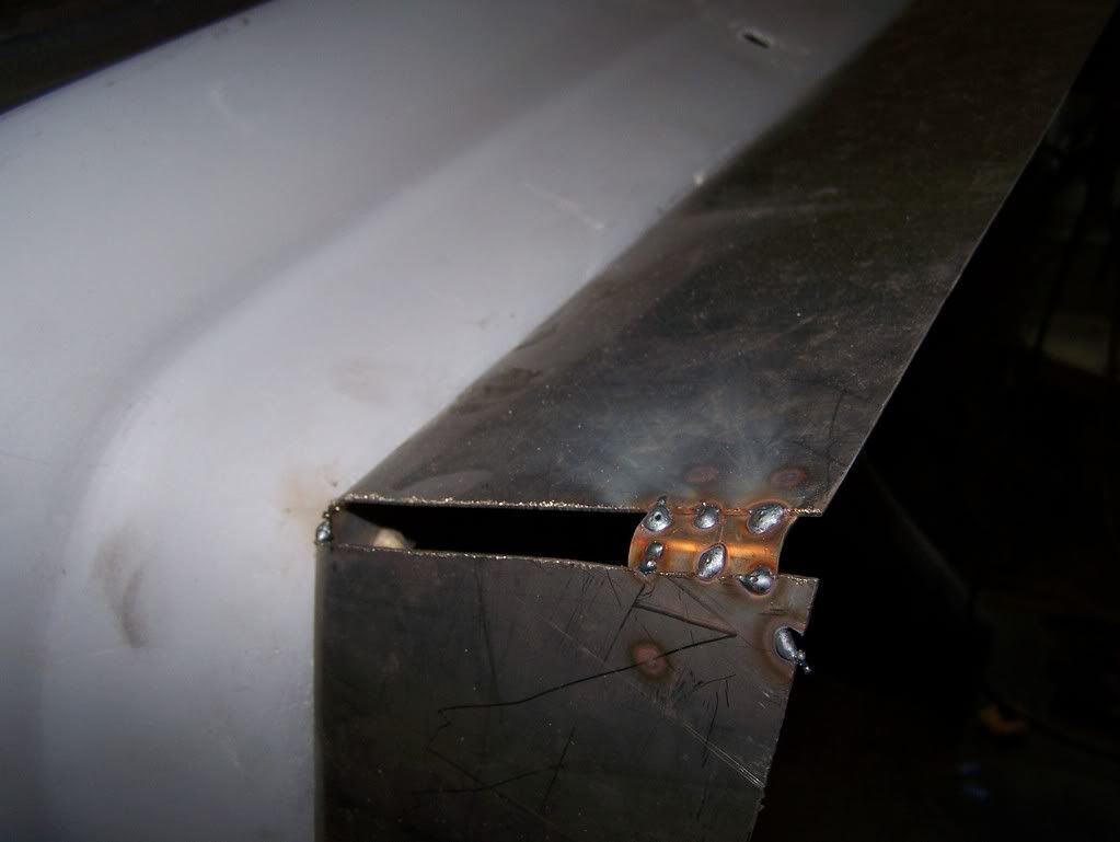

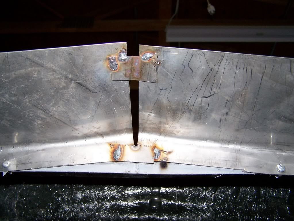

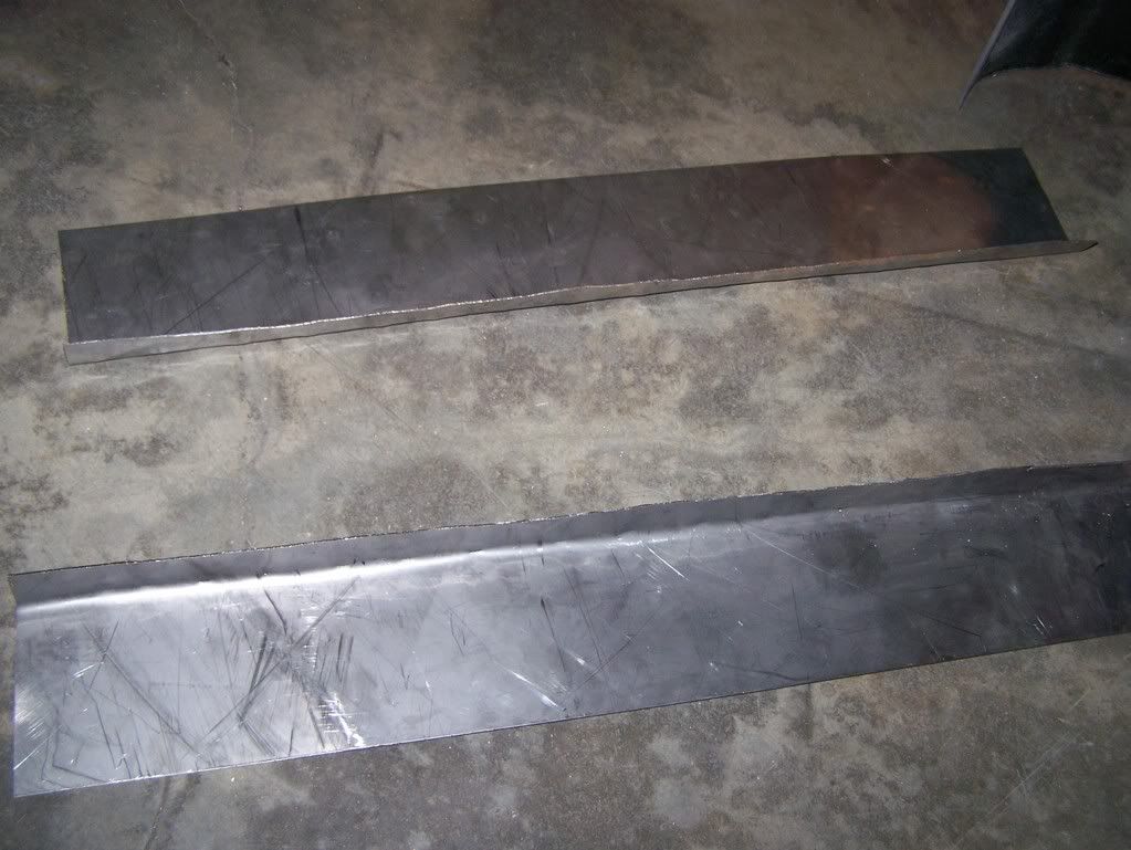

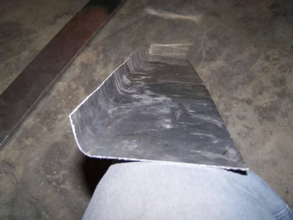

I took some 18 gauge 304 stainless and made four pieces, two for the front and one for each side. I left some gaps on the side pieces so I could round the edges to match the bumper. I'll lay the fiberglass on real thick so it can with stand a lot of abuse.
I rolled the edge to give me a surface to attach to the lower portion of the bumper.
Getting everything centered before throwing some rivets to hold it in place.
I ended up using bolts because the rivets I had were to long.

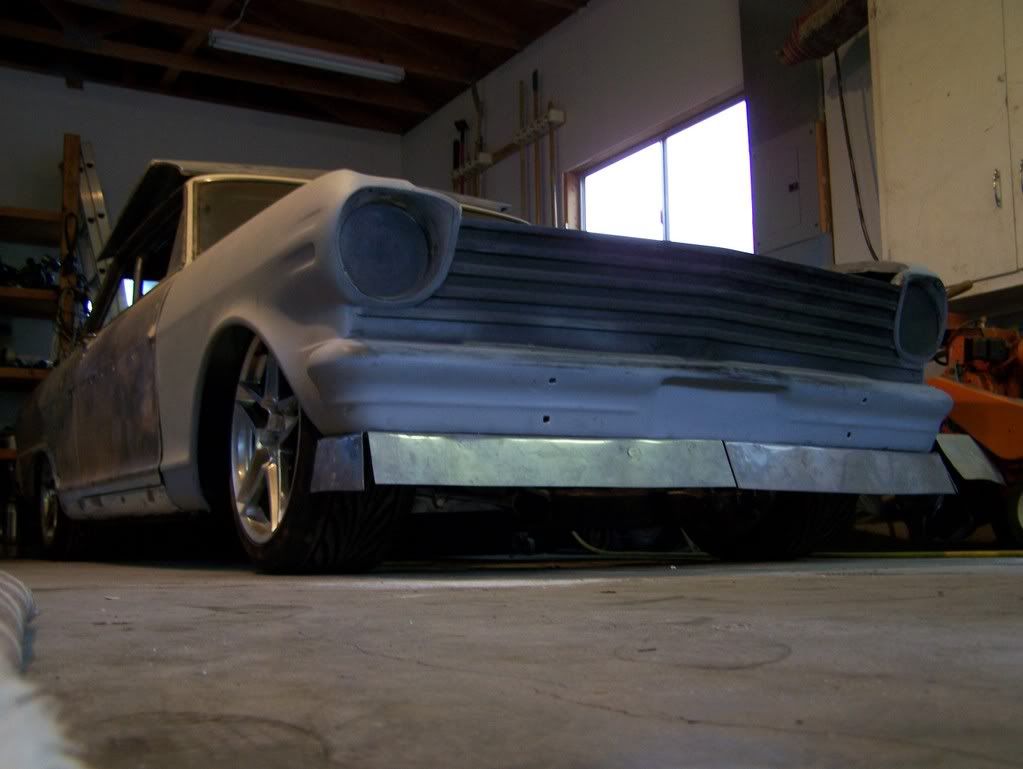

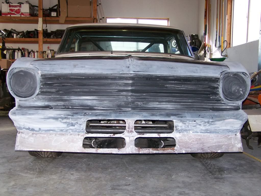

Basic overview before the fiberglass begins

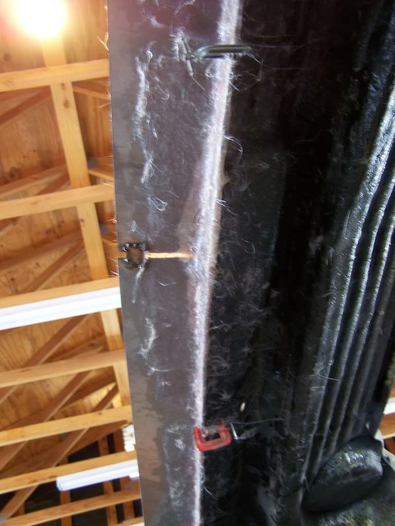

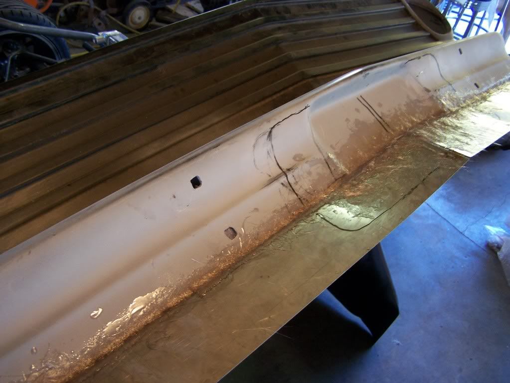

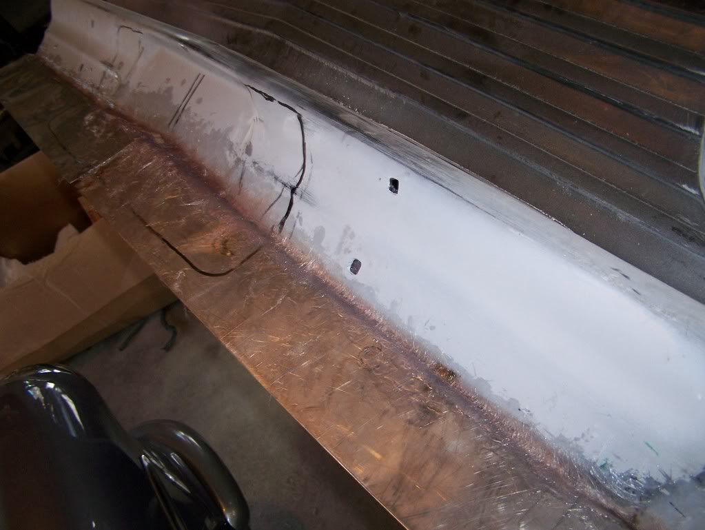

*adding some bracing

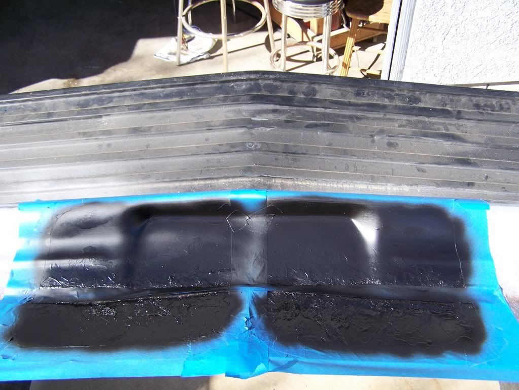

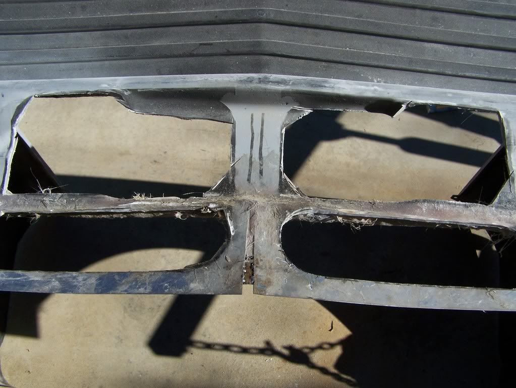

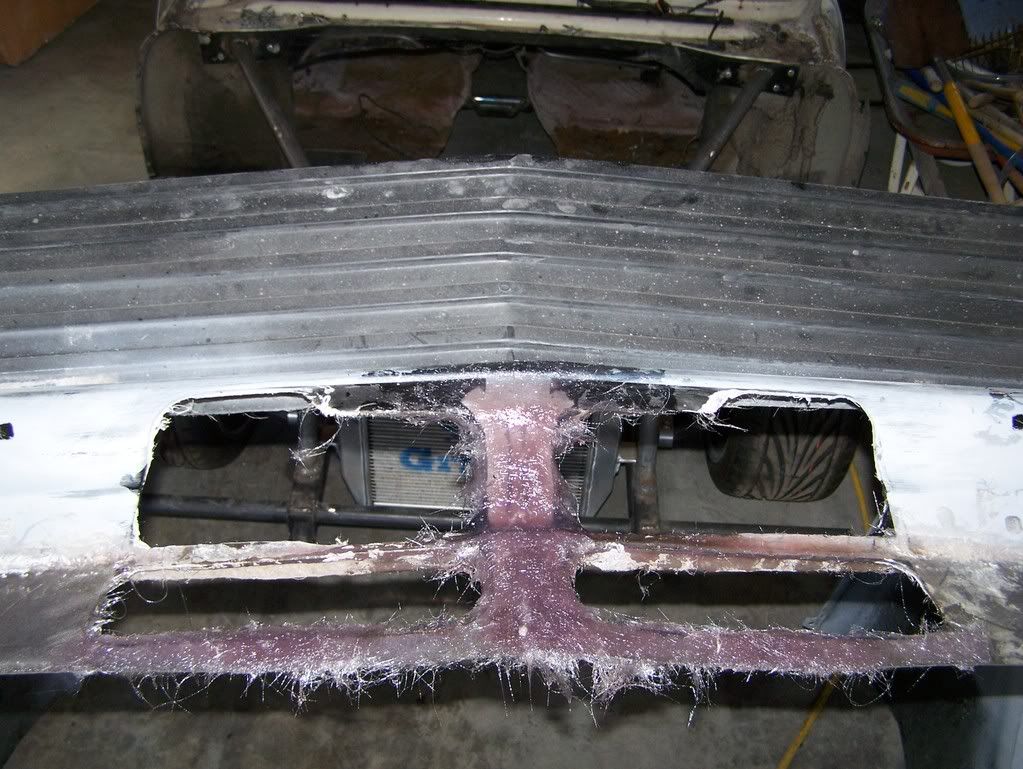

& the messy part begins.
My brother drawing in the air inlet design

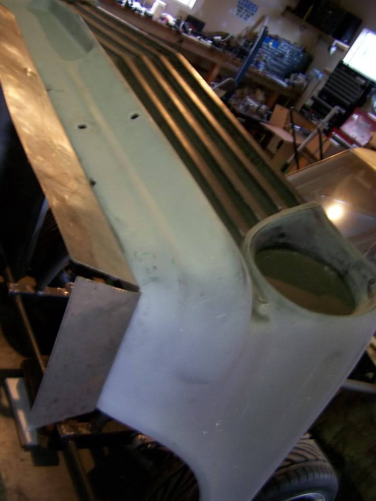

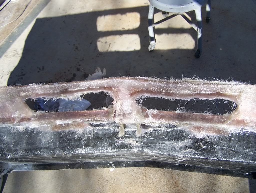

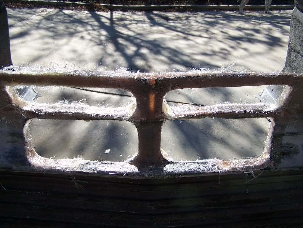

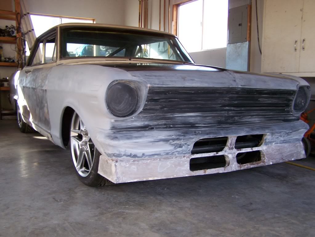

*taped off the area he drew and spray painted the inside
*almost done opening up the holes
I went a little crazy with the fiberglass but I wanted this thing VERY strong.

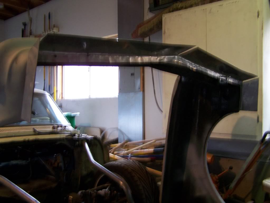

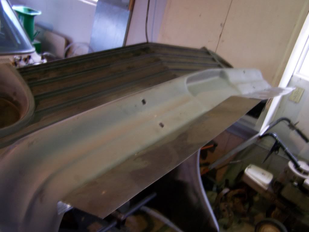

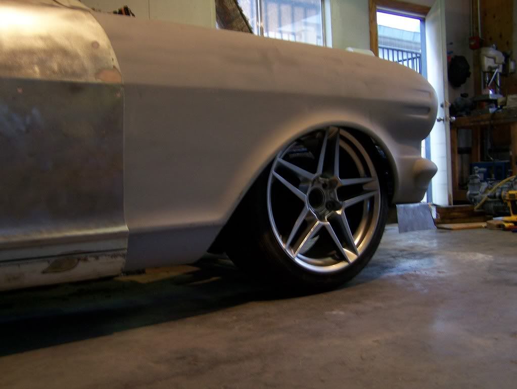

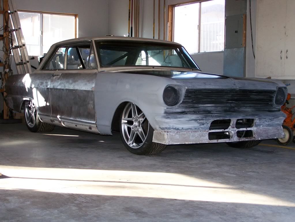

Here is how it looks today.

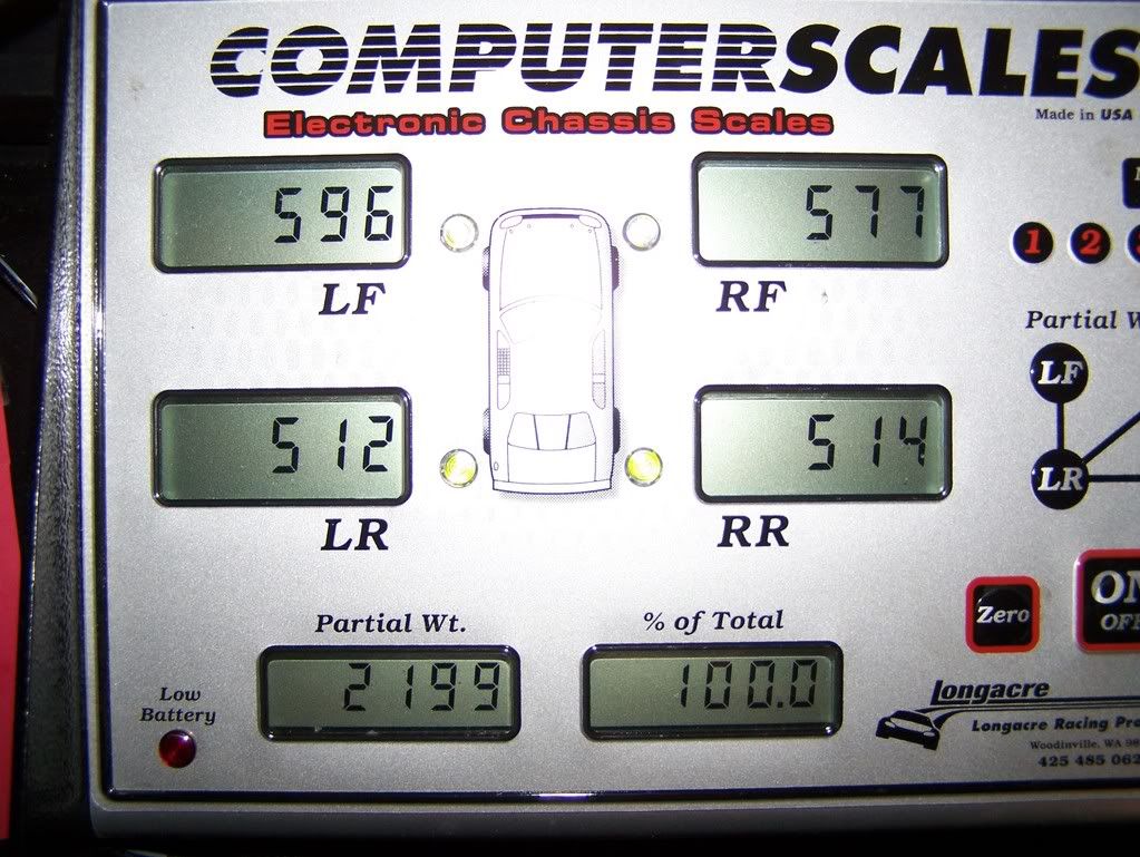

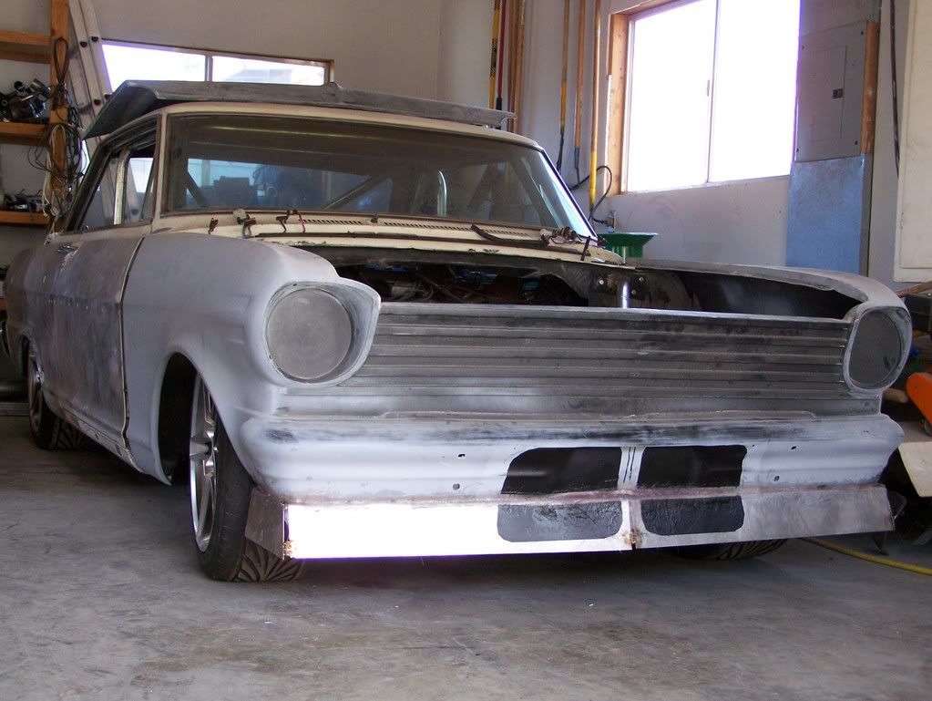

Curiousity has been getting the better of me lately so I borrowed the big boss mans scales.
