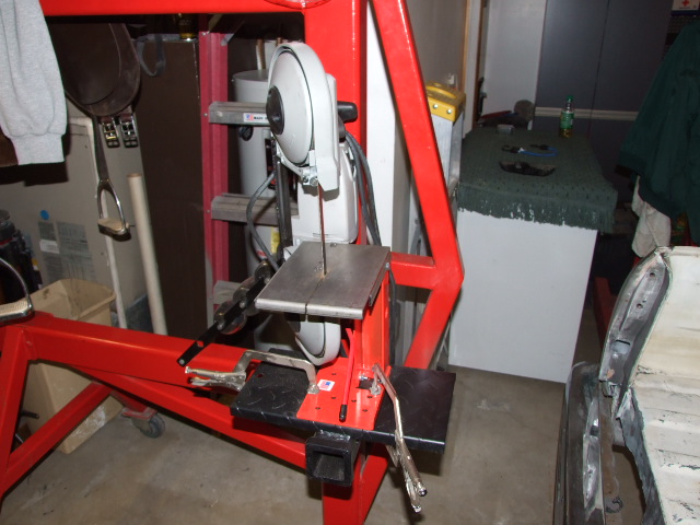

I stopped at a nearby metal workers shop recently and he showed me a stand that turns a portable bandsaw into a small bench mounted saw. I ordered one of e-bay and it works great. I used it to cut the plates to put the ls1 in the el camino among many other things around the shop.

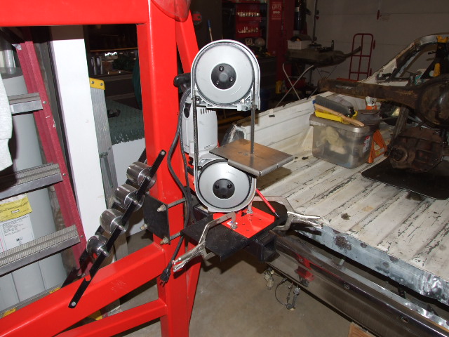

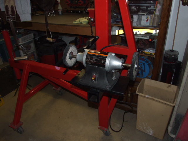

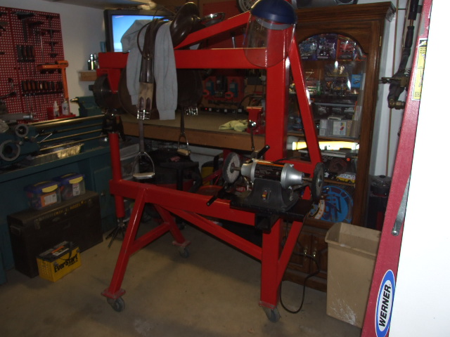

Since space always seems to becoming limited I was looking for a way to get more room and I mounted it to the back of my english wheel. I took the bolt on hitch mount from my travel trailer and purchased a hitch extender with step from Harbor Freight and it makes a great stand for the bench mounted tools.
Robert
