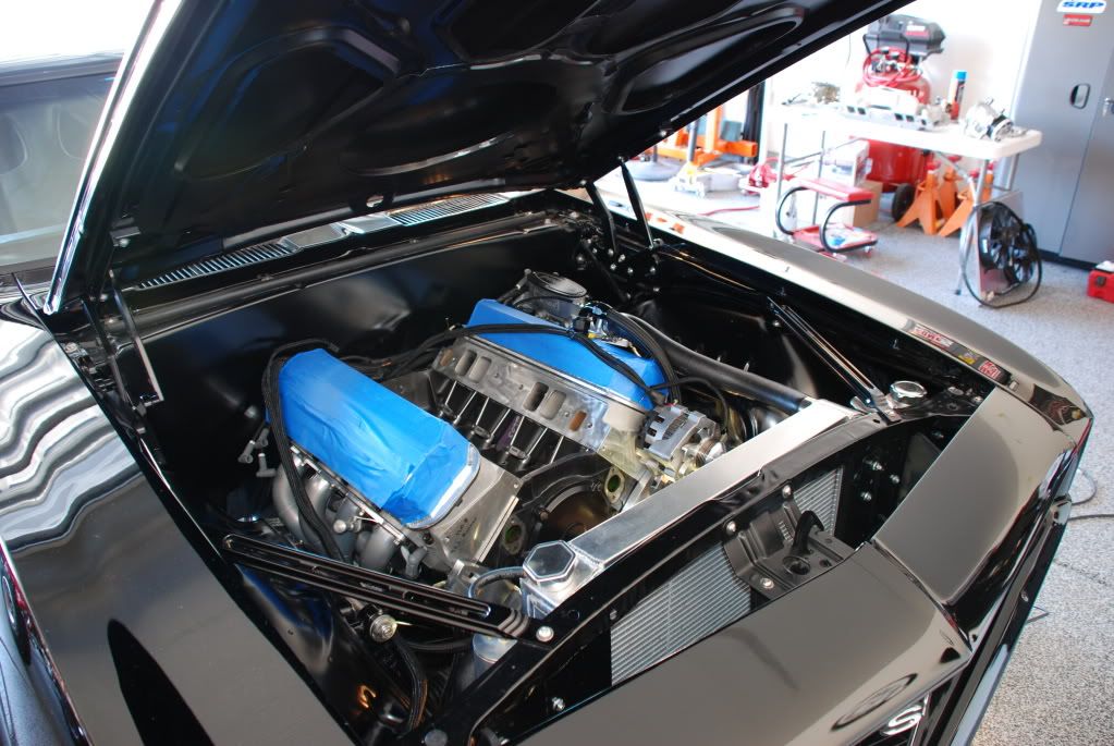

Lately I noticed a little coolant on the front of the engine. Never enough to leave anthing on the ground. I traced it to the water pump weep hole. 2000 miles on my Edelbrock Victor Jr. water pump and it's starting to drip here and there. They won't warranty it since it's over a year. So I pressure checked the system in an attemp to make it leak and found a nice little surprise. The front drivers side water port on the intake also had an external leak at 12psi. Should have it back together this weekend. I love this stuff anyway.
