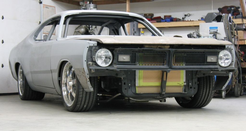

TJ (Bruning)took some cool pics showing how her stance looks.......not bad for a coilover car with nearly 5" of ground clearance

Nice stance what coil over are you using.

The front suspension kit (alterKtion) came with QA1's and AFCO coils, but I will probably change those out before paint. We cut up the AlterK frame and moved it up into the frame for better ground clearance. I havent decided on which brand I am gonna use for the front/rear (have Varishocks mocked up in back)_.

what size are the wheels and tires

8" 255/35/18
12" 345/30/19

Gotta love them Mopars. You can shove a ton of rubber under them. My buddy races a Dart that has stock suspension but the leafs are moved in and he can easily run a 12" slick under it. You have an awesome looking Mopar. Keep us up to date.
