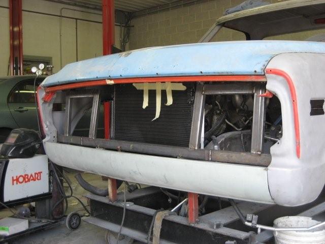

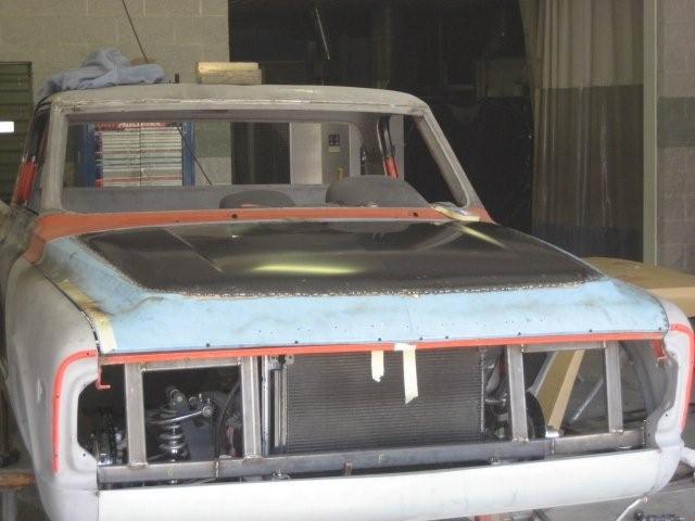

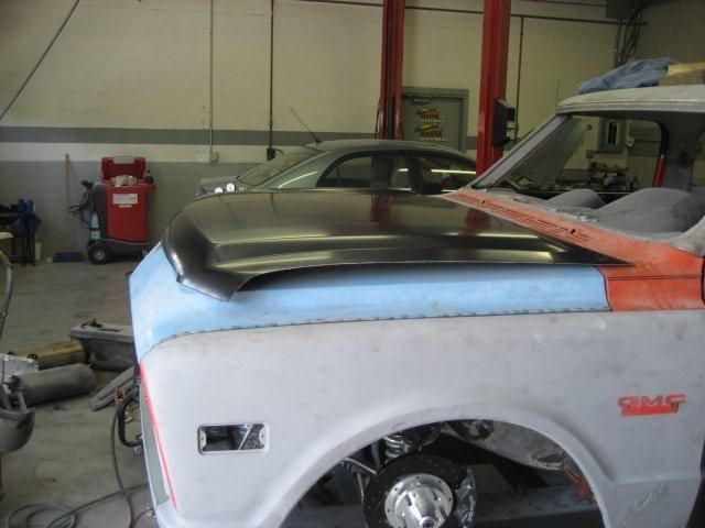

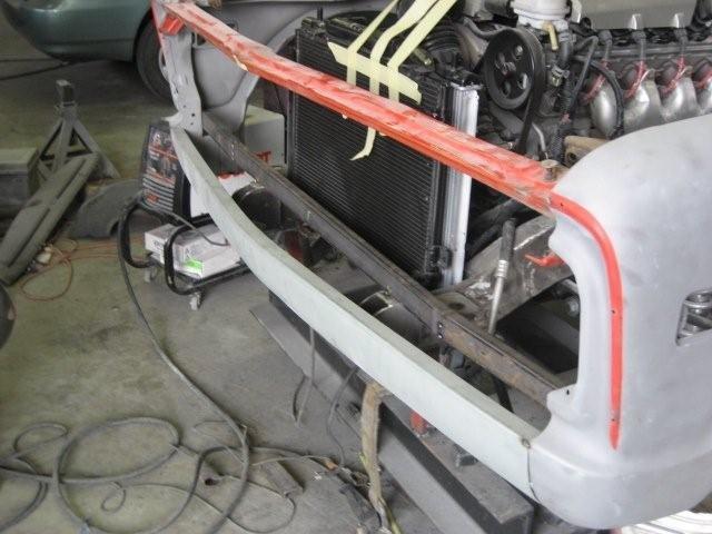

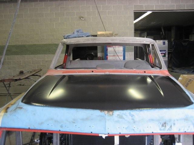

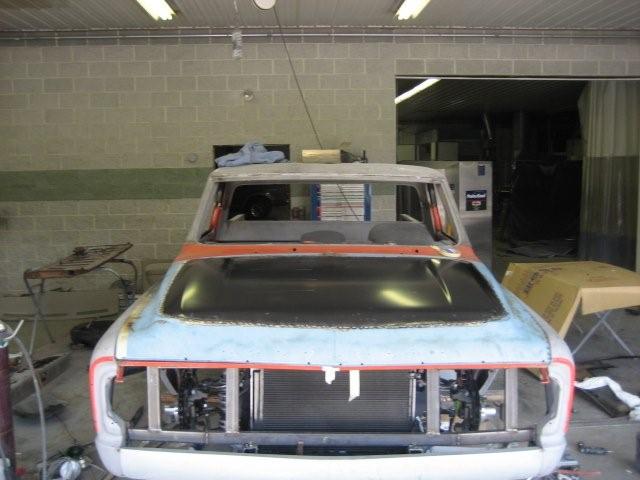

few pics,starting to work on tne front end. had to make a rad support because ive made so many changes .the rad & cond are low in the frame to keep room for the intake work. i used a hood from a 07 tahoe and skinned it,i had to glue it and use pillar foam to keep the tissue paper like skin from warping then tacked it in place till the glue sets up. thanks for checking in bill
