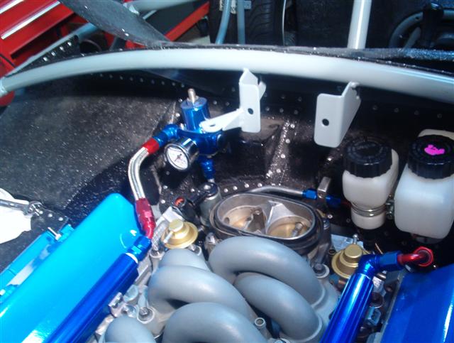

Did some plumbing work have some small things to show.
Or Just how much S#*T can you fit in a three pound bag.

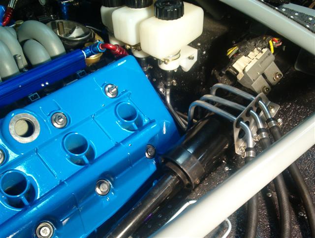

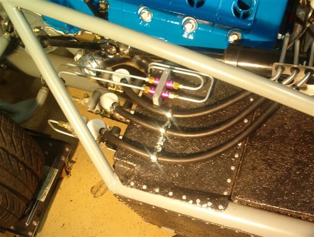

finished the fuel system
Plumbed in the brake and clutch reservoirs
This is where the three pound bag really starts to stretch there is just not a lot of room left here, took a bit of creative thinking to get around this one.

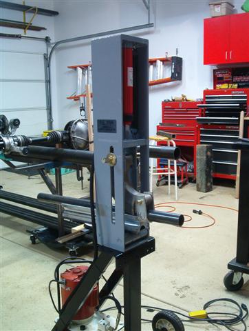

Drop dead sexy! It's almost a shame to hid all that detail work under the fiberglass body. Fantastic job. One question I haven't seen anyone ask... What did you use to bend all the DOM?
Keep up the great work.
  #154
Old 06-09-2009, 06:15 PM
fasterpatrick's Avatar
fasterpatrick fasterpatrick is offline
Join Date: Oct 2008
Posts: 154
With a tubing bender, actually two of them one is a Midamerican racing ez-bend 90, the other is a roll bender that I fabbed up with left overs from a old pipe bending rig.
Hope that helps.

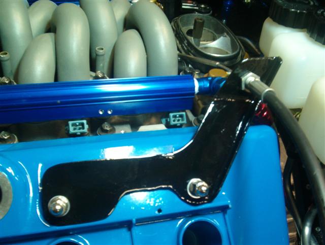

How not to install a clutch slave, I never fabricated this during mock up, bad idea and I payed for it big time. No fun laying under the car making measurements for parts and drilling holes with no extra space.

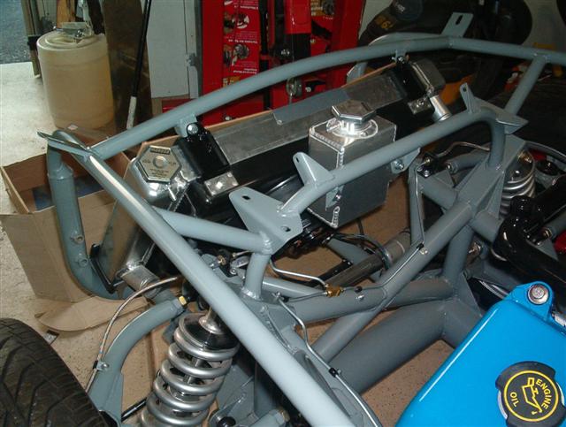

Last but not least Put the expansion tank and radiator / fan assembly in the car.
Now to get around to plumbing the coolant system and bleeding the hydraulics. We're getting closer.

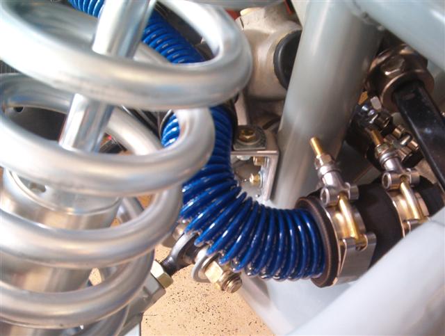

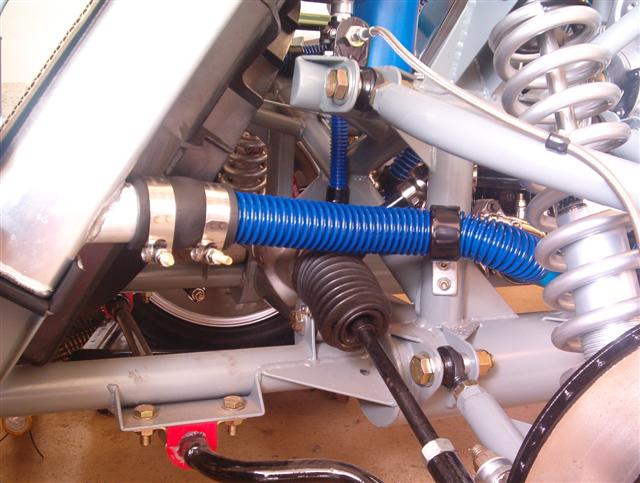

Default Cooling nightmare
Now It would go with out saying that one of the more difficult systems to get working in one of these cars is the cooling system, now toss in the nightmare of the ford DOHC and you have created a monster. I hope this works, I picked up a few of those corrugated stainless hose things, they were on super mega sale. There was just no way to find all the hoses to fit this nightmare so I used them to build what I hope will work. I took it upon myself to toss the covers and cheesy hose clamps aside and bought some good ones from work. Please let me know what you think of this tubing job do you think it will work.
Cont....
