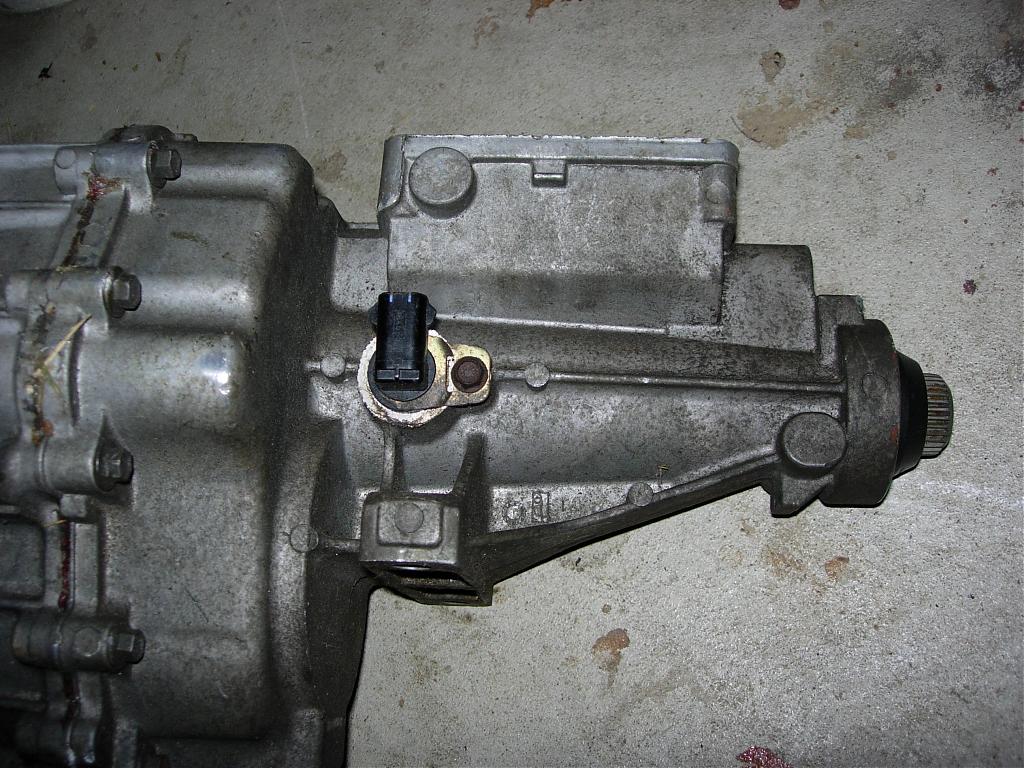

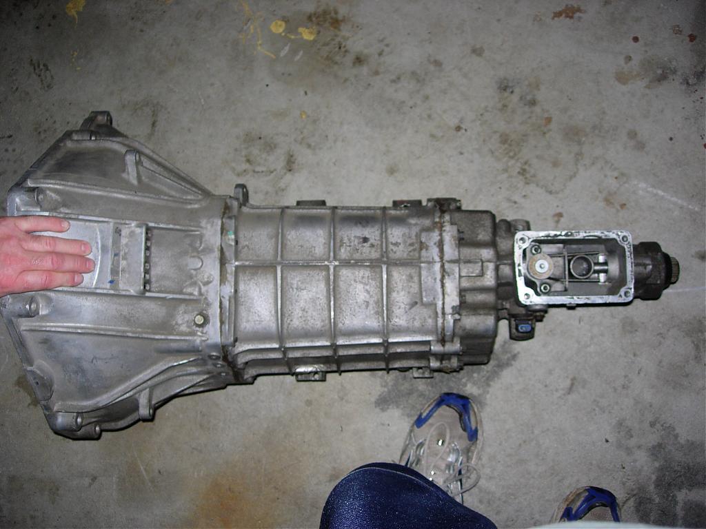

pics of trans to id

I have other angles / views let me know if other pics are necessary
Thx

Looks like a TR-3650. Take a look here for a picture: http://www.smartpartsauto.com/manual...0_mustang.html
