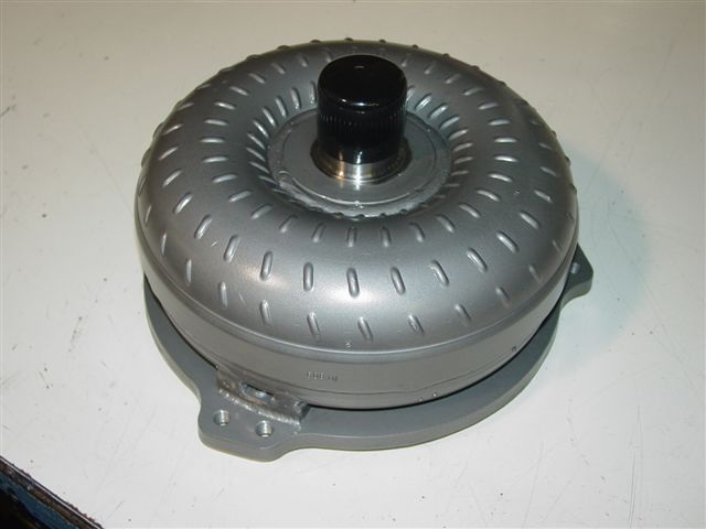

9.5 inch 2800 stall lockup torque converter with anti balloon hub... the special clutch in this converter has more surface area than even thier larger 298MM converter and a special heavy duty dampener with hardened splines. The converter features Torrington bearings and a heavy duty sprag, full furnace brazing and tig reinforced fins, anti ballooning plate and hardened turbine splines. These are custom built to your specifications and fully computer balanced. A very strong and reliable converter that gives you incredible acceleration potential and still retains the converter clutch for easy, low heat highway cruising.

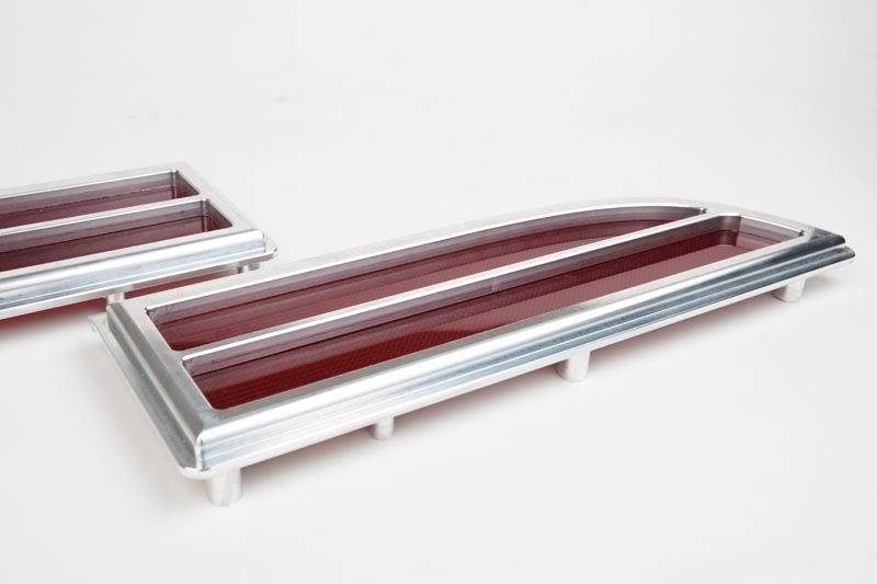

Originally Posted by fesler View Post
Here you go Ty, some more stuff coming but wanted to show these off.
These will be available in all the new finishes and when we get these back from Anodizing we will post them up for you.
WOW!!! NICE!!!
