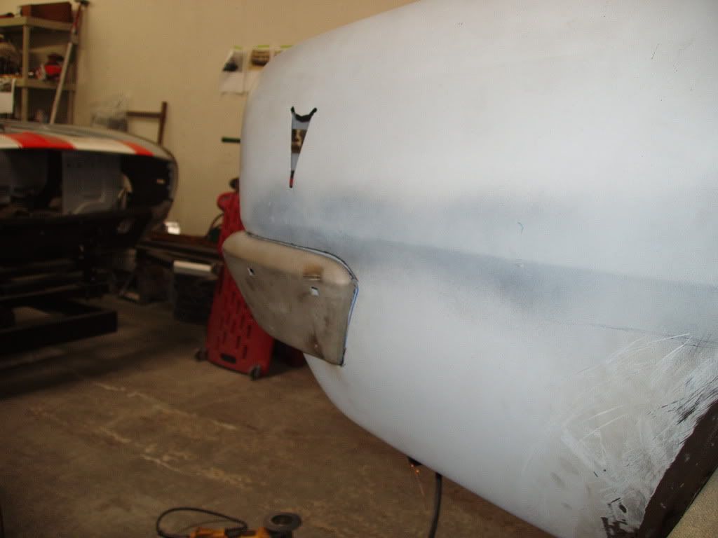

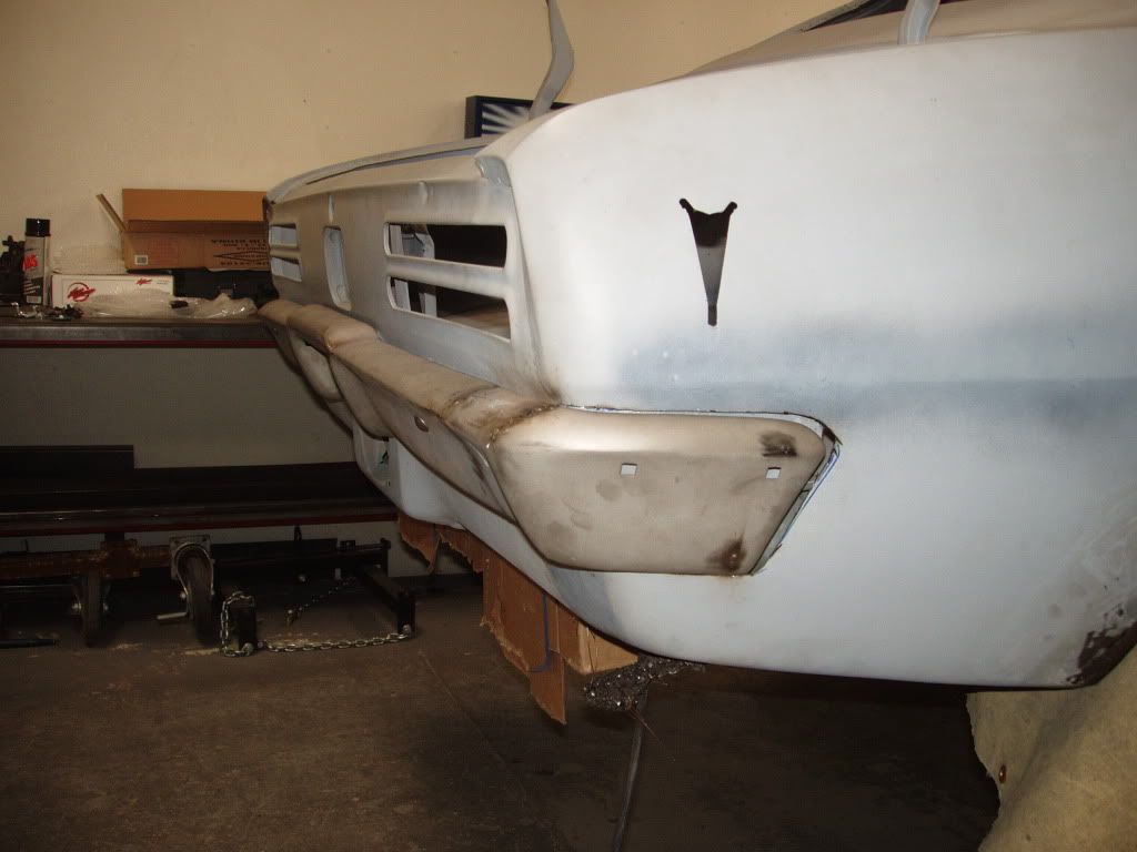

Default Rear Bumper
We started hacking away on the rear bumper!! I like the Firebirds rear bumper shape.. We will see what this looks like when we are done

Work your way from the rear door gaps to the front sheet metal... Align your doors, assemble the front sheet metal & square, make sure the sub-frame with bushings are the ones that will be used on final assembly with radiator support,& then start cutting away..
We completely re-did the front corners on the fenders.. lots of removing & re-install.. cutting grinding & measuring.. & most important of all "PATIENTENCE" .. It will come together..
