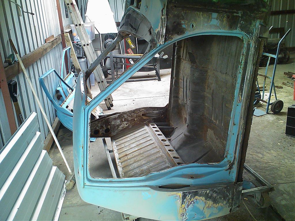

Hi, Just a quick run down on my project. Started with a bare cab, getting hard to find in Australia. Got the cab for free, needs new sill panels and the cowl panel replaced. New flat firewall with a recess for the engine, new tunnel for the Corvette torque tube clearance. HQ twin head light nose panel.

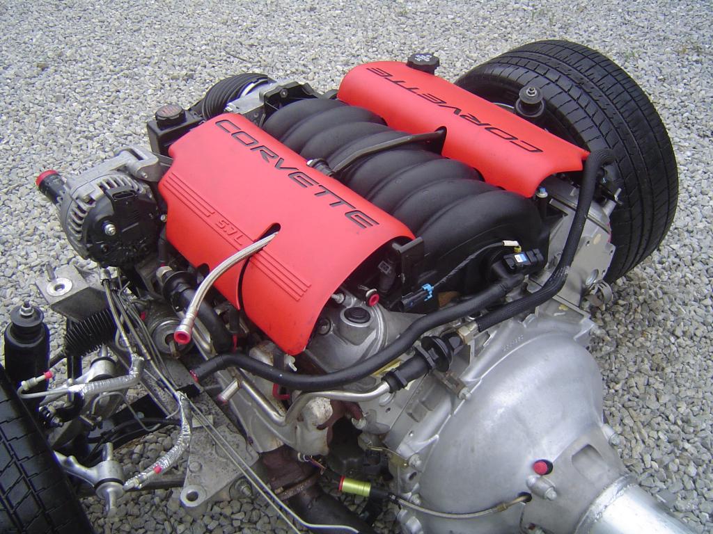

Complete C5 2003 ZO6 Corvette engine and drivetrain with suspension fitted to original modified chassis. rear chassis rails narrowed 7inches.
Kenne Bell ZO6 Supercharger kit.

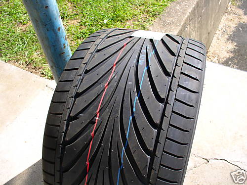

Rushforth 19x8 / 20x13
Toyo 245/35/19 , 345/25/20
