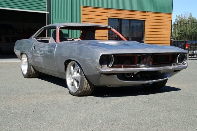

Awesome car!! Nice color combo and workmanship!
Brent

Im in love!

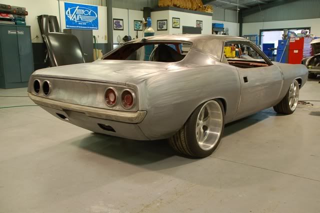

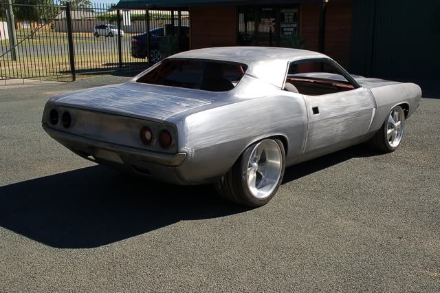

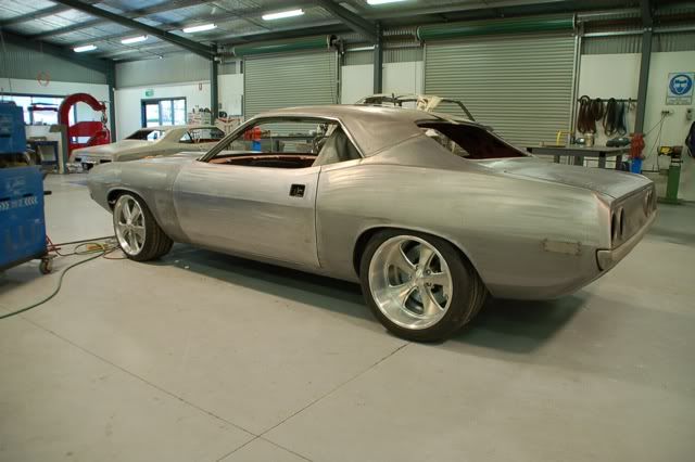

Nice build. Do you have any pictures of the wheel tub work to fit the 345s? Specifically did you notch the frame and did you have to do any "stretching" to the outer wheel well? No doubt a mini tub or tub job, but I know the e-body outer wheel wells pinch down quite a bit. I'm building a Challenger and have been looking at my options to get it low with a large tire also.
Thanks, Wes
Sorry I missed this question,we moved the tub against the rail and massaged the inner part of the outer tub half,which was easy to do while we had the quarter off,no problems with the 345 still has about 1.5 inchs of room on the inside.

Shane,
Thanks-so no notch and do you have any specifics on the "massaged" outer half. Big hammer work or an english wheel and nice curved sections?
Thanks! Wes

No notch in the rails as it is going to be a real world driver,rather than a super low profiler,we just rewoked the wheel house on the english wheel and plannishing hammer till we were happy with the clearance.

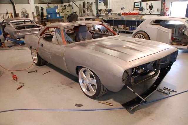

Righteous! What an awesome ride this is going to be. Looking forward to more progress pictures and as many details as you can give.

love to se more people not afraid to do something besides restore a mopar. this looks to be a realy cool build.keep up the great work.
