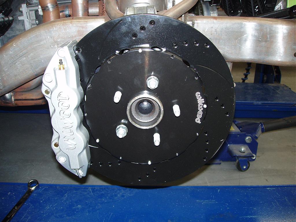

Here is a pic of the front brakes we are using.. The hat offset is to shallow so we are to have to machine a set of hats that have a deeper offset to clear the wheels.. Rotor diameter is 14.25 on all four corners..
Caliper are W6A silver powder coated with custom Wilwood logo that I have to paint in black for the outline..
