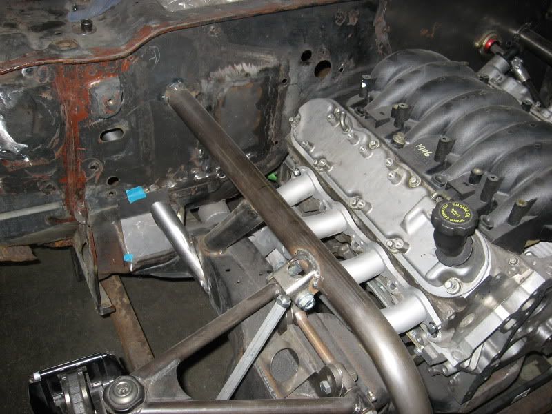

Here are some updated shots of the front structure.

The two pieces of blue tape in the bottom picture. Could you please explain the setup with the steel plate and then the tubing running forward? The plate is attached to the firewall and the tubing is attached to the subframe? I'm having a little trouble picturing it in my mind and my 2nd gen is stored a distance from my home. Incredible build. Things such as the spindle fabrication is just jaw dropping impressive to me.
Thanks for the nice words. Here is a photo from the inside. Hopefully, this will answer your question. Maier is buidling the cage to make the car as rigid as possible. The plate is just covering up the hole in the firewall.
