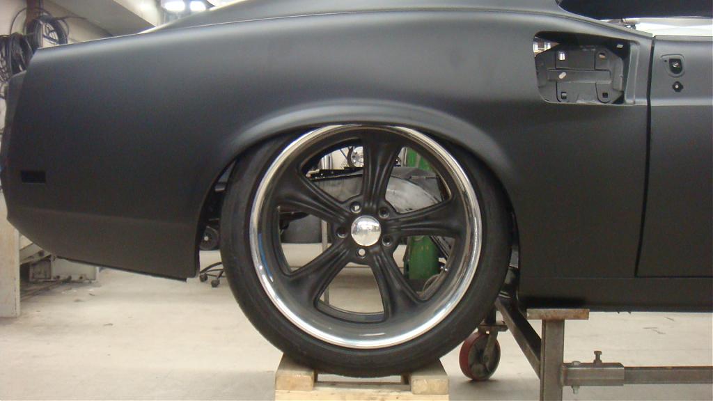

Few Pics Of a 335/30/20 in the rear!!!

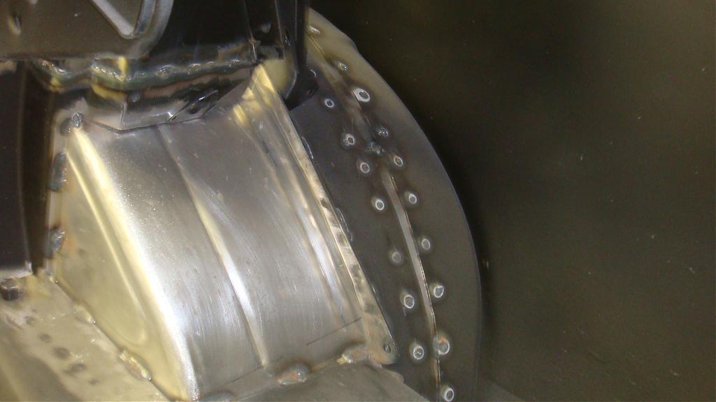

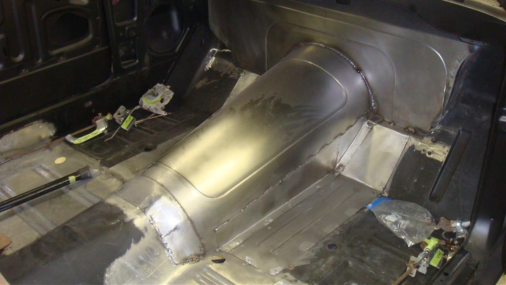

Todays updated pictures. Notched rails and sheetmetal wheel tubs.

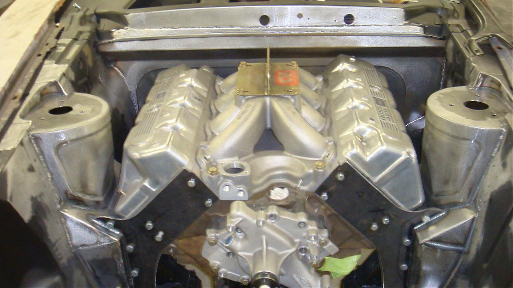

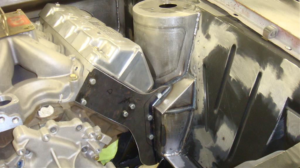

Sorry that its been a while since we updated this thread!! Parts are rolling in and the car is starting to come together.. As you can see in the pics there was a lot of work needed to fit such a big engine is such a small hole.. Once it was in place we designed engine mounts that would allow room for headers. The engine mounts in the pics will be remade out of aluminum.. In the rear we had to massage and widen the rear quarter panels/wheel openings .75 to allow room for the tires. You can see in the pics where we split the outer rear wheel house to allow room for the quarter to move. Stay posted for more updates!! March is right around the corner.
