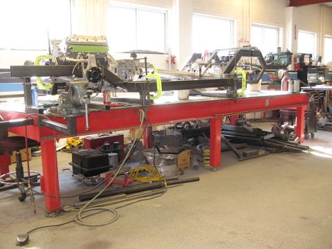

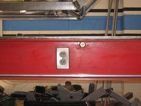

Mine is 5' x 15'. It is 1/2" top plate one piece with 8" I beams. Plumbed for air fittings and wired with outlets.

Mark- That is one serious table, nice job.
