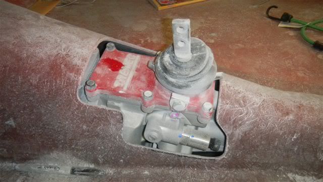

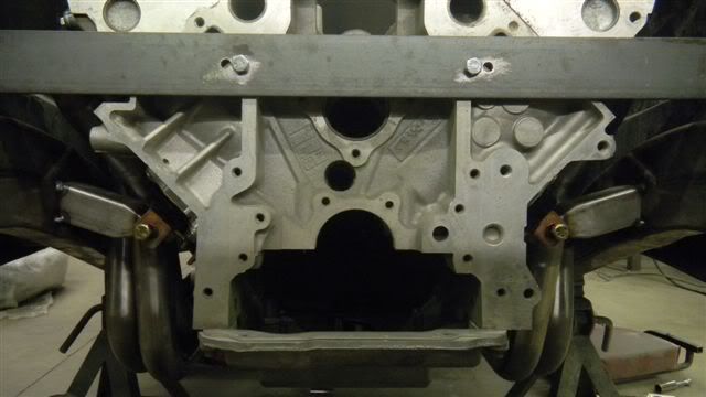

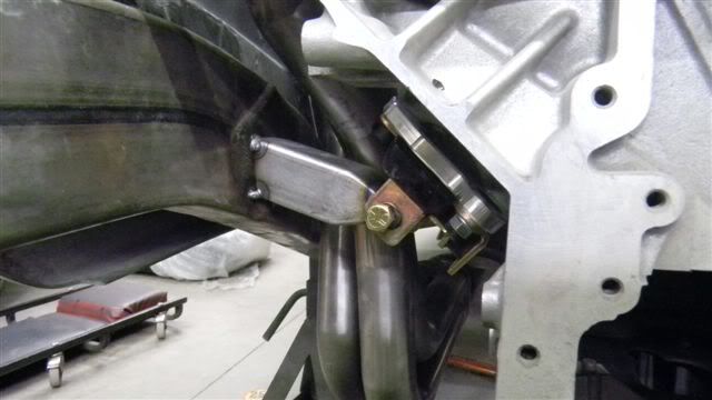

Default Engine Mounted
Lots of work done on the car this week. Kurt mocked up the engine setback and transmission setup and fabricated all the special mounts after numerous double checking of all the measurements. We wanted the engine setup as back as possible (towards the rear of the car), the Magnum transmission is better because the distance from bell housing to shifter location is shorter than a normal T56. Headers were a real problem because the Downs fabricated chassis using Art Morrison Rails is real narrow with 24" between the rails. Here's all the engine mount fabrication and end results. For the headers we ordered the Art Morrison headers and they were too wide. After working with Jamie Downs, Street and Performance....we figured the only prefabricated headers were "shorty" headers. Kurt and I decided that we would go down the route and we'd work with the Morrison headers and "narrow" them.

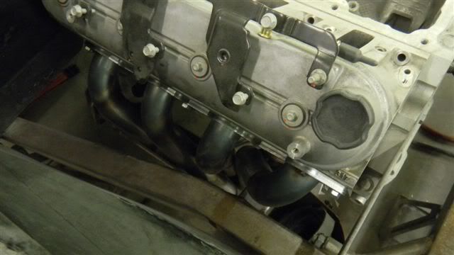

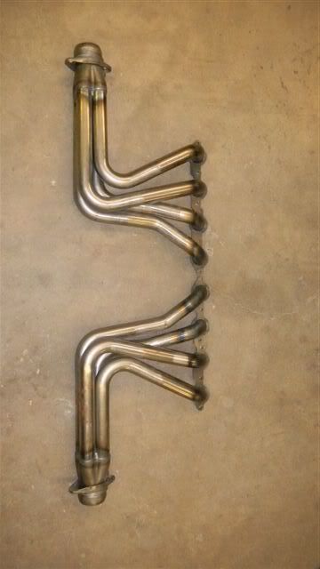

Default Headers
Love look of the headers. They ended up being much closer than we thought. Driver side needed no modification and passenger side had to be narrowed less than an inch. I'm so happy these worked out and only took an hour to redo. I spent way more time on the phone trying to find another option than Kurt did fixing it. It was weird that the 2 headers were shaped exactly the same but one header was "wider" than other.

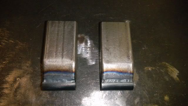

Default Transmission Mount
Here's all the work that went into the transmission mount....looks great, clean,and functional. Nothing fancy but love how clean it looks. If you do it yourself or pay for someone do it, hopefully the number of pics give you an appreciation of how something so important and made clean yet simple will still take a bunch of time to do it right. Even the welded ends of the tab are angled to get the best weld. Notice Kurt's surgeon gloves, he has them on all the time....great way to not thrash your hands, easy cleanup and still maintain the feel....haze him anyways though: you , Kurt
