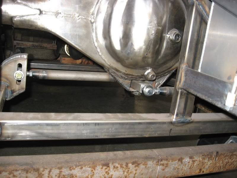

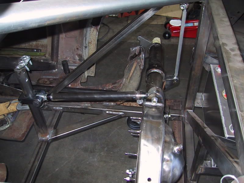

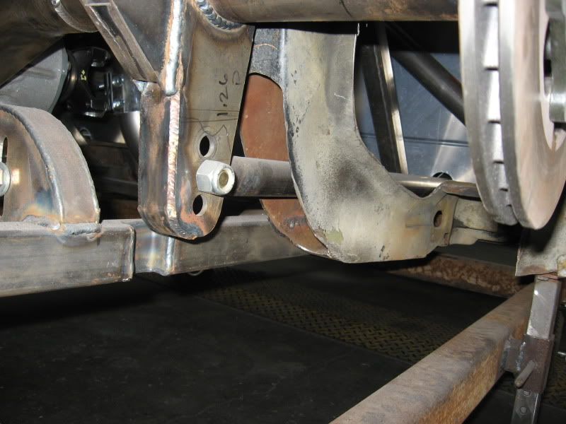

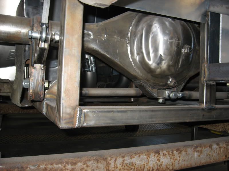

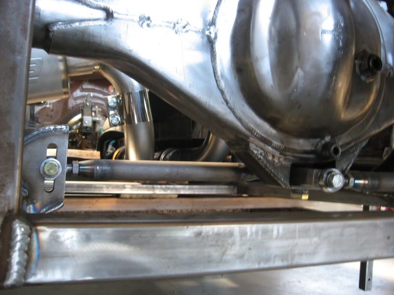

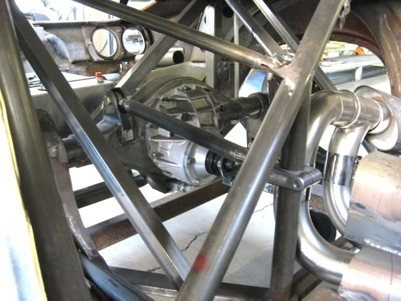

Here are some photos of the 3 - link rear suspension. The watts link is located on the bottom of the rear end housing and the lower arms go through the frame rails, instead of narrowing them link the DSE 4 link set up.
The length of the lower links and upper link are at optimal length for handling. Packaging not an issue with this car as we eliminated the rear seat.

You are tempting to remove the rear seat out of my Camaro!! like the way the watts link is done
