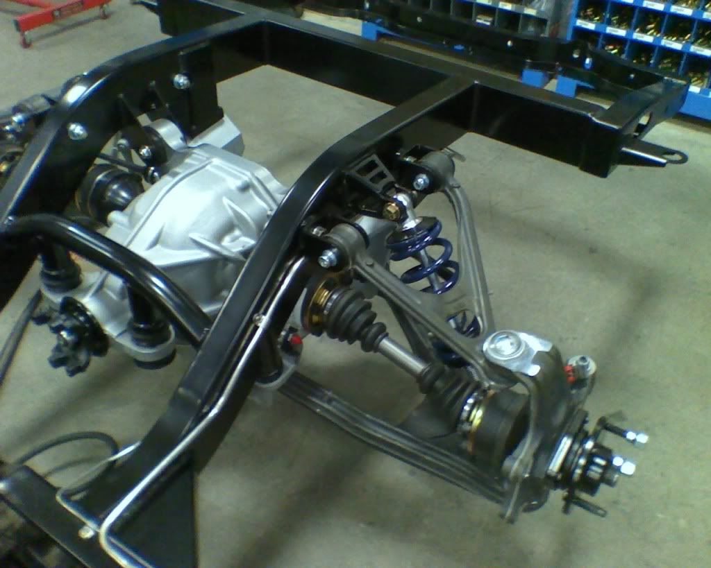

Originally Posted by groovyjay View Post
These are about 1 year old fotos from Street shop's Mid Year build, gotta love the C6 Z06 transaxle too...
except that is not a transaxle....
ist a C6 IRS with am 8.8 inch center section (unless my eyes decieve me) but the term transaxle describes a rear axle with integral transmission...
but it sure is a nice setup though

Looking at the other picture.. looks like an automatic transmission behind the motor.
exactly... guess there wasnt room for the transaxle and torquetube

Isn't that a Viper rear end?
Tonny
like i said (unless my eyes decieve me) its been a while since i looked at an 8.8.. and ive never handled a viper unit.. so you are propably right
