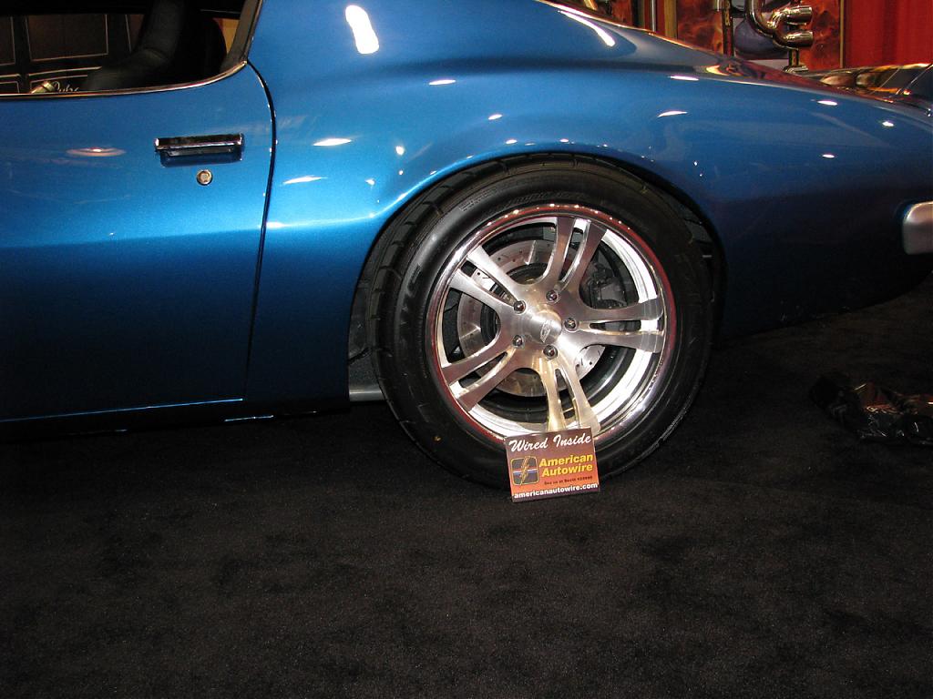

My 71 Firebird has Falken 295/40/18s on 18x10 Rushforth Superspokes on the back with the big round wheel wells... with 5.75" backspacing... stock tubs... stock rear end housing etc.
Keep in mind I've got more room without the stock rear leaf springs utilizing the BMR rear torque arm suspension.
Pics attached... HTH
