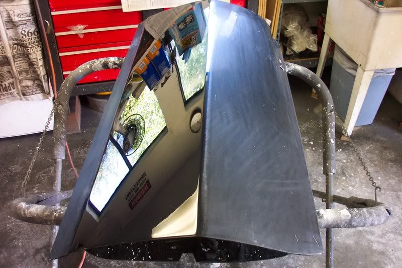

BC/CC. Stay away from the single stage stuff if you can.
For pure black I like the Dupont 99T with chromaClear clear coat. I've shot this on a Camaro and it turned out very well...
