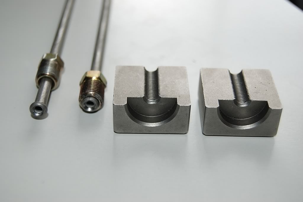

Email from them:
I put a replacement set in the mail today. You should receive them within the next couple of days.
Thanks
Bill
Looks like ill have a new one soon. Atleast they have great service.

For the record my flares looked just like yours. I had a few leaks at first but just tightening and loosening 5-6 times cured all leaks.

Im glad mastercool took the step forward and is making it right. Would be cool if they had a tech guy get on the phone to find out why the gripping threads went flat. I like solutions and fixes, not just fixes. Thats my inquiring mind at work. There is a reason the threads went flat. Maybe a soft batch of dies? Who knows.
Yer gonna be set back up though. Thats the main thing. And ummmm, I think your flares are fine. A 3ft stick of tube to ruin while practicing with the tool wont be too expensive. Flare, examine, cut, flare again. You can get ALOT of experimentation from one 3ft stick. Glad it worked out. JR

Ok, so Mastercool sent out the new die set, so here is latest.
New dies, they seem to hold the tube much better closer to the correct OD of the tube, so it does not mar the tube up so much compared to the first set, and the critical bubble end has held its shape, and the results speak for themselves, perfect flares and the tube nuts slide down perfectly.
I have to say I'm much happier with these results.
