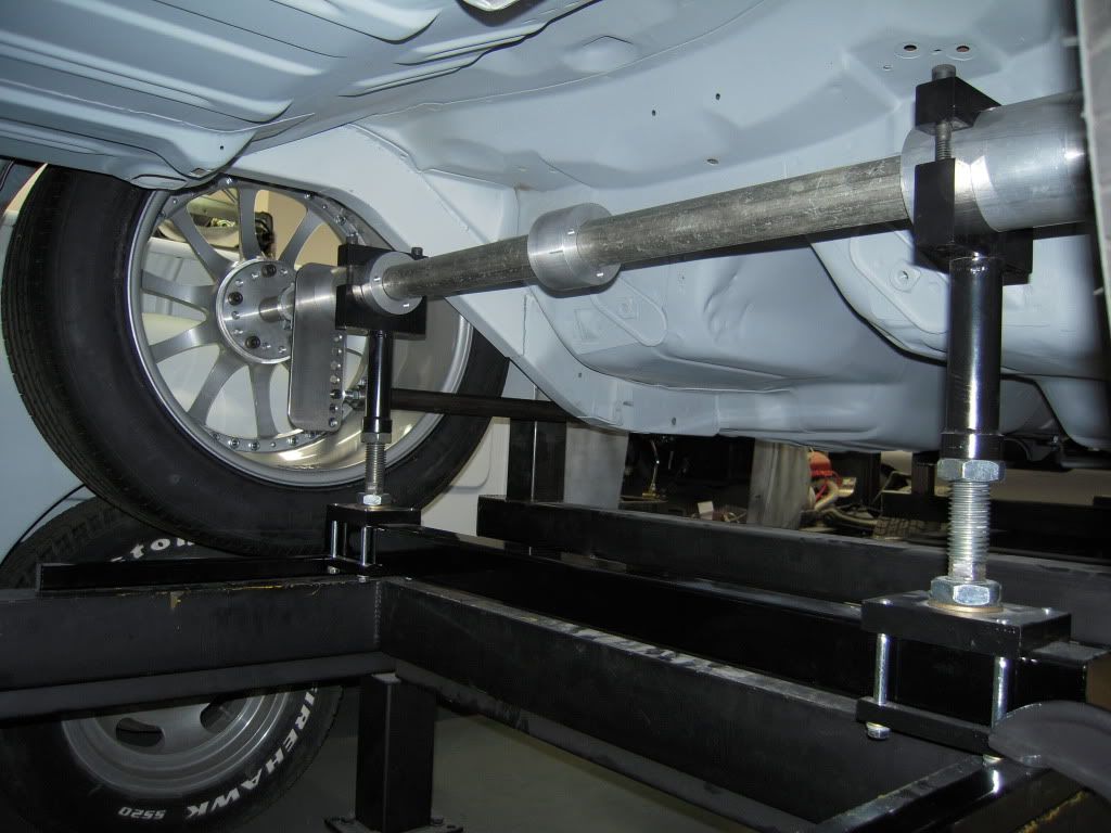

Got a quick quesition - tell me about the fixture you have laying under the car. What does it do ??

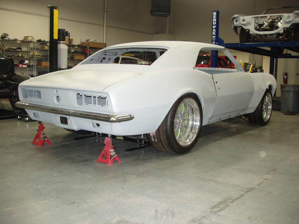

Here are some pics of the 67 Camaro that I started this thread with on stretching the rear qtrs. I borrowed some 345-30-19 that I had lying around from another build so that we could see what the car looked like. The front fenders are not modified & think the car does not look to bad. Sorry that I could not get the car lower on the front but suspension got in the way. We could run this rear tire in the back of the car but needs to be mini-tubed!
What you guys think????
marty-mj

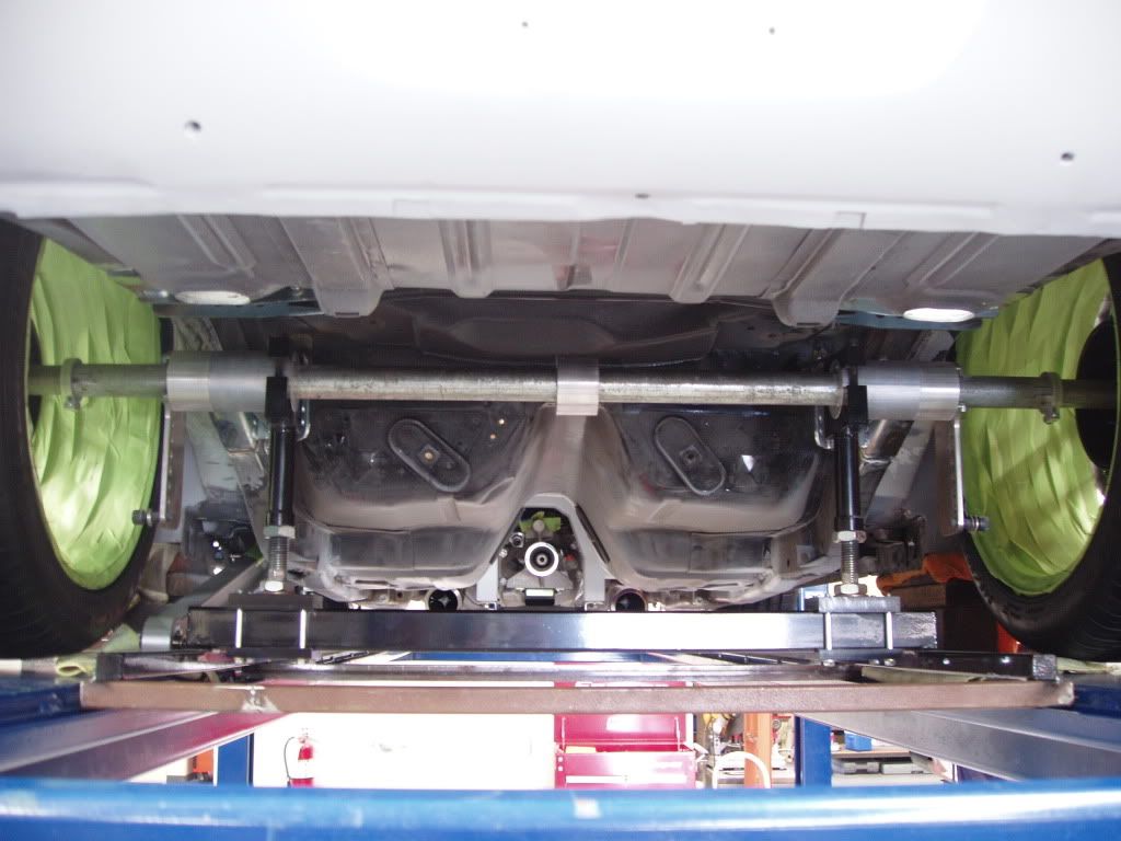

It is a rear end jig that we built to do rear-end measuring when setting up rear suspensions.. It works great for when we need to get OAL on from axle to axle when ordering a rear-end..

Here is another pic of how it helped determine if my lower links on a Chassisworks rear set up was going to clear the rear tires & make sure that we mini-tubbed it enough!!
