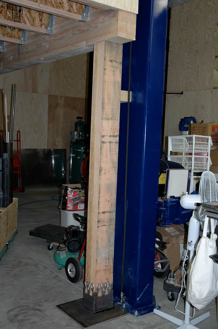

The hell with the ridge beam and board and nailer...
Just "hot rod" the existing post the way I did mine!
AND YES -- IT IS BOLTED TO THE FLOOR -- but the post is sitting over the bolt so it's blind. And NO I don't give a damn if it's code or not.
A plasma cutter -- and a Burr King.... can make almost anything!

Thats awesome looking! How or where did you get the flames? that design would be cool on a door kick plate or something aswell Ideas ideas..

Can't remember exactly -- I'm old... but I think I traced them off a car in Rodders Journal -- then scanned that - and then blew them up using the computer to the size I thought was right... traced them out on the steel with a welders pencil -- plasma cut 'em - and then worked the edges a bit on the ol' Burr King...
In "sheds" like ours (personal toy sheds) stuff like this is not only fun to make -- it's what sets the tone and feel of the dump.
