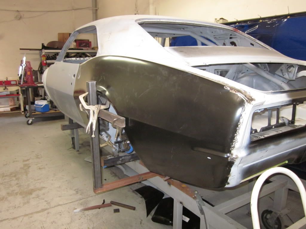

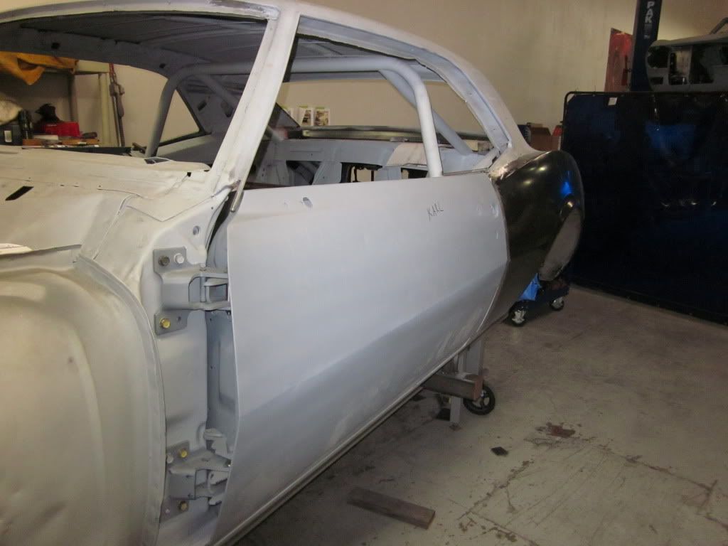

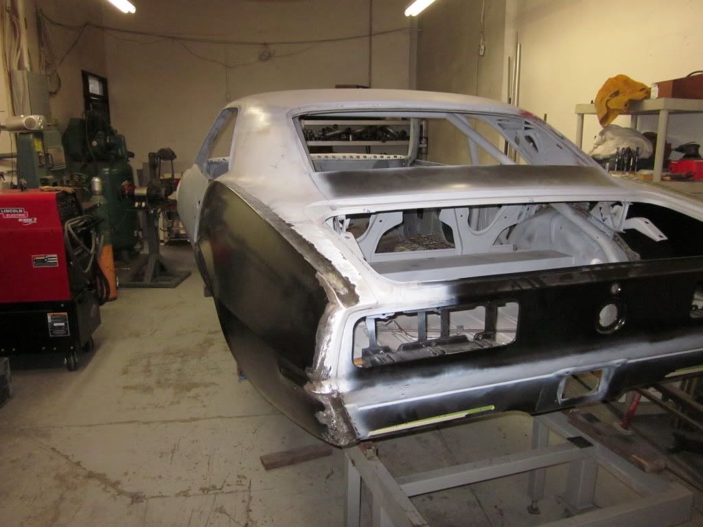

Here is the latest update on the rear qtrs... We are finishing up all the small details.. We will be starting the front fenders this week..

Looking good! That quarter looks factory. It will cause a lot of head scratching as people will look at it and say its different but how? And how did you fit those tires?

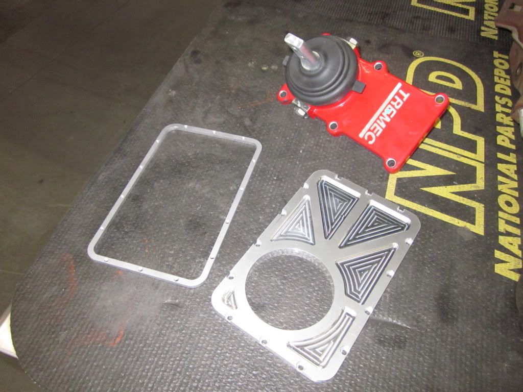

Here are some plates that we machined last week for the shifter.. The transmission tunnel is almost done.. but need these pcs to complete it..
The thin steel ring will be welded to the tunnel & the aluminum plate will give it access thru the top to remove the shifter when tranny needs to removed...

This stretch is totally different from what we did to Track Rat... One of the things I did not like from when we started doing this body modifcation was that it was rasing the body line & the wheel well opening... The way it is done on this car it less noticable that the qtr was widen up..
This car needed both qtrs replaced.. plus one of the reason I got the project was because the customer wanted all four corners blown out..
