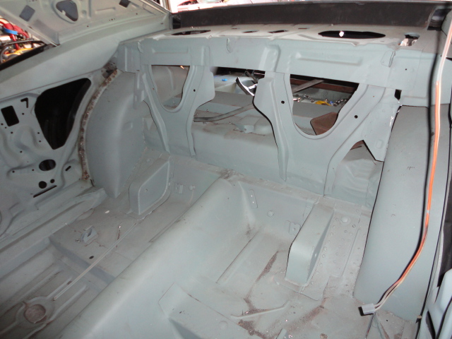

been on site for a bit now figure I would post some pics of my current projet.
its a 69 camaro x11 hugger orange 124vin
got it back from media blasting
lost the before pictures but this where i'm at

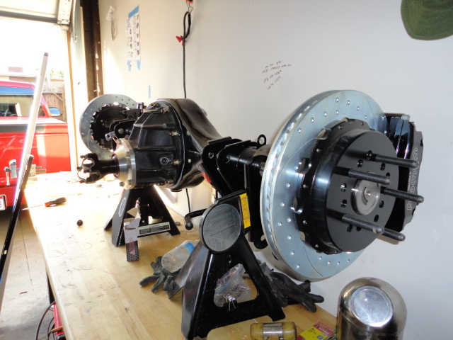

Im running DSE quadralink and minitubs w theyre 9" ford rear end moser axles ,wildwwood brakes 3.50 gear ratio. I also have DSE frame connectors and soild bushings not on, yet.
replaced pretty much everything on rear except trunk floor and structure
I will be running an LS6 with magna charger and t56 setup that came from a wrecked 2005 ctsv w 25k miles.

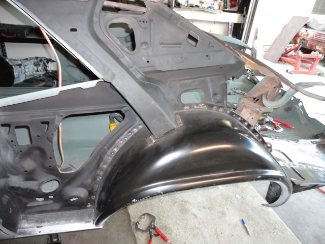

I had to do some adjust to minitubs after the fact , I didn't have tires when I put them in. I still have some minor adjustments on the rear but its coming together.

Sweet project and nice work, Frank! Be sure and post lotsa pics as you go. What was the prob w the tubs that needed adjusting and how did you tackle that? I'm finishing my tubs but dont have tires under it yet. The way I'm approaching it is to ensure I have 14 1/2" i.d. @ 10 and 2:00 and then rolling the lips. Keep going man...

well the problem was I had no wheels so did not know dimension and clearance nothing like placing a tire and seeing it in there. I just followed instructions and well I just din't cut enough into the rails. so as you can see I had to cut it up again. but I inproved it by placing 1/8 metal plate on inner inside of rail and then building the out side out of one piece.

Yeah, we fit/measured 100x and then cut for clearance. We also had to put 1/8" reinforcement on the backside of the framerails. GM coulda given us a better location to start with...
