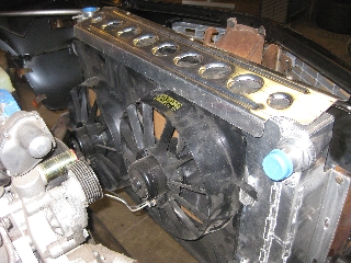

Here are some more shots of what I did today.I fabed up a radiator cover plate which will need some corner's welded on & then some fender/core surport strut's.I want to use one of those cool anvil auto closeout's so laid the 3/8 rod end's on top of the core surport w/some cone bushing's I had. I will DA the alum. then have it powder coated before instllation.I stoped off at the bone yard last week and found a 3.5 alum. drive shaft out of a 2004 crown vic. cop car ($15.00). Shortened it 5in. and bang it fell right in place. Advanced Auto had some crossover ujoint's ($9.90ea.) that helped it fit my T56 slip yoke & 1310 9in. ford pinion yoke (Labor to shorten priceless).I am going to scotch brite the shaft and leave the painted police decal on it then clearcoat.Now all I need are some,cop shock's & cop brake's and I'm ready to roll.

So cool Scott. Not only (normal) awesome stuff that comes out of your shop, but now vintage parts melded in. I love the look of the radiator cover and fender braces too. Keep going man...

Way to go Scott, great idea on the driveshaft.

Looking great Scott. You are making good progress.
