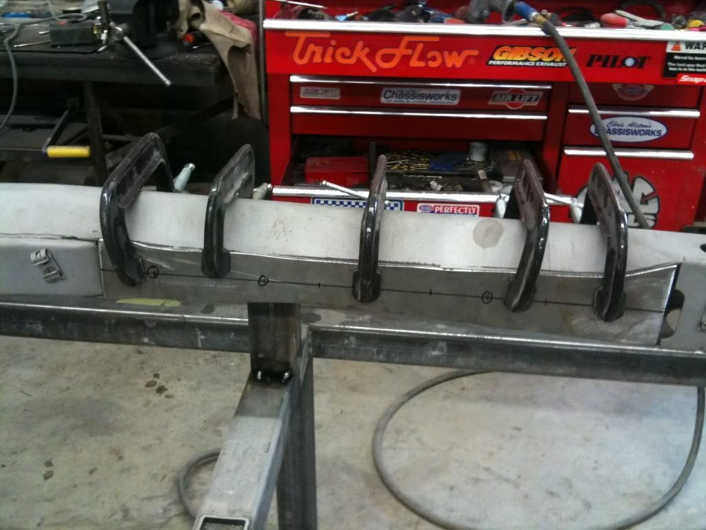

A little update.... Got boxing plates fab'd and welded in as well as my recycled crossmember. I also got my tubing bent for my 3 link upper bracket. Now I just need to trim it to fit.

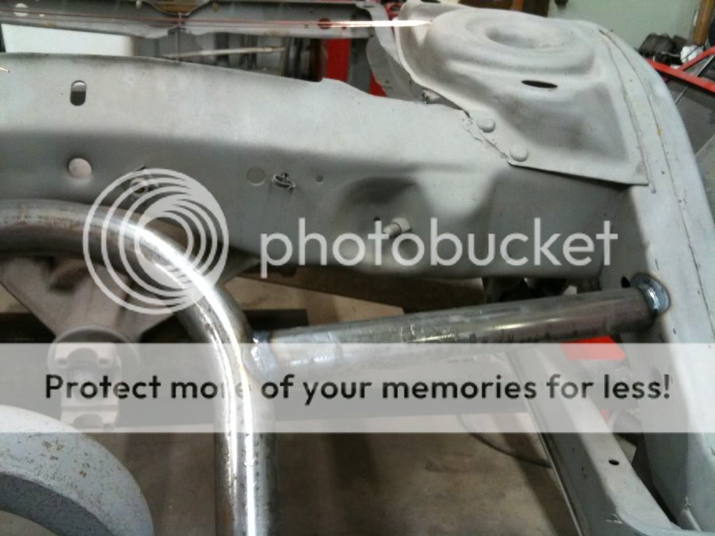

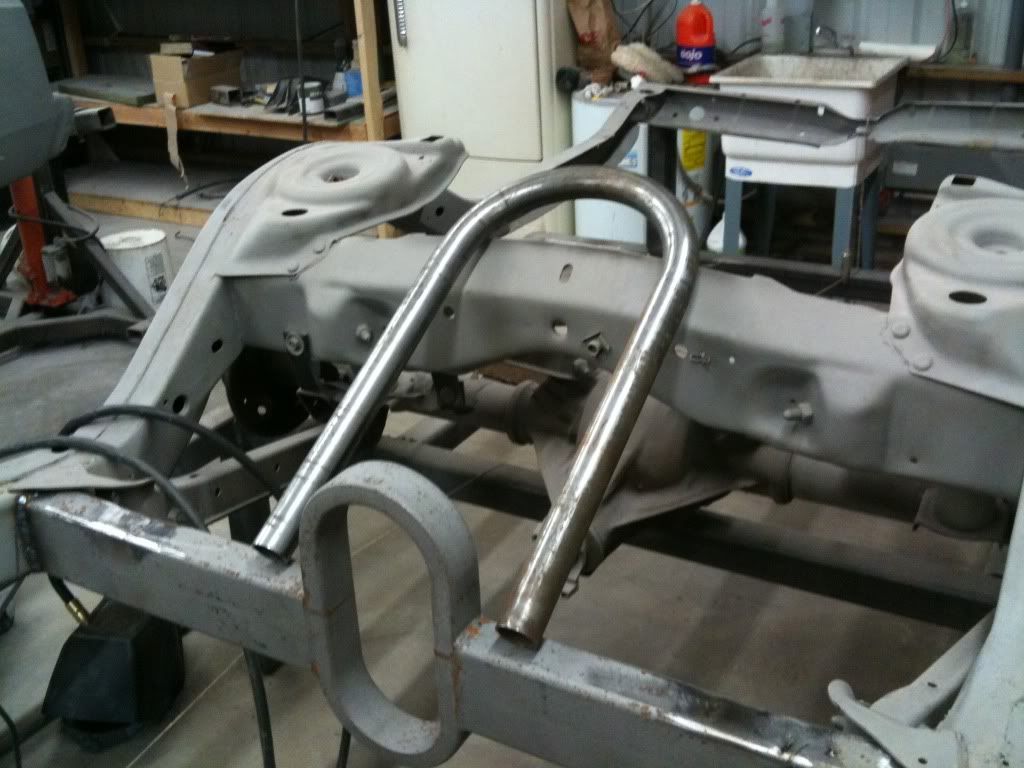

Got my 3 link hoop and braces fab'd and welded in today.

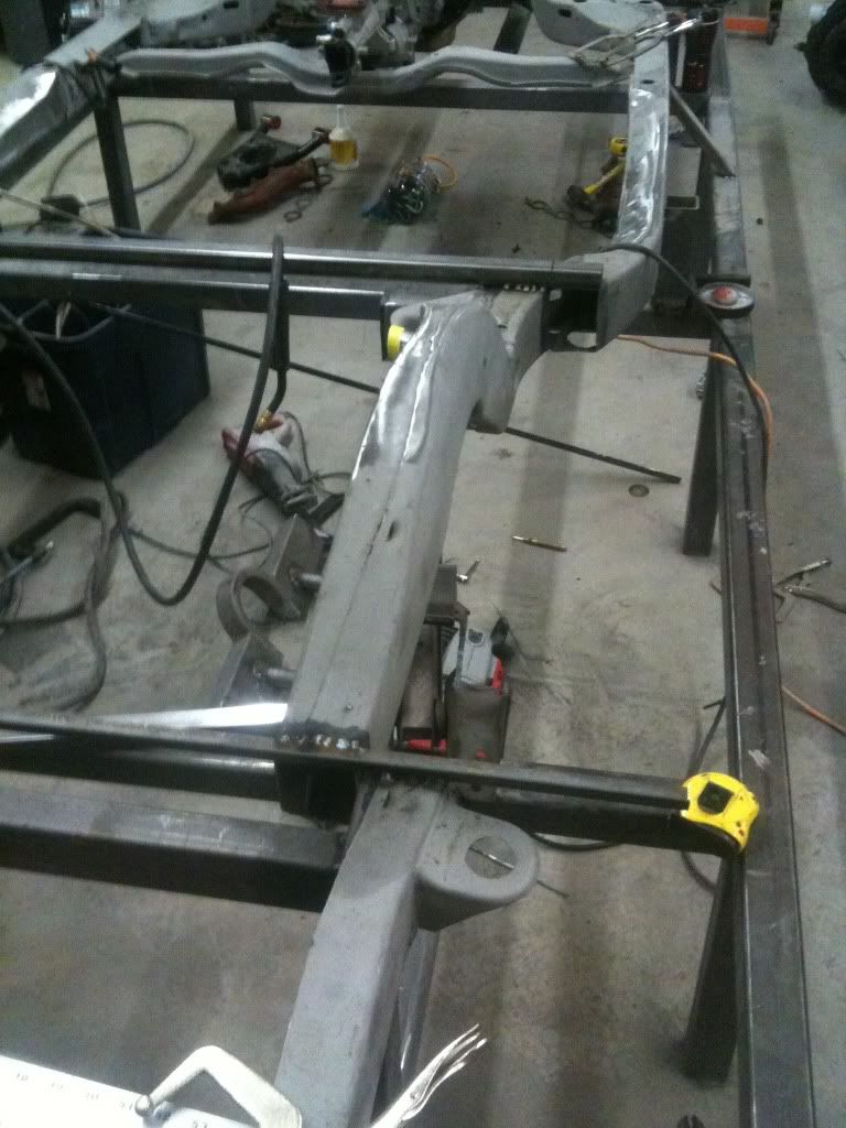

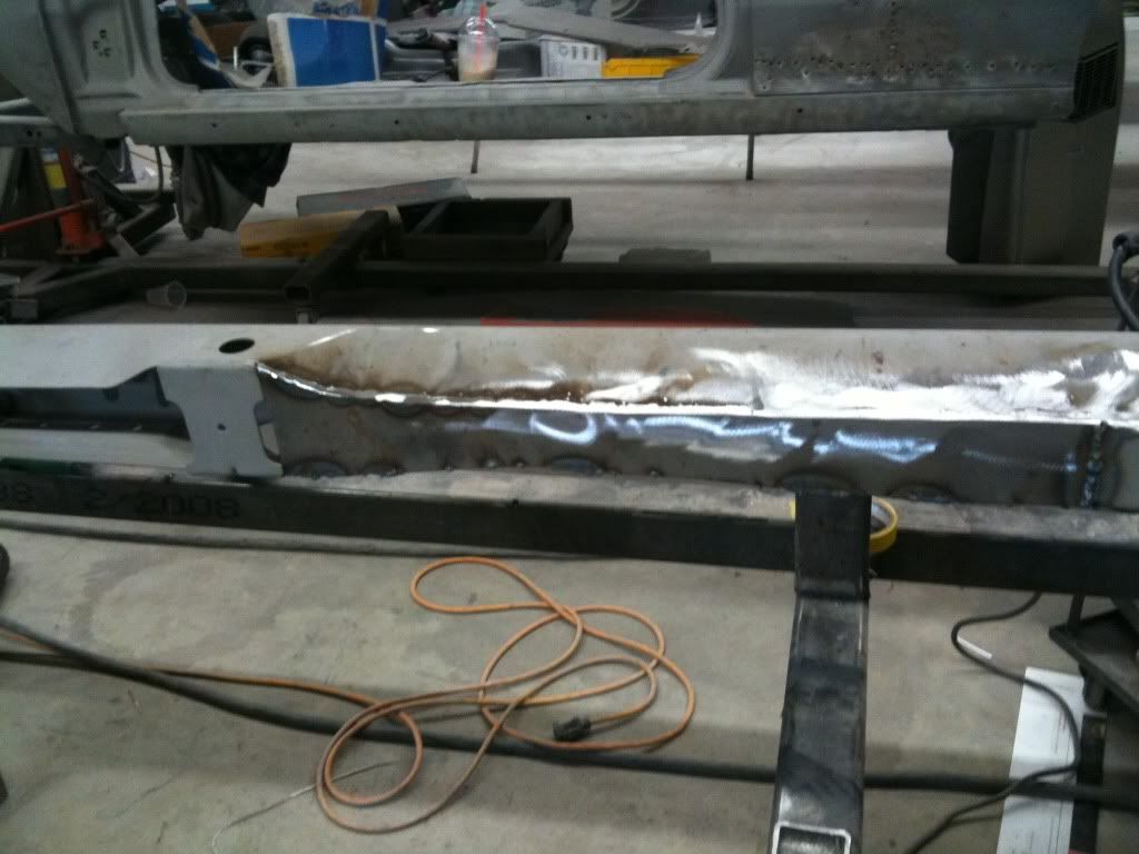

Had some down time today while waiting for parts for another project so I decided to spend a little time and narrow the rear frame rails 3" per side. I had to cut out my rear crossmember and 3 link upper mount so I will have to redo that as I did not originally intend on narrowing the rear frame. I also ordered the new RideTech single adjustable coilovers front & rear for the car and they should be here some time next week.

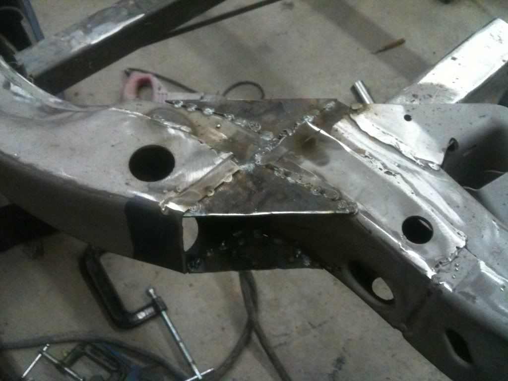

Just a small update. had some time this morning to fab up some gussets and got them all tacked in place. Now I just need to cut out the flat plates to finish boxing in the gussets and then do all the final welding.
and hope everyone is having a happy and safe Thanksgivings.
