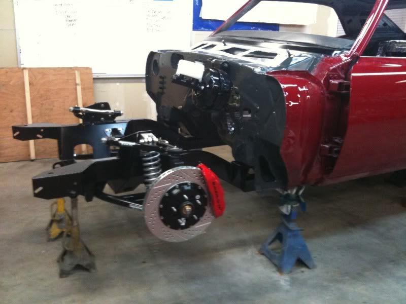

here is a Speedtech set-up- tall spindle- Unisteer with an 18x9 and 6in BS with a 275- I bolted the wheel on last night and was amazed at the turning radius- I would say the first thing that would contact is the upper A-Arm at the ball-joint with a tall spindle- If you are interested I can get some pics tonight from above showing lock to lock- Chris
it does not look like you have the rack and steering arms installed. With those installed, you will clear everything on the insde. I just rehooped a set of Boze wheels to 6.5 bs that we originally spec'd for a stock sub, then changed to Speedtech sub and was able to suck the wheels in further to give us more clearance
