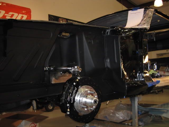

As it came back from the blaster
[img]
new lower toe kicks and reinforced factory frame rails
[img]
new sheetmetal installed
[img]
stripped down and setting gaps
[img]
[img]
Steve Keefer

engine compartment ready for satin grey finish
[img]
blocksanding, blocksanding and more blocksanding.........
[img]
[img]
[img]
the hood will get Mach 1 style scoop and finished in satin grey center (mach 1 style)
[img]
[img]
[img]
Boze "pro touring" 17x7 front, 18x8 rear satin grey center brushed outer
[img]
Steve Keefer
