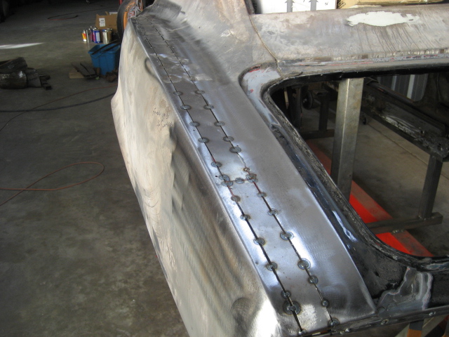

Here is a teaser update until this weekend after I finalize a few plans and loose ends. Car is being fast tracked to debut at GG Columbus and we have to get to Tracy's May 1 so things are going to move very fast from now on.
This is the start of what a Musclerodz wide body treatment looks like on a 67-68. By doing it way I have done the first step, you will not notice the rear is wider unless it is parked next to a stock one. We are also completely reworking the rear lower quarters and lower valance. More to come......

Looking good! What size rear tire can you run when the quarter is stretched like that?

Awesome Mike. I've been picture starved on this one; thought maybe it was going to fly under the radar! The fender stretch (width) looks really good....
345 but could easily go bigger.

Awesome, on a 67 too...thanks Mike.
