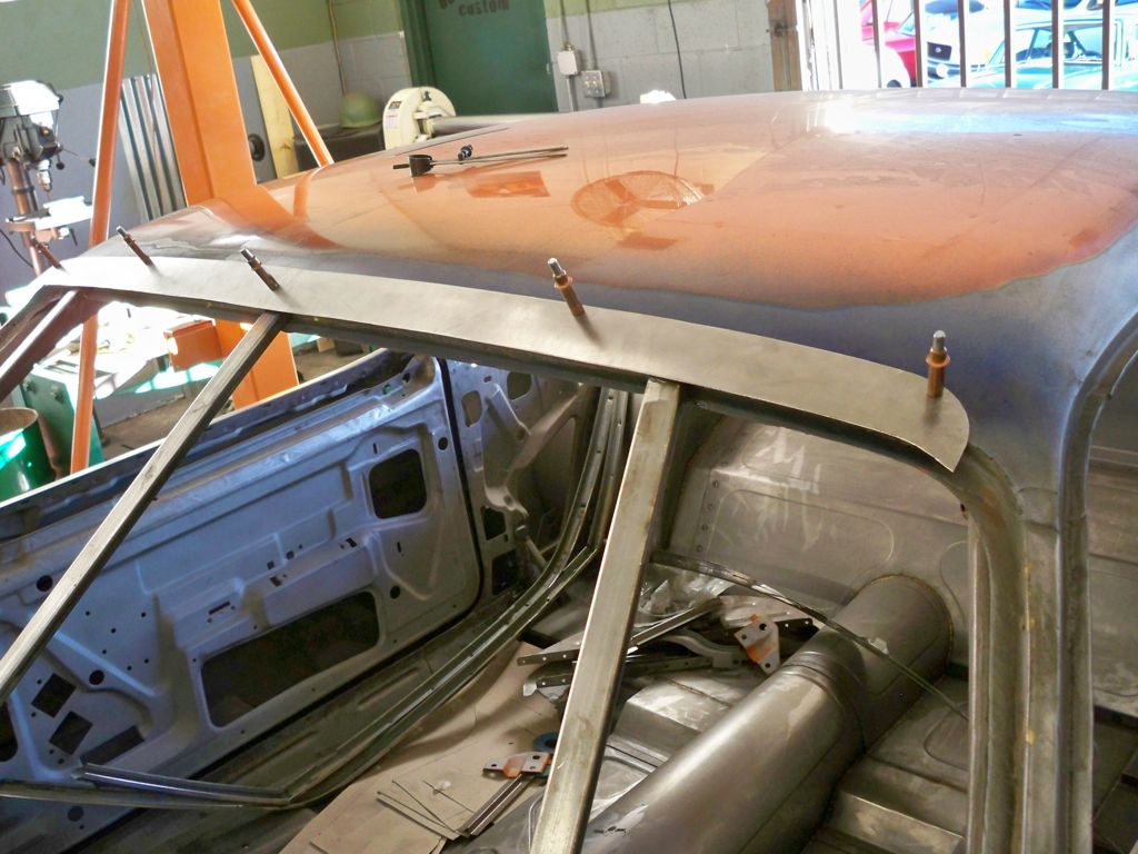

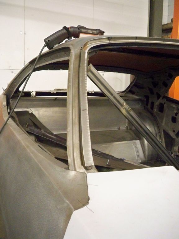

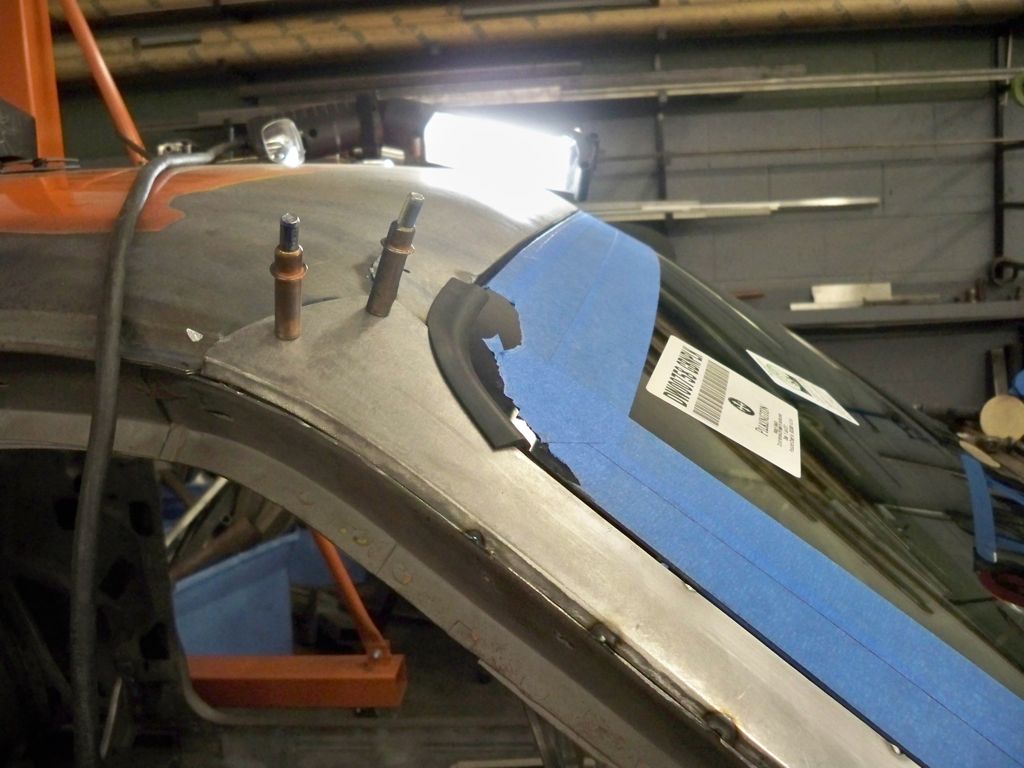

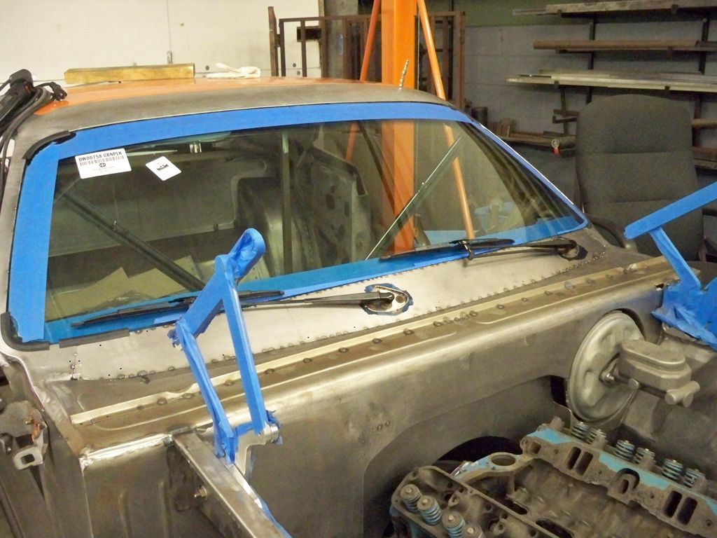

Just a few simple updates. The windshield and A pillars are pretty much finished up except for some welding. We took some late model window rubber that fit and looked the best. Replaced the entire frame and shorted and narrowed the hole window opening to accept the new rubber. The front A pillar was also widened to help the look and eliminate the drip rail in the process. The lower part of the cowl was also fabricated and new wiper mounts were made. Just ordered up a DSE universal wiper motor and will mount it on the inside once the cage is made.

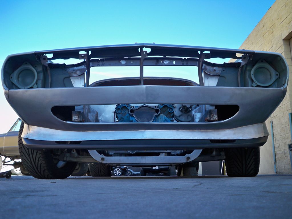

Not sure if I posted pics of the front after it was finished but you can see the 2010 SRT-8 chin spoiler mounted

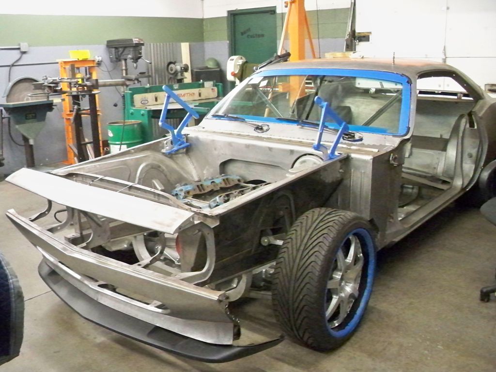

couple more

Wow, very nice fabrication on the windshield and lower valance (and whole car)! I doubt when someone sees the finished product they ever realize how much talent and time it takes to do flush glass and the new wipers, etc.----a sure sign of top notch fabrication. I can only imagine how much true skilled metal work is required for all those compound curves.
Thanks for posting an update.
