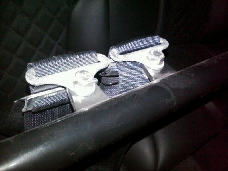

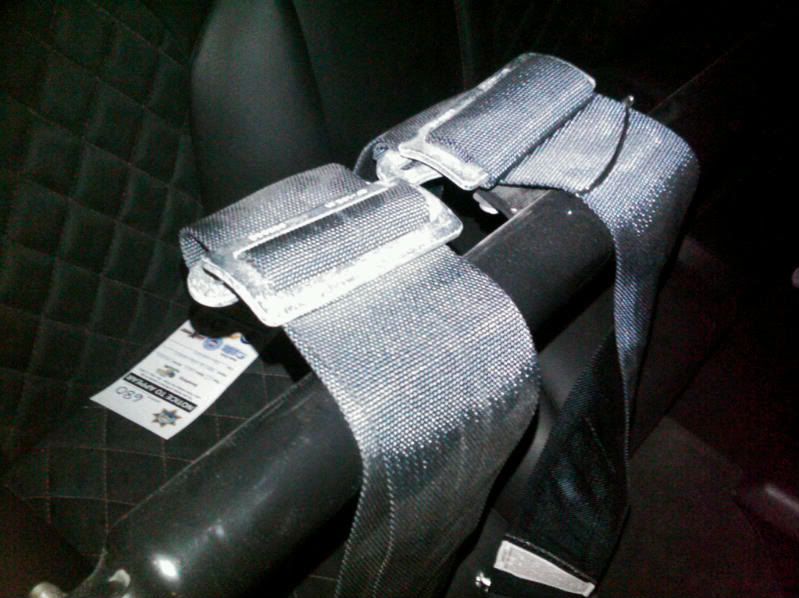

I'm guessing for what you do with the car even going to a 4-point REAL harness would be a HUGE improvement on the track!

If your gonna be fast, and do alot of track days with your car, you will find the limit and go off track and hopefully not into something hard.
I would try to make a 5th point work even if its over the front of the seat.

Can't you have the interior shop that did the car slot the seat for the 5th belt?

A 5th belt is almost a must.Without it when you pull down on the shoulder belts the lap belt will be pulled up..That 5th belt helps keep the lap belt where it belongs.
