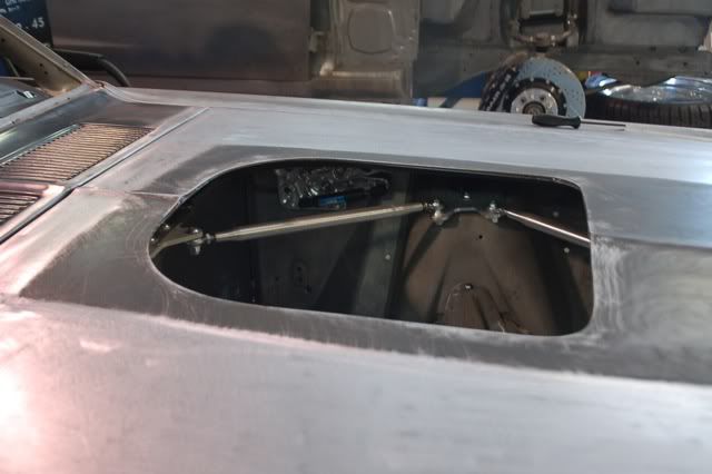

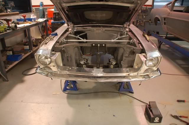

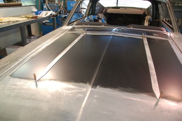

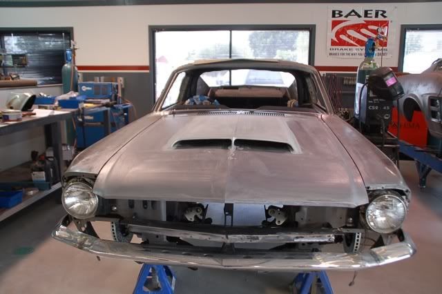

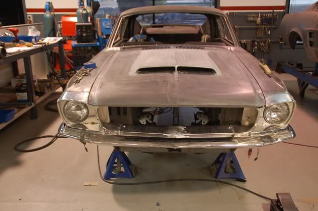

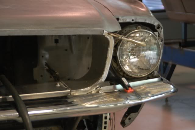

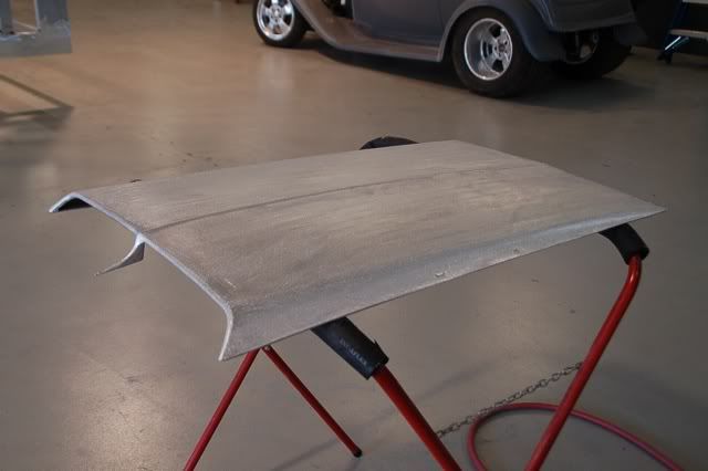

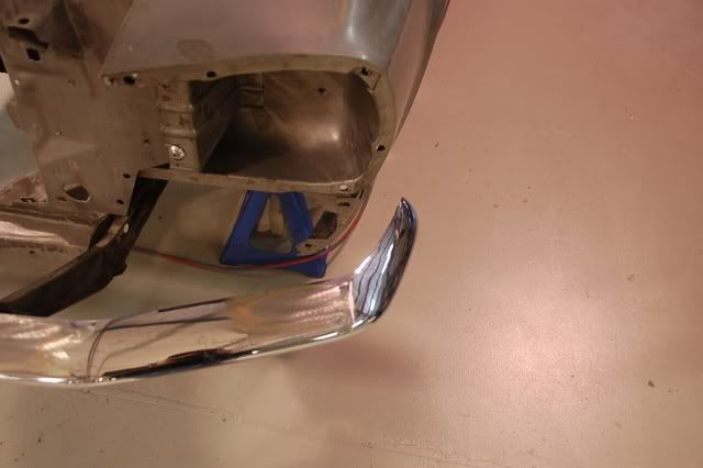

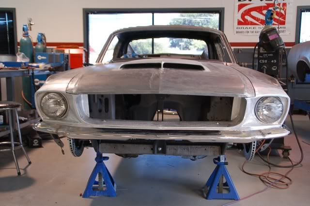

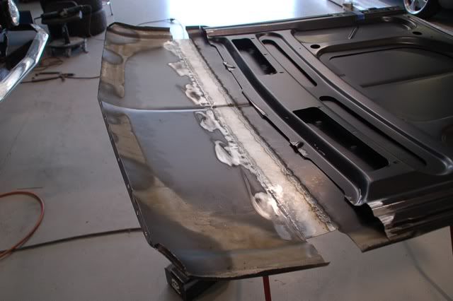

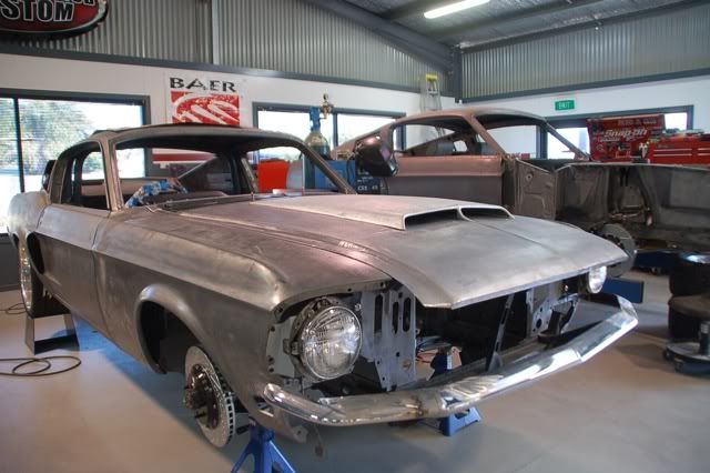

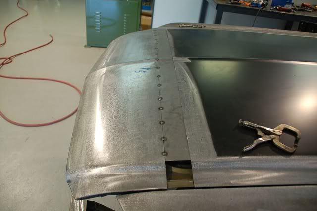

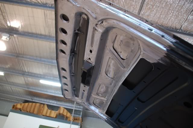

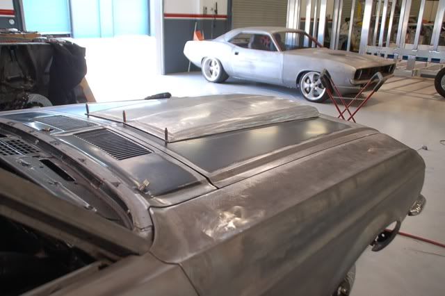

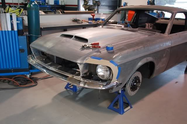

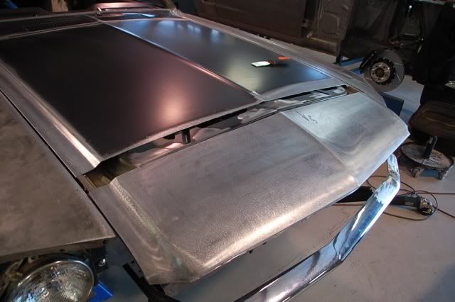

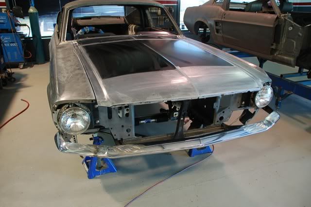

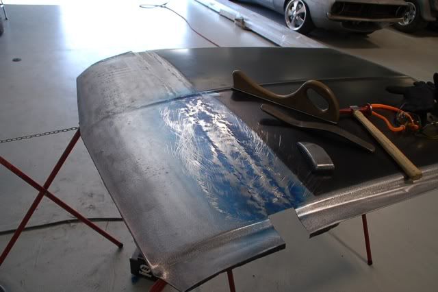

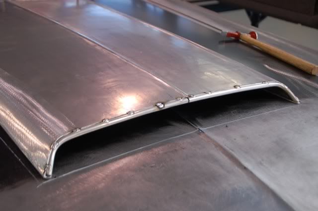

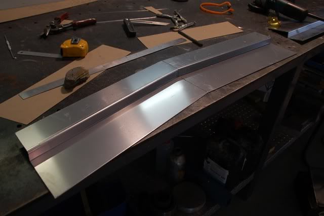

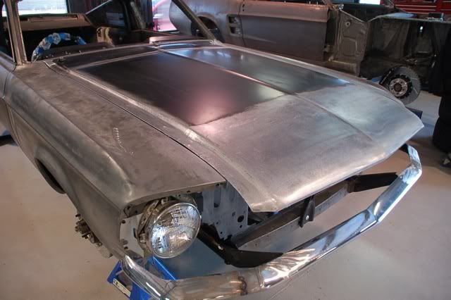

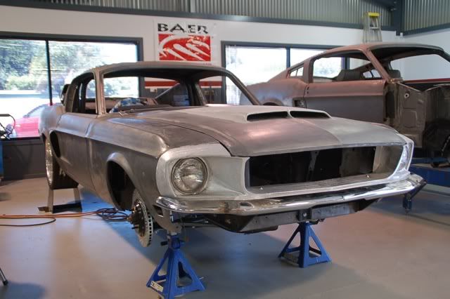

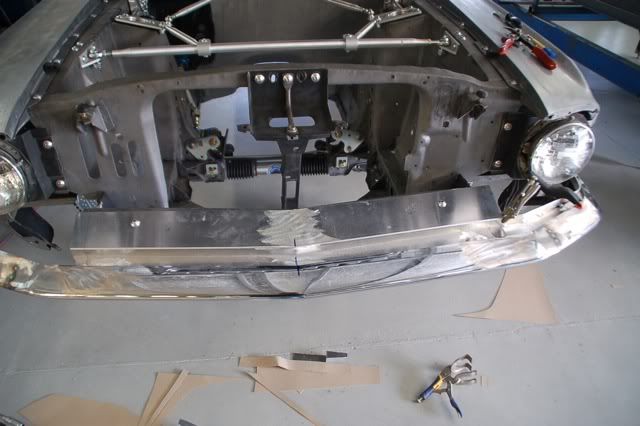

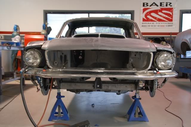

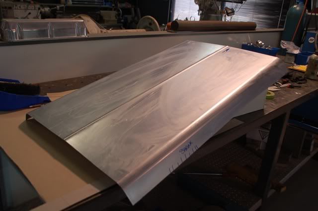

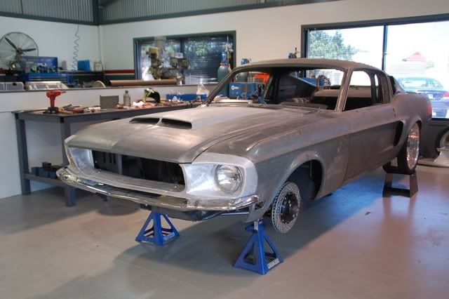

OK update time,fabbed up the front last couple of weeks, lengthened the hood
3 inchs and fabbed a functional hood scoop,decided after welding on the front half of the hood (repro piece of CR***P) that I would fab the scoop in aluminum and bond it onto the hood.
finished fabbing the front fascia,next Im onto the lower valance/ air dam then on its wheels to have a look outside at its profile.
