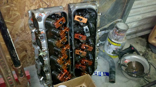

I just purchased a 468 for my chevelle. I had the chance to drive it and rev it before i bought it. The thang ran very smoothe and sounded good. He told me it had an Eagle crank, rods, and Speed pro pistons, the cam was a flat tapped hydraulic. So i couldn't wait till i had the chance to take it out of his car. So just being myself I knew i was going to change the valve covers anyway and put a hydraulic roller cam in it. (Oh forgot he said the heads was ported and polished... So anyway i pulled the intake off to find the heads wasn't even touched and i found this..

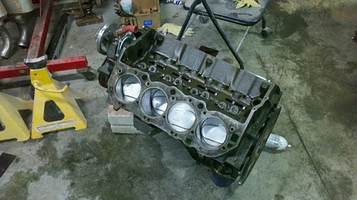

Now that made me mad.. So i found i needed to get a head job then i need to get rockers.. so i was like dang i wonder if the rest of the motor is what he said..lol. So off the heads went and then i was little supprised. So I started to break it down and everything esle checked out ran the numbers on the other parts. Only thing is now to get him to first come look at this and refund me some of money. But he didn't know the block was stamped HI PER on the back and the heads 781's. So i think 1500 wasn't to bad. What u guys think?
