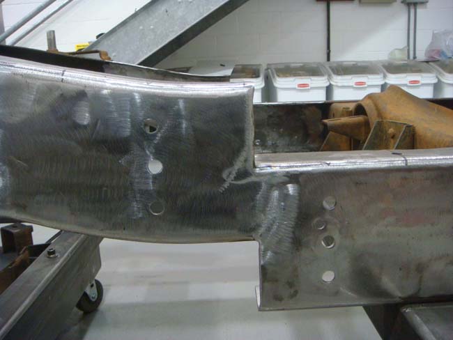

Extra frame that was free. Long wheel base cut down to short wheel base dimensions. Rear bed 'clip' Z'd/raised 3" to match the raised dimensions of the front Porterbuilt Dropmember front suspension.

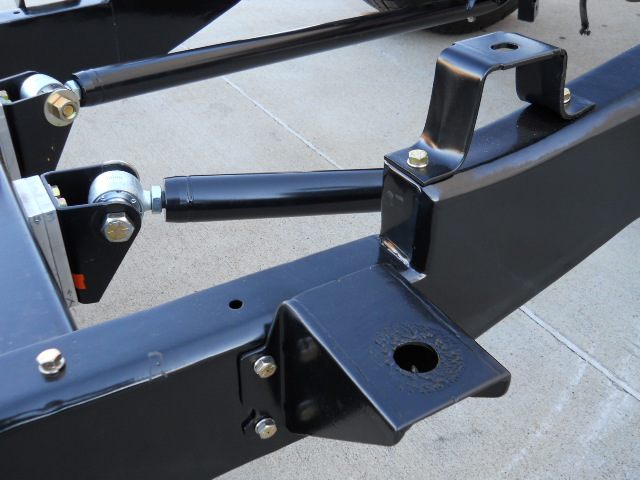

Rear suspension is....
Porterbuilt rear truck arms w/raised front mounting points (flipped brackets =3") & adjustable Spohn swivel joints
Porterbuilt rear Panhard bar w/owner fabbed adjustable frame bracket
Slam Spec RE6 bags
Bilstein shocks (G-body)
12bolt, 3.73's, Moser axles, HD drum brakes
