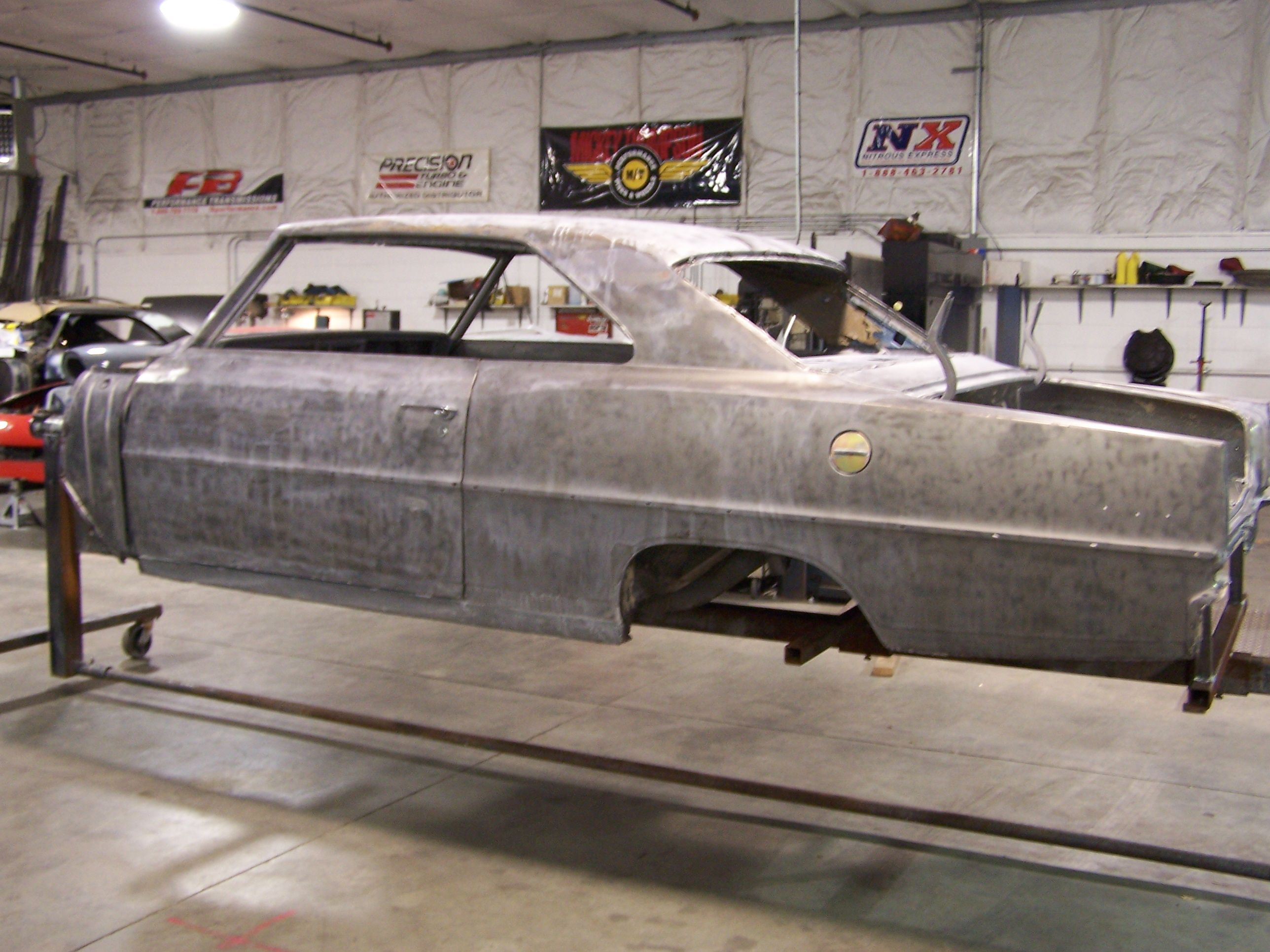

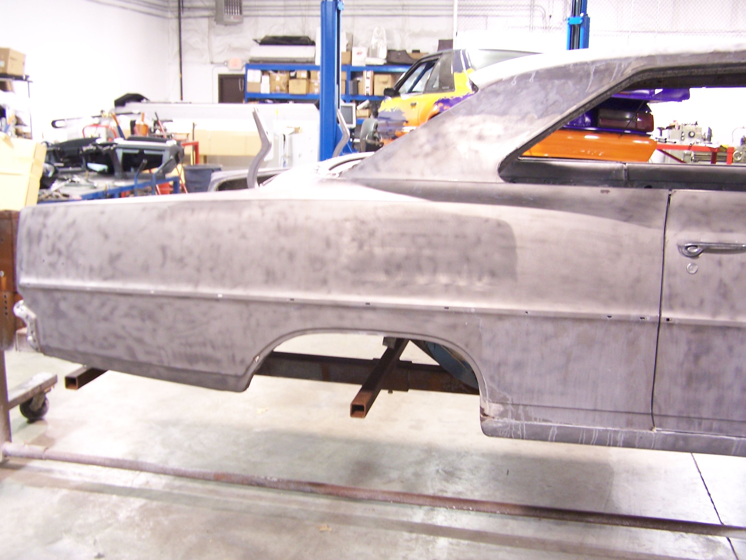

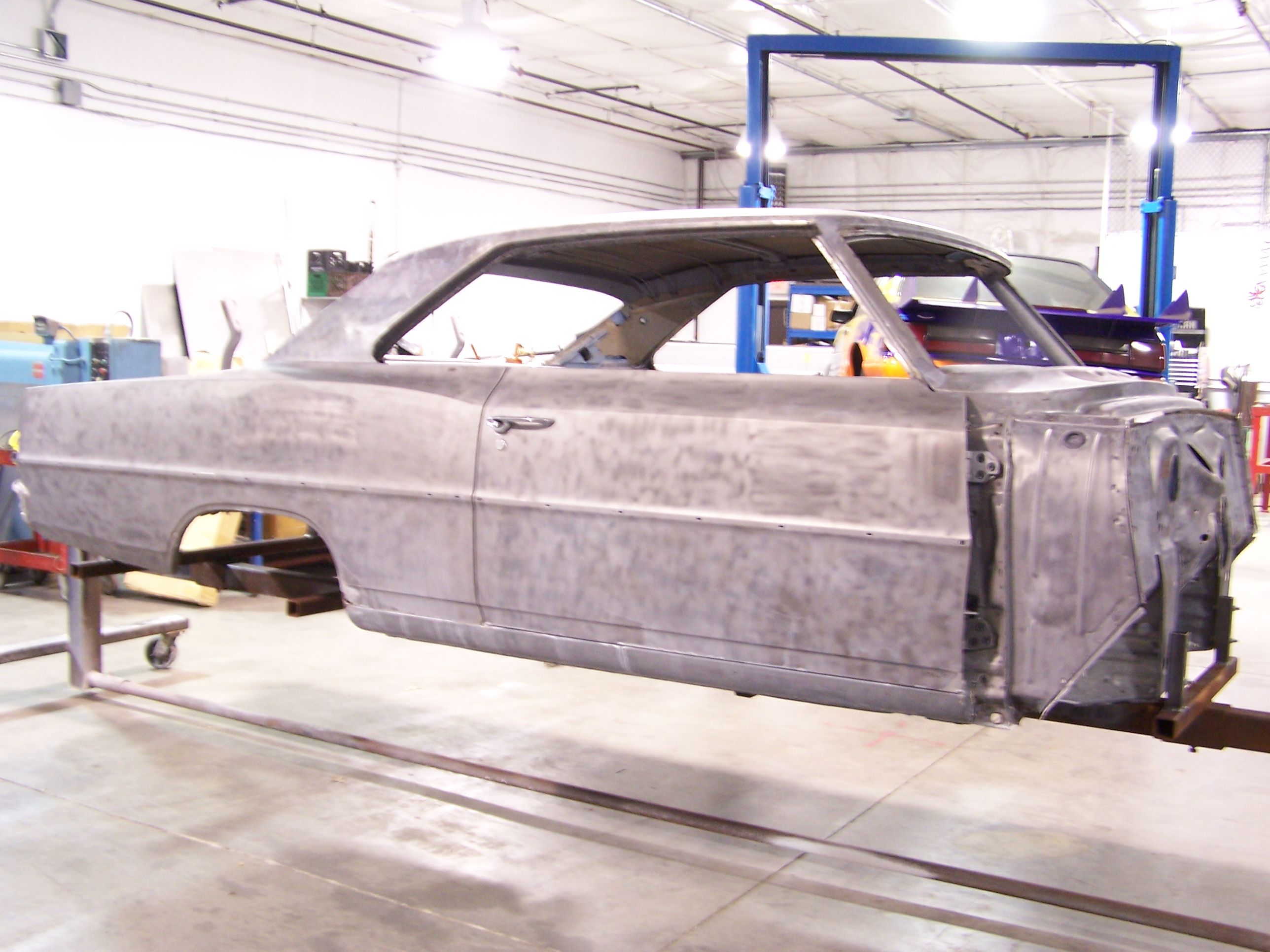

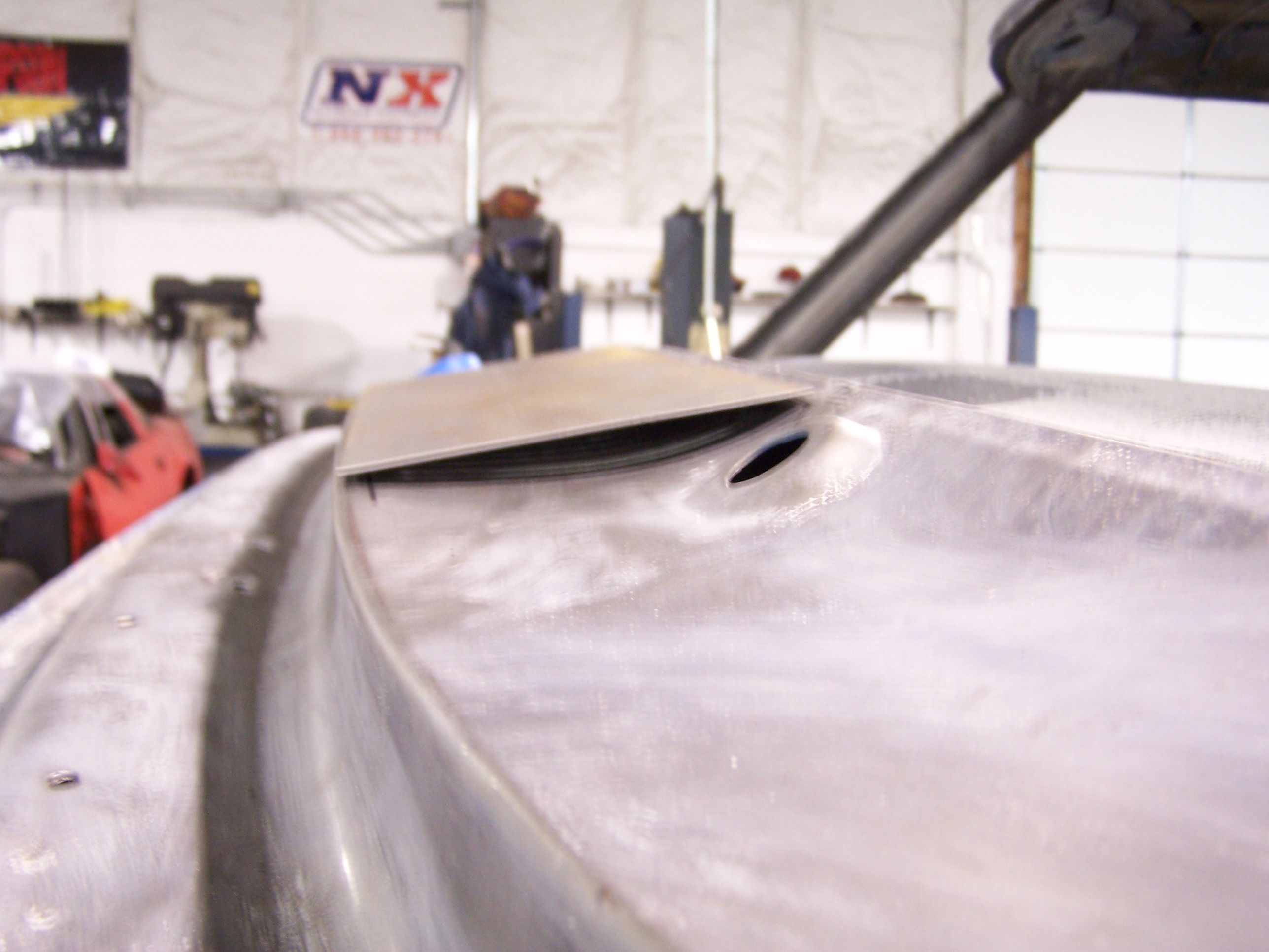

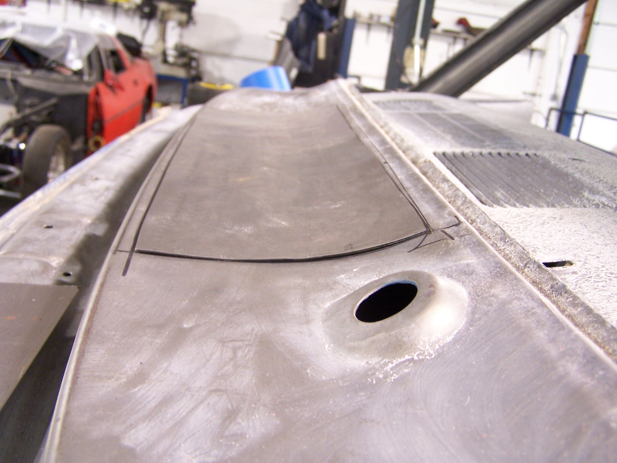

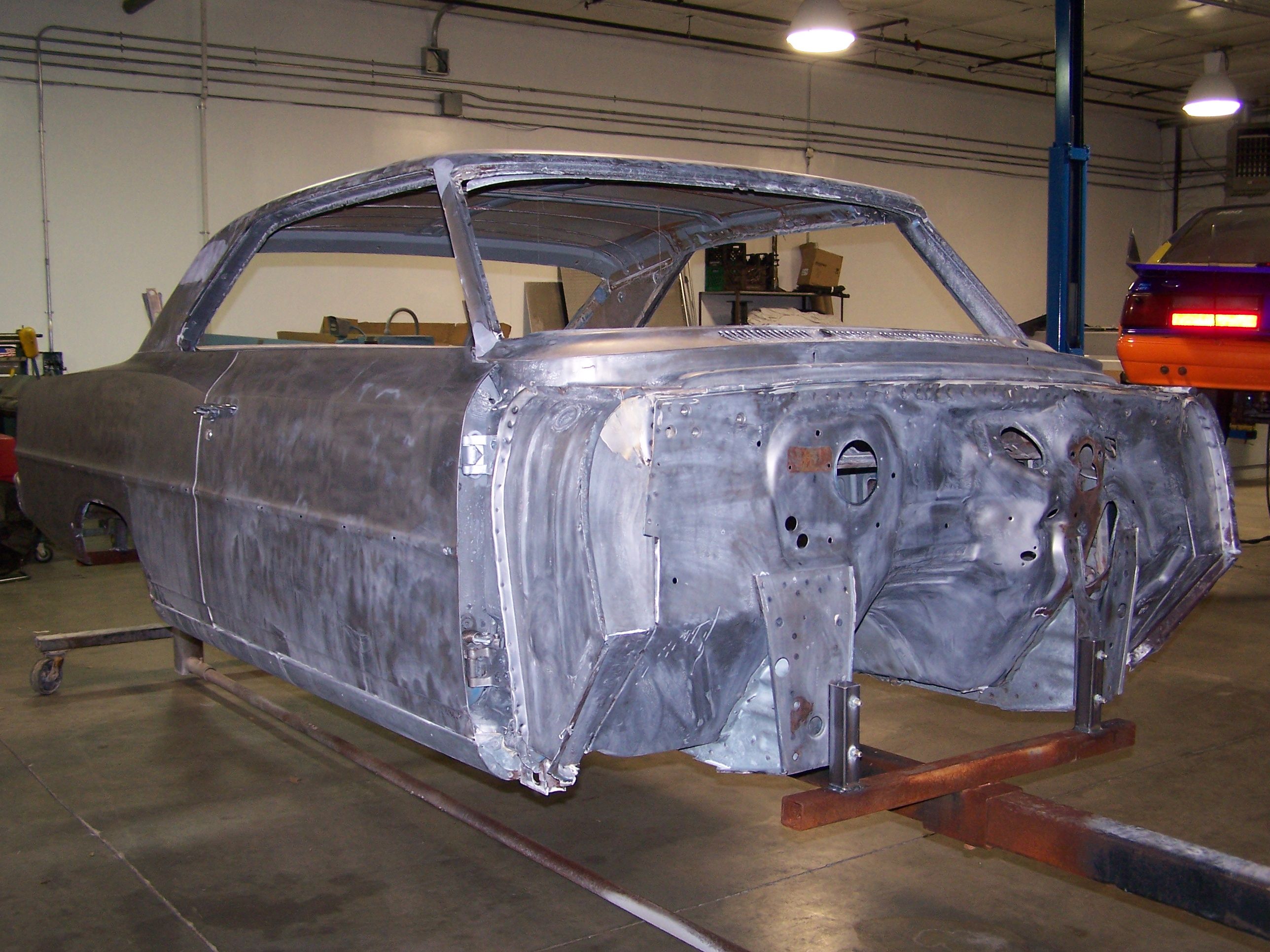

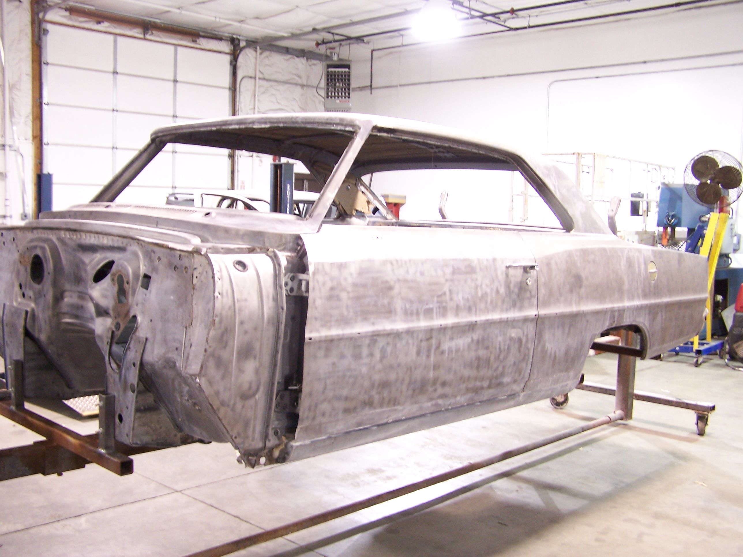

Here are some pictures of the bare shell taken all a part and put on a rotisserie. I used a local guy that had a mobile soda blasted unit that came out to a parking lot and blasted it. It was a really cool process to watch. The process was very messy but did a great job and didn't hurt a panel. Check it out.
Before
Soda Blasting Trailer. Nice and compact
Strating the process

Another really cool part about Soda Blasting is it doesn't hurt the chrome. We did the handles just to show.
We did the whole inside includeing under the dash and all those hard to get spots that really were made easy with this.
