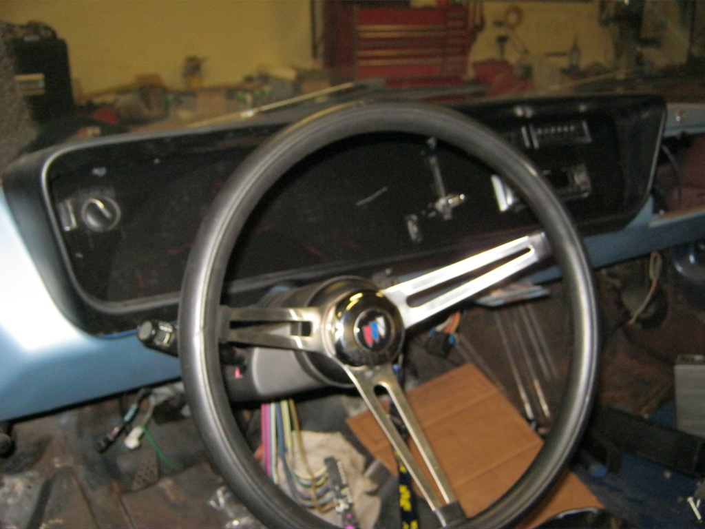

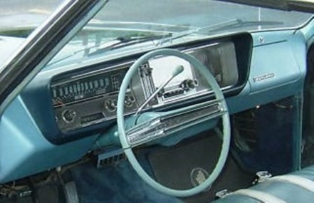

Here's a pic of the new dash set up with the Camaro cluster behind tint and the Camaro column with a Grant steering wheel. I also added a pic of the original. Not the best pics, sorry for that.
This look may not be for everyone but I like it.
