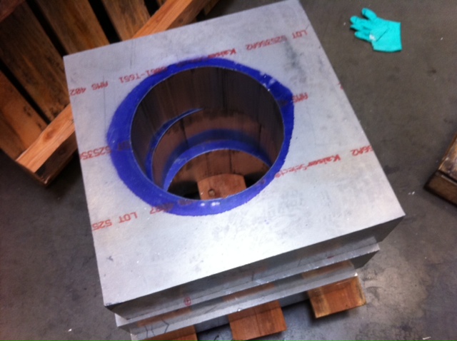

Or a chunk with a hole cut in it.

Charley,Did you drill those holes w/a craftman 1/2 18V drill.

Actually the hole is made by drilling a small hole , cutting a bandsaw blade, inserting it through the small hole then welding the blade back together.

So Charley, Have to ask what you needed the holes cut out for? I am curious!
