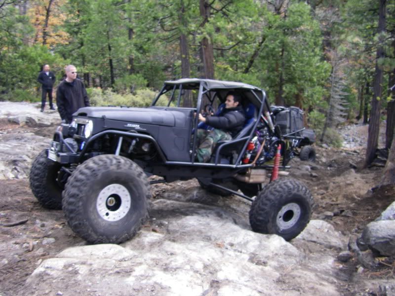

I used Kustom shop's hot rod black on a few rigs and on the buggy and they worked welll, but it was not an impressive paint, just cheap paint that I would re-shoot after rockcrawling and beating on the body. Easy rattle can or gun fix after a wash
