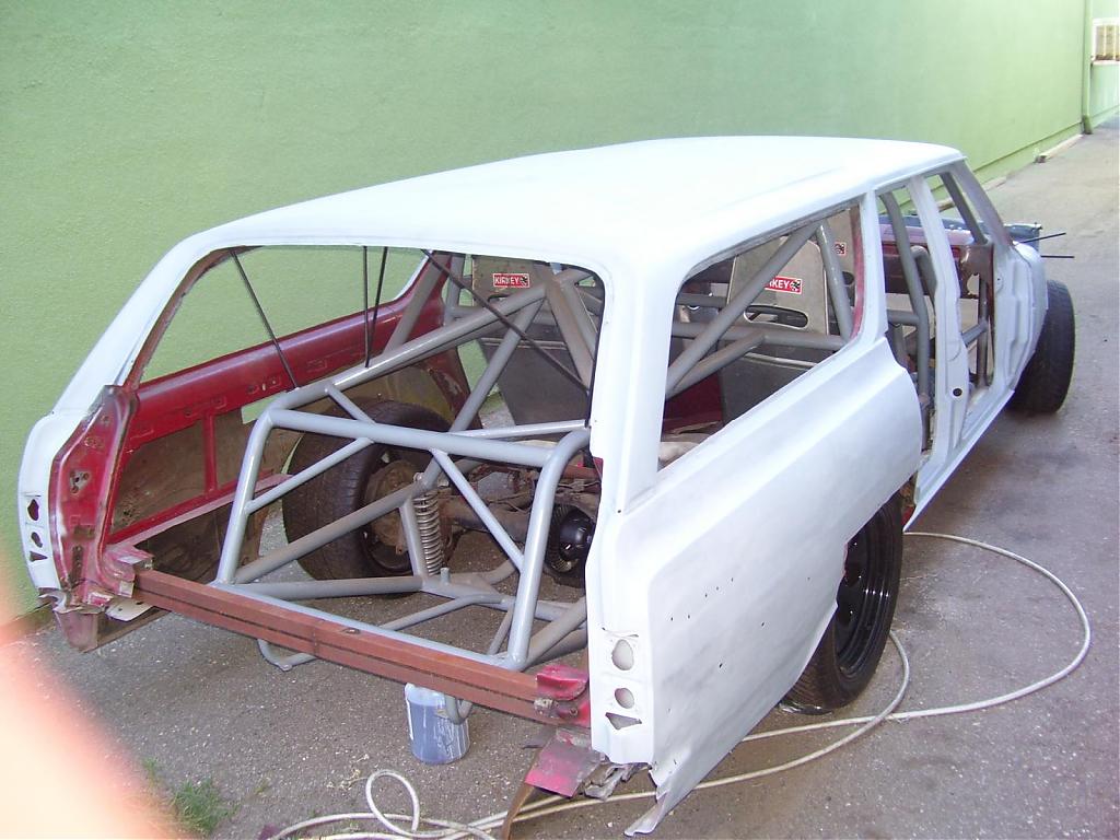

That frame is a well built piece wish I wouldnt of gone and done this to mine. What does one of those set you back without all the suspension attatched?

The rolling chassis price is 21k. That's complete front suspension with the flaming river billet rack and Ridetech coilovers. Complete rear suspension, with fab9 axle housing with 31 spline axles and rear coilovers. We don't offer a huge option list because there is no reason to upgrade beyond single or non adjustable shocks or maybe a guy whats a rear sway bar. We sell a good product from the get go.
Selling just the bare chassis does not make much sense since the only thing OEM is the C6 upper control arm, and we are thinking of changing that. The rear suspension is all custom made stuff and the lower control arm in the front is custom to be able to lower the rack to clear the engine position needed in a Chevelle.
