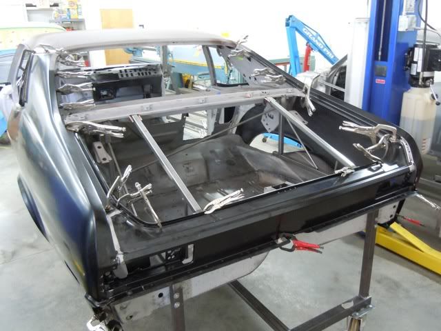

Dan's still plugging away at it. Here are a few recent updates. The quarter removal has started. The trunk pan has been fit and this pic also shows all the bracing that Dan did to ensure things don't move around.
It's gonna be a huge relief to have this part of the rebuild done and done right by a pro. I've learned a lot just talking to Dan and examining the pictures to see how he approached different things. Maybe in my next life I'll tackle more of this part myself
John

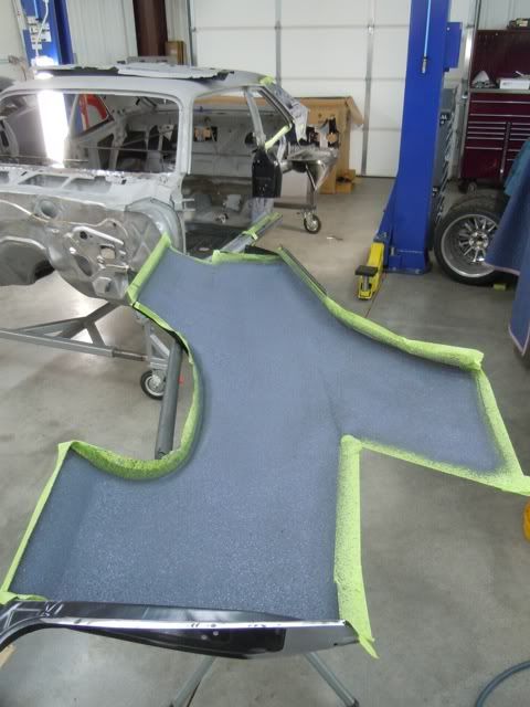

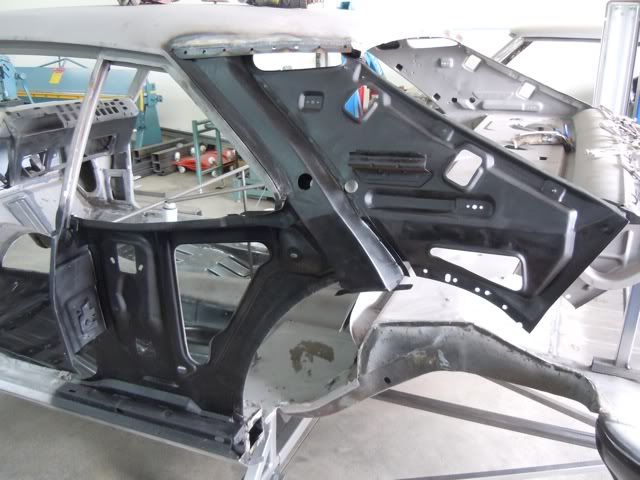

As promised new pics were delivered . Quarter and tail panel fitment is progressing. Dan asked that I ship him the taillight assemblies since the 3 panels come together in the rear in a way that could impact taillight fit. While those were in route he went ahead and completed finish welding of floorpans, trunk pan, and started dash removal.
One thing Dan suggested that I thought was a good idea was to go ahead and apply the Lizard Skin Sound Control product to the inside of the quarter panels. Not something you can easily do later . These are repop panels anyway so this extra mass should help (somewhat) make up for the thinner material used I think. I like the texture of it from what I can see. I'm going to rethink using it other places instead of the mat products I originally planned for.
Another thing I enjoy seeing is every area that is exposed by the R&R process gets cleaned up and coated with paint. They didn't e-coat back in the day so this takes care of the surface rust that developed over the years. One of those things I know I'd take the time to do if I were doing it and it is really nice seeing it done without having to ask for it explicitly.
