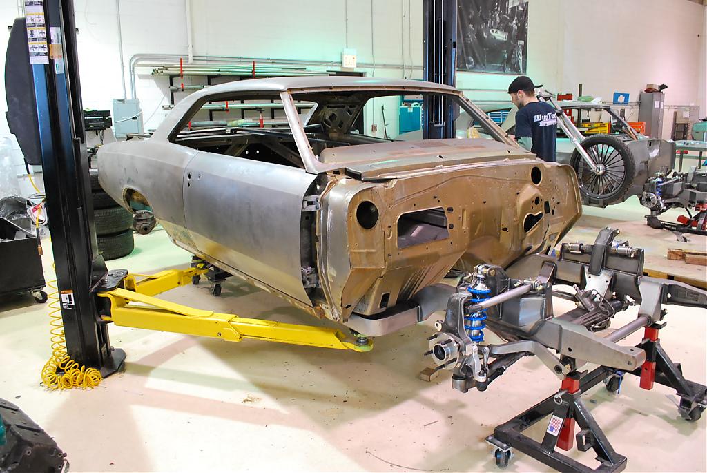

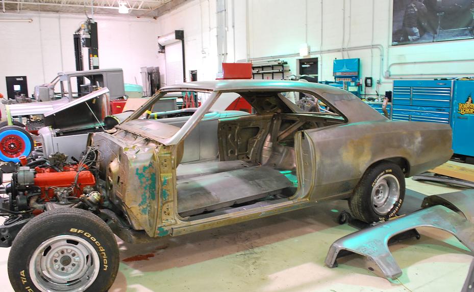

Been making some more headway on the '66. The car has been disassembled and is out to be stripped.

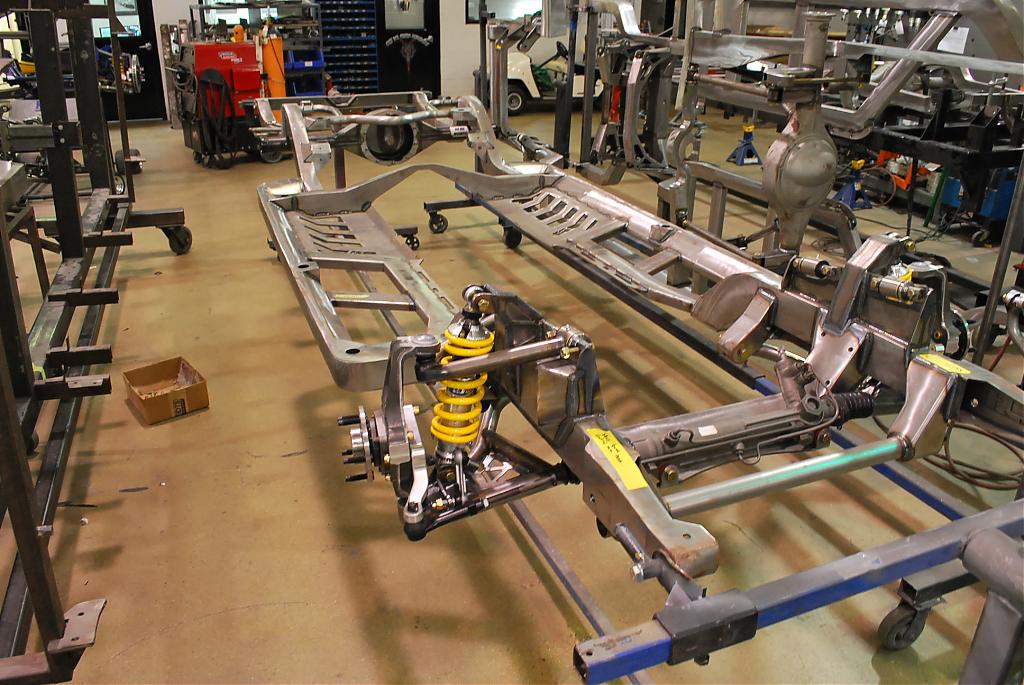

We have been going ahead on the chassis in the mean time and have that just about wrapped up.
Completed frame out of the jig and put on a rotisserie to be assembled.

how much ground clearance did you gain with the new version of the inner structure vs the old round tube? does anything hang below the bottom of the frame rails?
looks really good!

Beautiful welds.
looks really good!
Thanks, There was maybe 1/2" to 3/4" of ground clearance picked up with the new crossmember design. (not really our main goal, but we did pick up something) The frame rail is the lowest point on the car with the exception of the plate section of the crossmember, which is about 1/2" below the frame rail. The main reason for the crossmember design was to get the chassis tighter to the body and still have room for 3" exhaust to be tucked between the two.

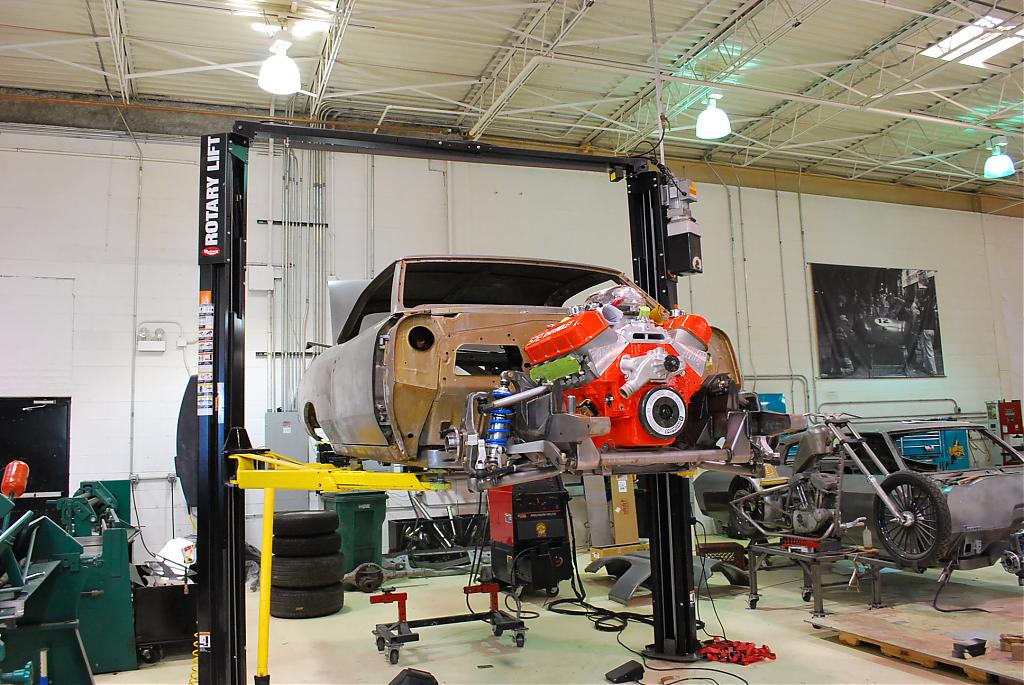

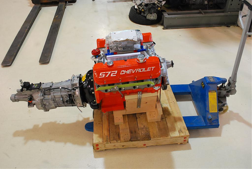

Just wanted to post some updates on car. Phil and Roadster Shop have been doing a great job so far. Also got the engine and tranny done.
