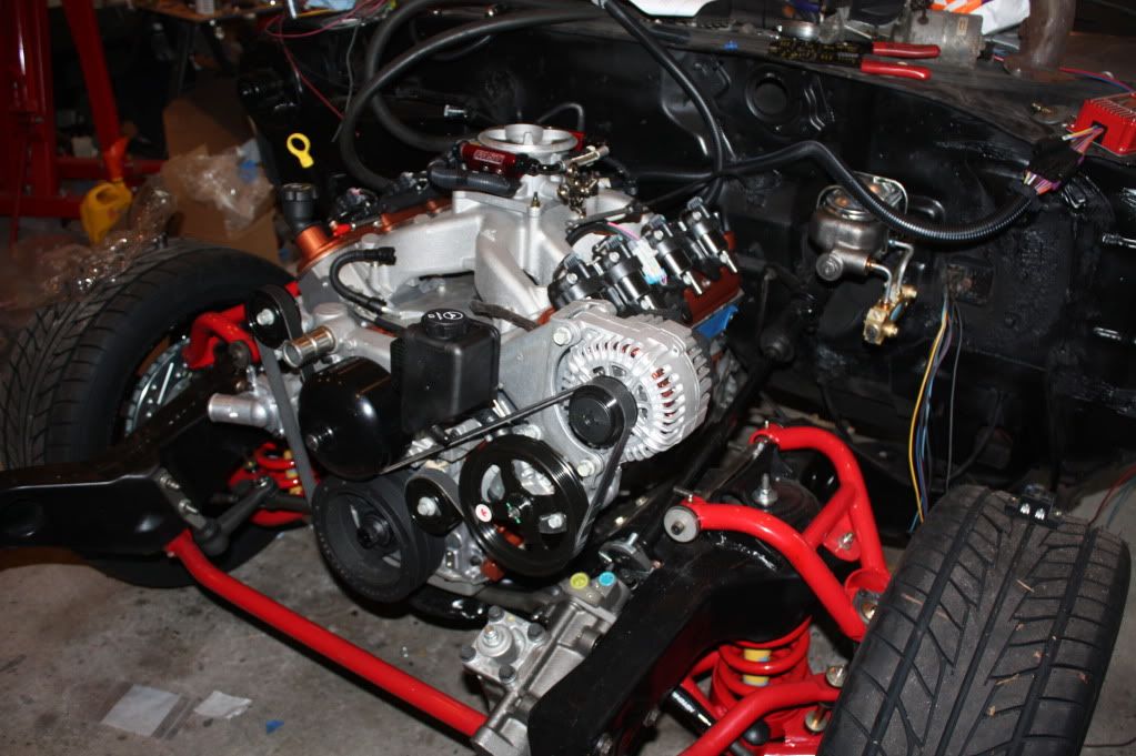

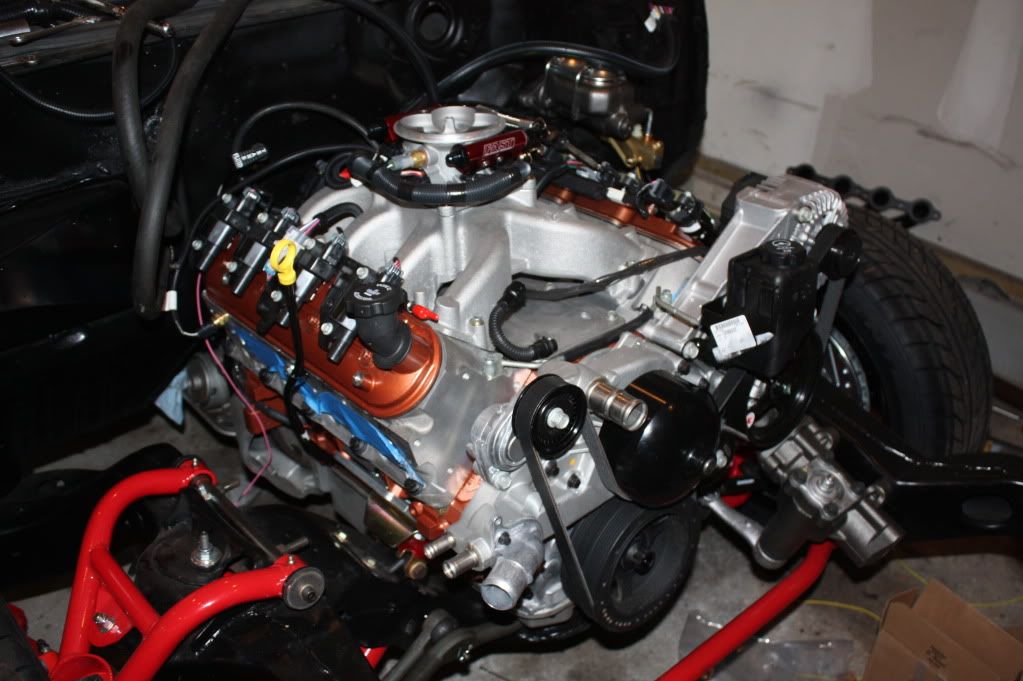

Been a while since an update....should have more for this coming week. Finally got a Corvette Accessory Drive form a company called Nook and Tranny...they are an Ebay vendor and were VERY helpful...pieced together the exact kit Pace Performance was offering (but NEVER delivered) at a competitive price.
Anyways, I have been doing a lot of wiring and will be doing some body work as well in the next few weeks. Hope to have her running within a month...trying to keep my credit cards in check...
I changed the valve covers to stock LS3 style ones so that I could clear the drive and I could paint them W30 bronze...gives it a stealthier look.
Here's some shots of the accessory drive installed.
I also recently acquired a 2.5" X pipe system from Magnaflow that should look and sound awesome.
More pics to come shortly!
Dave

Looks good. It is hard to tell from the angle but does it look like the power steering line in going to fit? I had to run a smaller pulley on the vette acces. to clear.
It will fit, not going to be the prettiest route to get there so I may actually have a bent hardline for a large portion of it with just a small section of flex to force it in the direction I need.
