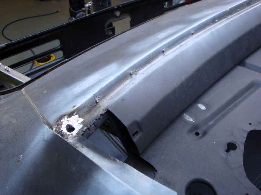

I had a few hours today to work on the car, so I finished up my top half of the driveshaft safety hoop, and worked on my gas tank access door a bit.
I still need to get some hinges and a latch/ fastener for keeping it closed.

The top part of the driveshaft loop came our great. The access panel will save a lot of work if you need to get to the sending unit later on. Nice.

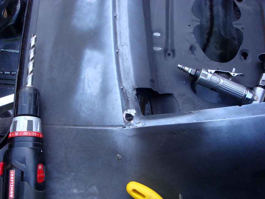

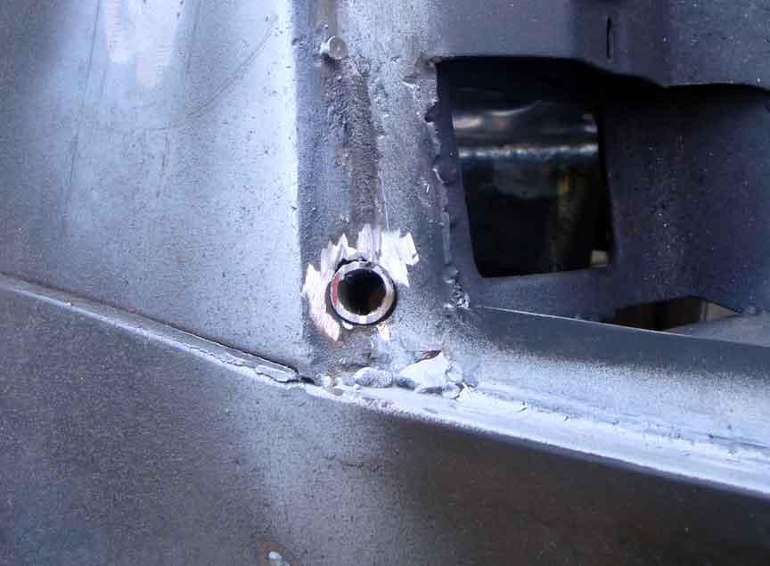

This afternoon I completed a couple of small projects. I welded in the inner seat belt brackets to the trans tunnel. I also built some drainage tubes for the rear window channel. As we all know these first gens like to collect water at the base of the rear windows so I added some drainage tubes to the corners to allow water to drip through. I'll attach rubber tubes to these and have them exit through the wheel wells (when installed)

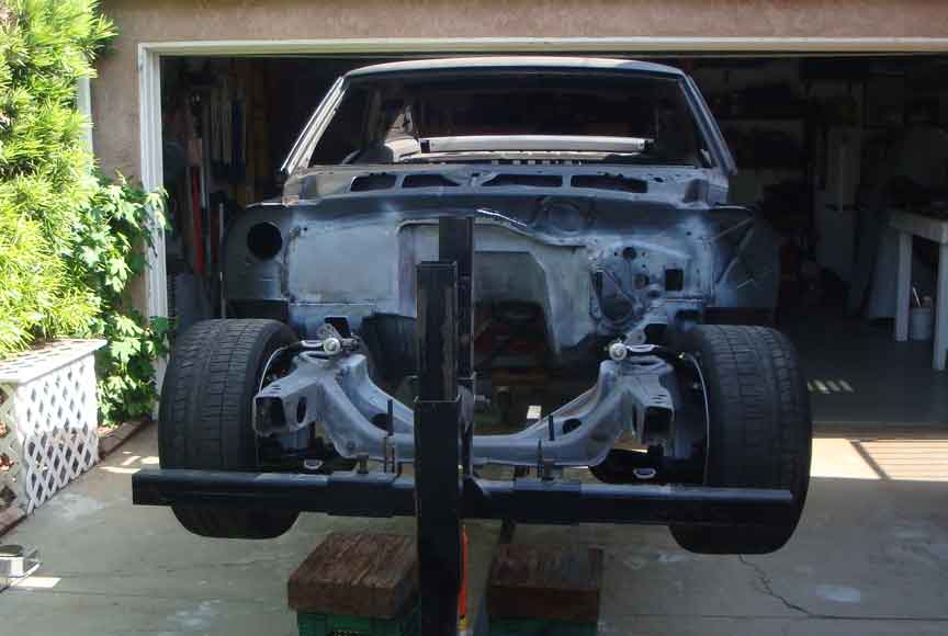

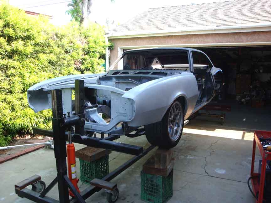

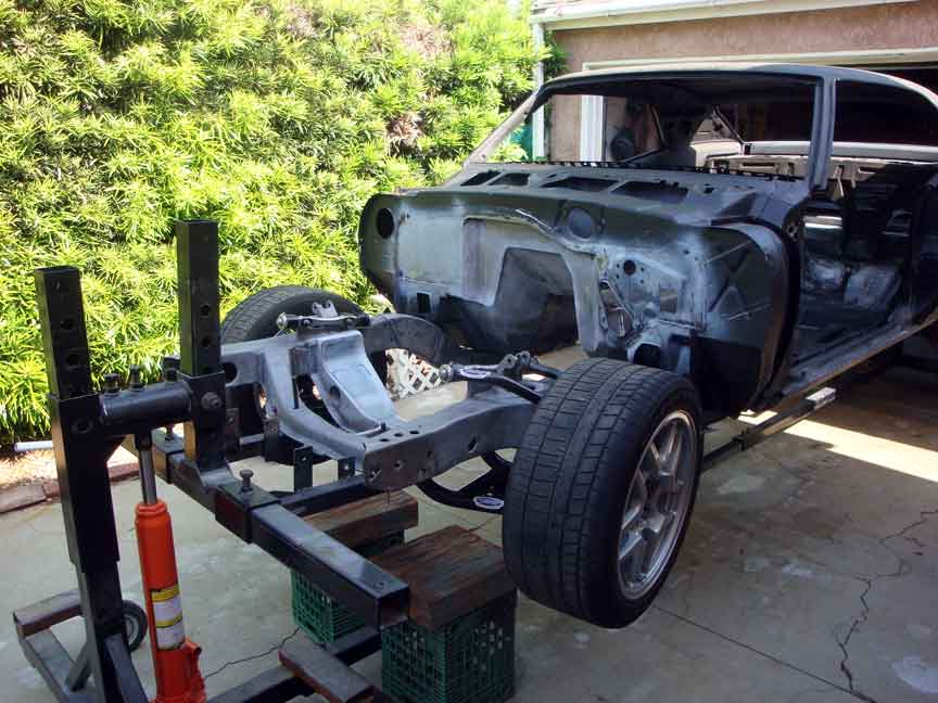

I had a couple of hours today so I borrowed my old wheels from my neighbor, Brett, to see how they would fit on my car. Well, they didn't. It's a good thing I am planning to use a different wheel. I was thinking about the American Racing 200s wheel (17x9.5 front) and (17x11 rear). I like the retro look, but I need to talk to someone who knows about these wheels. If they're crap or won't clear the brakes I want then I'll need to keep looking. But this was a good lesson to see and determine the sizes that will fit and what modifications I'll need to do to make these work. I knew that I would need to modify/ rebuild the inner fenders but it looks like I'll be notching the frame rails, too. Hope to get to that next weekend...

BTW- those pics I posted today are the incorrect offset. The wheels would barely turn like that. I had to space them out a good 2" or so. They also tuck in way too far, imo.
